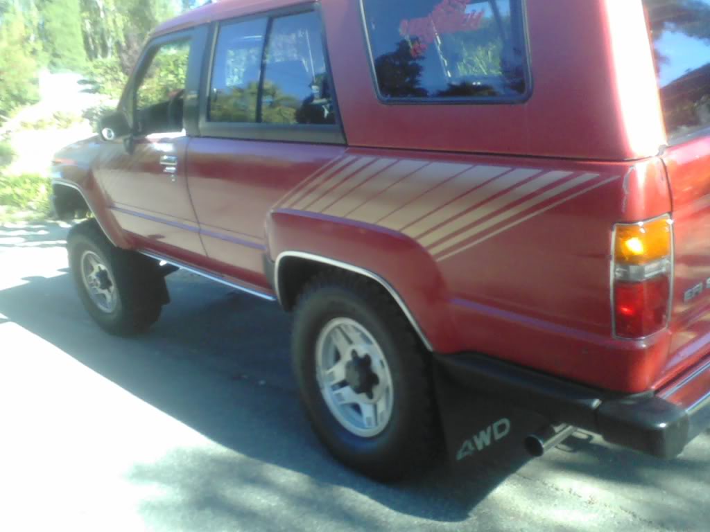

It looks like it's secured enough so that it won't go nowhere. How much lift did they give? The lower fit over the rubber snubbers could cause an issue farther down the road. Certainly is good for the testing you're doing though.
And if you could measure the outside diameter it would be appreciated....5"?
#106
I put the blazeland kit up front, so that lifted it 2/3" and i put some shackels in the rear 7" from bolt to bolt and its about level maybe 1/2" more in the rear.
outside dia is 4.5"
the leafs were on the overloads before the coil springs. I think the shocks are limiting the drop limit, gonna chk it out today.

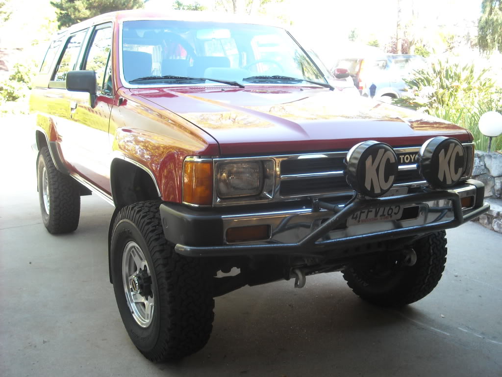

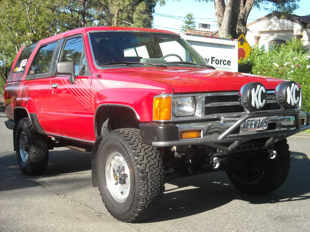

Hey Philbert! Hope you're well, buddy!
Just a couple pics for reference..... 600# in the very rear for my trip to Havasu(some in the back seats as well, but not much)...... 12"x125# coils on what was OVER FLAT spring pack and riding on the bump stops... with all the weight and on a hill in both pics, ....maybeeeeee dropped .5-.75",.......600#..... LOVE the Zuks, especially when I need em, ya know? Pics, both loaded with the 600#(plus, actually, just being fair)>>>>>>>>

RIGHT ON, PHIL! Great to hear from ya..... was wondering if you'd taken a leave from Yotatech for a bit or something, lol. I have had to lately, just so busy! lol.
Hey Stag,.... thanks, man! Means a lot....it's all been worth it. Far as the shocks, I did NOT replace mine....but then, I started with shocks for a 4" lifted Pick up(my buddy gave these to me, they're Rancho RS5000's....... LILLLLLLLLLLL stiff, to say the least). I think they also are different in extended/compressed from what I need, but bottom line, they're long enough to make up for the added lift with the Zuk.
Like I said, I'm LOADED, and I mean heavy....and it's just barely compressing these springs! Plus, the ride, with a lil weight, is even nicer(at least on the 12"x125#'ers)

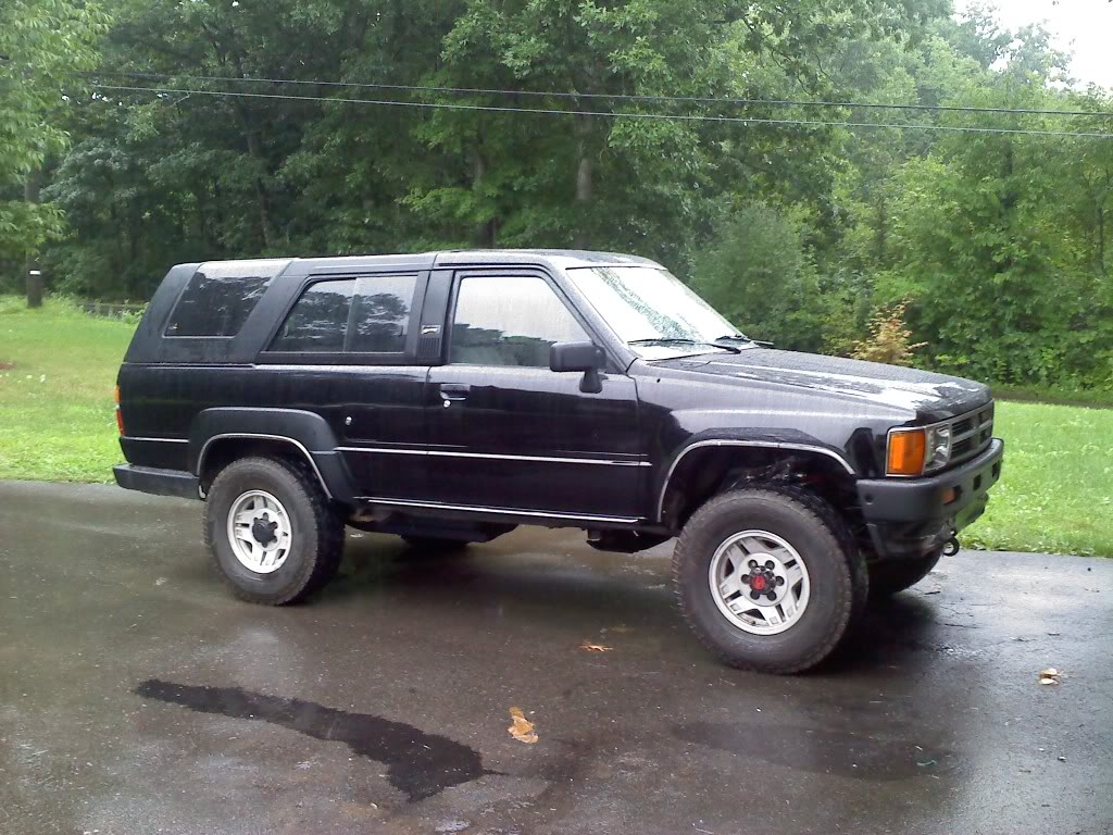

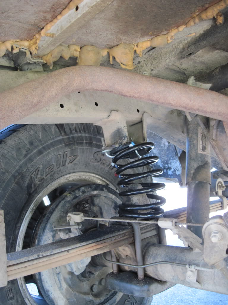

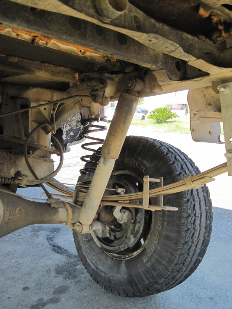

My mod is nearly done.
For those who sub'd to my thread, please let me know if you're still getting updates via email? I seem to be the only one posting to it lately, that's atypical. Maybe I'm just ultra-boring?
Here's the before - stock height, no mod. There was about 2" between the rear bumpstops. I had a pic, but... details in the link.
Here's the after - Blazeland long travel (appx 3" lift) and 14", 125# springs
The ride is awesome all around. It's a new truck.
Speed humps that caused a bang and a ruckus now are hardly noticeable at 12-14mph more, even with a load of crap in the back (33" spare, axles, couple cases of water, tools, and more junk) .
The rear tops out when going fast enough, it's going to need longer shackles to resolve that.
Here's the 'Zuk post of my buildup thread:
https://www.yotatech.com/forums/f116...l#post51769934
I almost scored a set of AllPro 5" leafs for $150, but I just missed them so I ended up still installing these.
It's a great mod. The price point makes it even more awesome!!

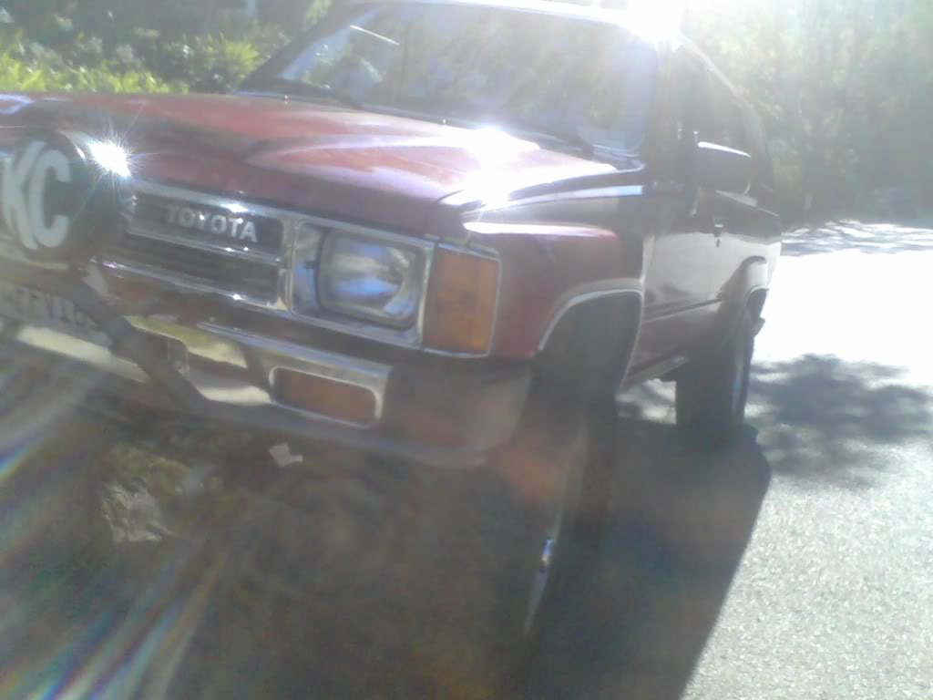

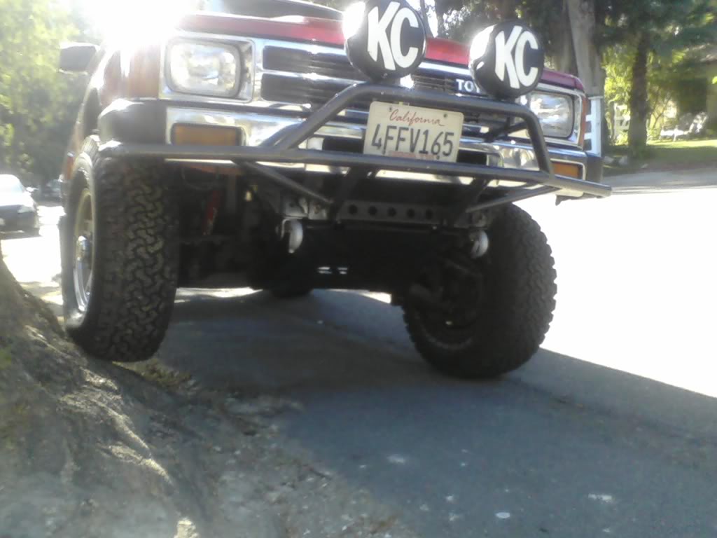

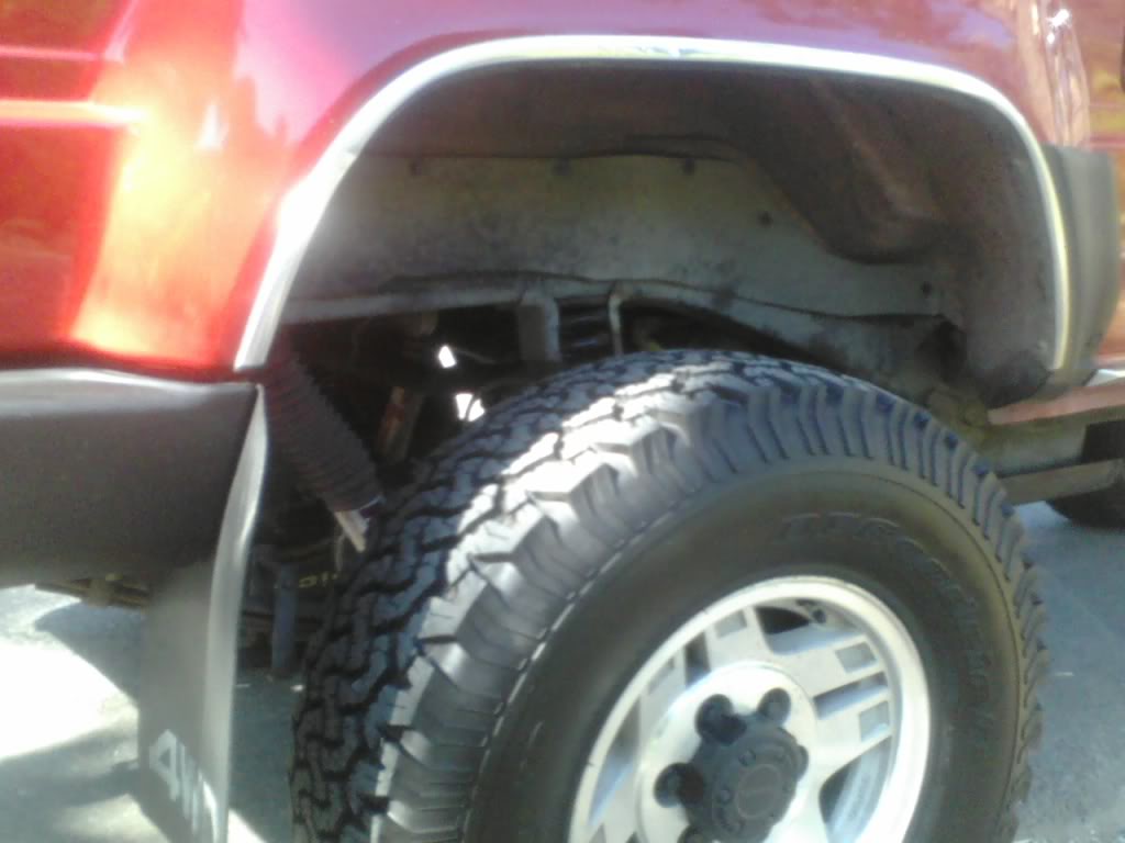

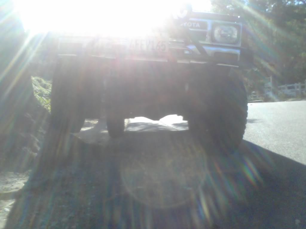

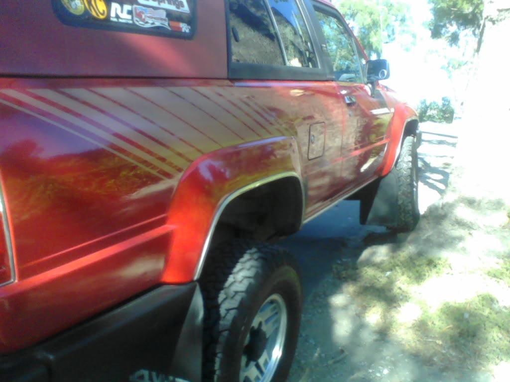

Hey Phil! Sup brotha!?!?!?

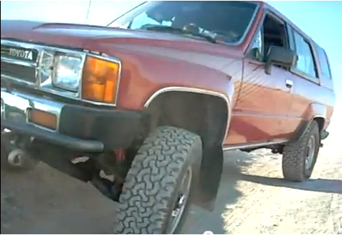

Got some shots while wheeling in Havasu.... think I already posted em in my build, Zuk Thread, etc. Not here yet... But since I got some today, testing a lil flex on a big tree root, shot with my cell... I thought I'd torture everyone with the terrible pic quality!
hahaha.
Here is the ones while wheeling in Havasu, AZ....
Up, up and over>>>
All of this made possible, in part by this mod!(not to deny the importance of the new gears and rear locker, but you get my point! lol. I'd have bottomed out ALL OVER!)
Now, these were today, just to show, not even fully stuffed on the driver side/flexing droop on the passenger side.... they STILL are clearly working, not becoming dangerous(about to drop out the tower, etc.)... and, well, they are DOING they're job! The other couple pics are not even close to the limits of front end stuffs, but showing, clearly, that the Mega Travel Ball Joints, BJ spacer lift/suspension restore has worked wonders... Before, I couldn't get near there without getting the front driver side tire off the ground... now most of it is on the ground, even with 8" Up from level on the passenger side, at least. Like I said, could have stuffed more, but ran out of tree! .... and time, of course! lol. Some pics>>>
Just my Humble Opinion... THESE ARE A GREAT SOLUTION TO SAG! Secondly, you can see, they don't stop all practical wheeling/applications! PLUS, .....the loads I can carry without bottoming out is astounding!!!!
BTW, these are the 12"x125# with 1.5" 4Crawler BJ spacer lift and Downey Mega Travel Upper BJ's, New, as well as New OEM Lower BJ's, new CA bushings, and some shocks a great guy GAVE me(yotatech homie and now homie in general! lol Anthony1 on here).
hahaha. Here is the ones while wheeling in Havasu, AZ....
Up, up and over>>>
