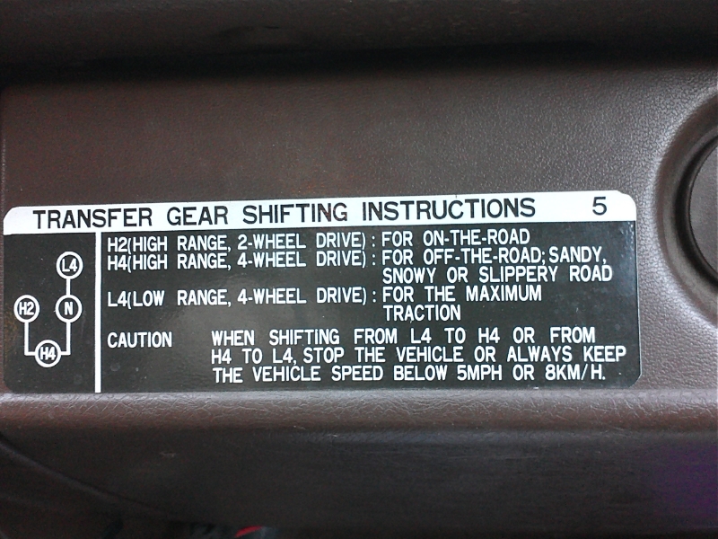

here's a pic of the T-case shift pattern:

Where would I look on the tranny to see what the model is so I make sure to have the right pattern?

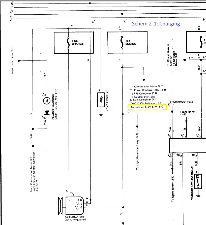

Here's schematic that shows that back-up lights get power... from Engine Fuse
Check for voltage at connector and back-up switch, and back up lights themselves.
Yes, retarded design- it combines critical circuits (that could keep truck from running properly (i.e., alternator & ECU), with non-critical circuits that are merely indicators and when down would not keep truck from running (i.e., back-up light, dash combination meters).
Check the other circuits that connect to Engine Fuse and see if they all work.
This post that shows how poorly managed wiring above is, also shows location of back-up switch.
