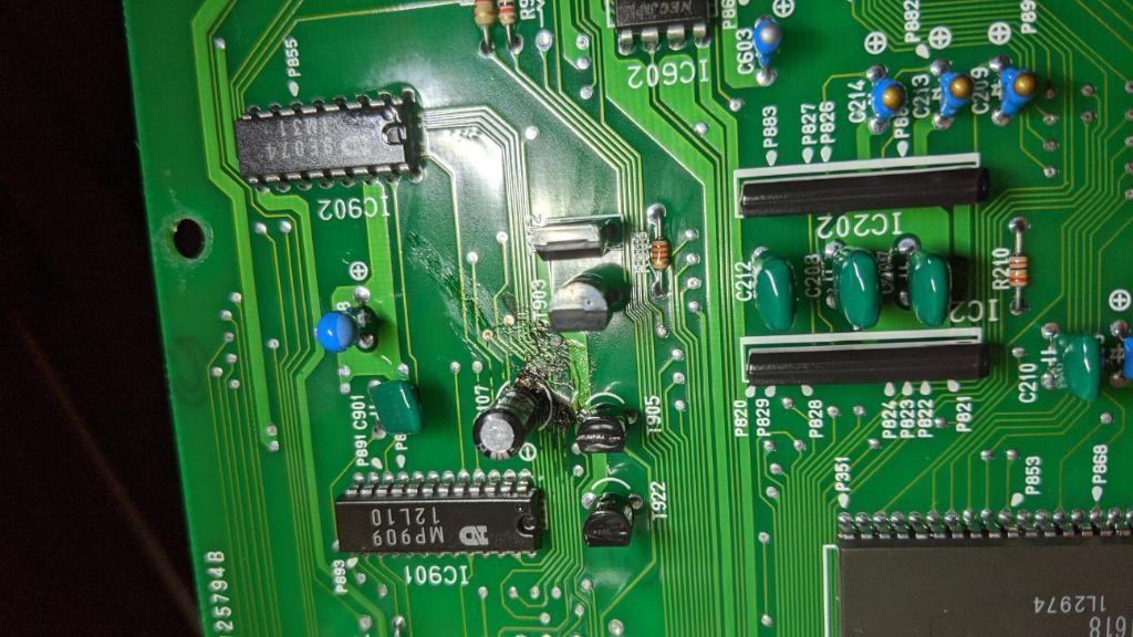

Spoke to my mechanic. He took the ECU out and took it apart. Looking at the board he noticed one of the capacitors was melted off onto the circuit board and said this is the problem. Pictured attached:
I also noticed when shorting the E1 and TE1 terminals the check engine light does not flash repeatedly like it’s supposed to. I have tried wiggling it with different sized paper clips and it doesn’t help.
a new computer cost $450 from flagship one. I have searched throughout the internet and could not find a cheaper one.

That capacitor has clearly puked its guts. But capacitors don't cost much, and you can probably still read the value. Repairing circuit boards takes a little bit of talent, but not $450 worth. What have you got to lose?
(Check the other capacitors while you're at it. If any of them even look "bulged," consider replacing them at the same time.)
