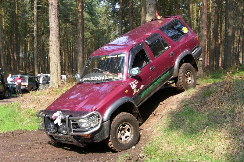

on the rear im running HDJ80 landcruiser springs and +4 pro comp ES 3000 shocks, no sway bars.
pops its wheels like a good un

front end... that sucks
rear is plus 3 inches and front is plus 2 inches.
heres a side pic
getting long travel out of the front IFS is going to be a solid axle swap.
