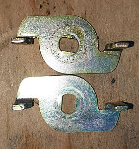

Yeah just watch out for the TPS. You have to use the 87 TPS with the 87 ECU.
Swap the butterfly from your 87 TB over to the 90 and your 87 TPS will work without a hitch on the 90 TB.
Here's the piece you have to swap
EDIT: forgot to add, use threadlock on the nut that holds that thing on.

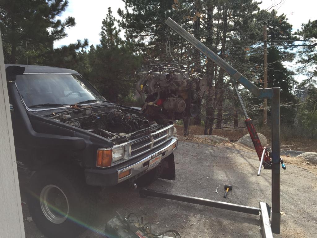

Sorry it's been so long, the last two weeks I have been doing written and skills finals for my EMT so I've been really preoccupied. Yester I finished the intake swap, I still have one mystery vacuum line but I downloaded printed some vaccum diagrams so hopefully I can figure it out.
On other threads I have read that the reason for swapping the old tps into the newer tb was that the connectors changed with the years. Well my 87 harness has the exact same 4 prong connector as the 90 tps, so I'm going to do a little test run and see if it works(I'm sure I'll just have to use the 87 tps but the 90 just looks way nicer so I imagine it is less sticky inside)
I'm going to rent the hoist again in a couple hours and then I need to put my new pilot bearing in, reattach my clutch and flywheel and finally get to set the new motor in.
Then it's just all the little crap like radiator etc.
The 4Runner should be back on the trails in no time!
She lives!!!!!!!!
Finally started up the new motor and it runs great!!! Less of that 22re tick than my last motor even. Had a good scare with the smoke that was bellowing out of the exhaust for the first 20 minutes but then I remembered some coolant and power steering fluid got in there during the swap. I don't really notice a power difference with the late model intake manifold but Its been months since I've driven it, and I've been driving a v8 5spd mustang for the time being, so that makes sense. I didn't have to adjust a single thing, just a complete plug and play swap.
I had to swap out some sensors that had different connectors, and for some reason the lower 3 threaded holes on the motor(bell housing-engine) had no threads! I'm not sure if someone drilled them out or if the 1990 model just didn't have them to begin with, so I tossed in 3, 3/8", #8 through bolts with lock washers and they fit great. They were 2" long incase anyone else runs into the same problem.
And the 1990 TPS works great with my 1987 ecu. The connector was the same so I figured I'd try it out and it works fine. Started it up in the snow after it sat for months and it fired right up and idles great. So if your connector is the same, no need to swap sensors, although I'm sure it's a good idea to clean it using the steps jennygirl posted.
Had to tighten a few bolts to stop some leaks, and now I'm wishing I replaced every copper compression washer on the fuel system but that's something I can do later, the small metal tube going from the fuel rail to the cold start injector has such a small leak it doesn't drip but just always look damp. And the main fuel line to fuel filter banjo fitting has a very small drip. Nothing that stopped me from driving it to work today though(fire extinguisher on board)! I will pick up some new compression washers after work and kill the small leaks.
Oh and to everyone who has a leaking hot water pipe(wraps around the back of the head and connects to the bottom of the lower intake with 2 weak ass bolts) just get an o-ring, mine had the copper compression washer and that's why I snapped a bolt before, you barely have to put any torque on the oring for it to completely seal.
I tried to post some pics of the runner but sometimes I think I might be the least tech savy 24yo on the Internet, so those will come once I figure it out haha
Just wanted to say thanks to Jennygirl and uwabaseball for all the help along the way, you guys are awesome, if you live in SoCal we should meet up and go wheeling by my house(running springs), the manzanita flats-angelus oaks trail is pretty cool, nice and mellow but tons to look at, like the old hydro electric power plant and a giant sandstone cliff.
I'll try to get some pics up while I'm at work
