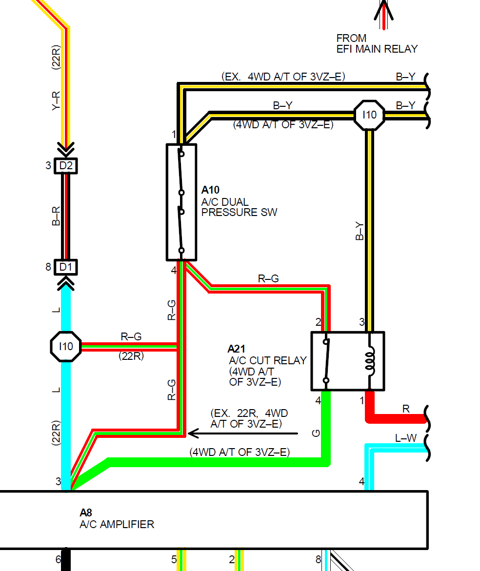

I've got my whole kit installed and waiting to charge the system but my installer can't find the pressure switch wire. He says maybe it's been cut out of the harness. It's the wire going to the high side which kicks the compressor on. Anyone know what color the wire is or where it might be found on a truck with no factory AC?

Why do you need a wire from the harness? Doesn't your kit have all new wiring? (I think the equivalent to the A/C Dual Pressure SW is called a Binary Safety Pressure Switch.) Did you put in all the wiring called for in the kit's instructions?
The Red-Green wire from the A/C Dual Pressure SW goes to the A/C Amplifier. You don't have either part.

Maybe I'm not translating correctly. He can't find the wire for the dual pressure switch. He found an orphan plug on top of motor near the temp sensor that he believes went to the original temperature sensor which was replaced with an aftermarket switch/gauge by previous owner. He thinks the wire for the DP switch is in that plug but doesn't know the color. He suspects that plug has an AC compressor cut off when temperature reaches a certain point. He's going by the Haines manual and a test light to find the correct terminal.

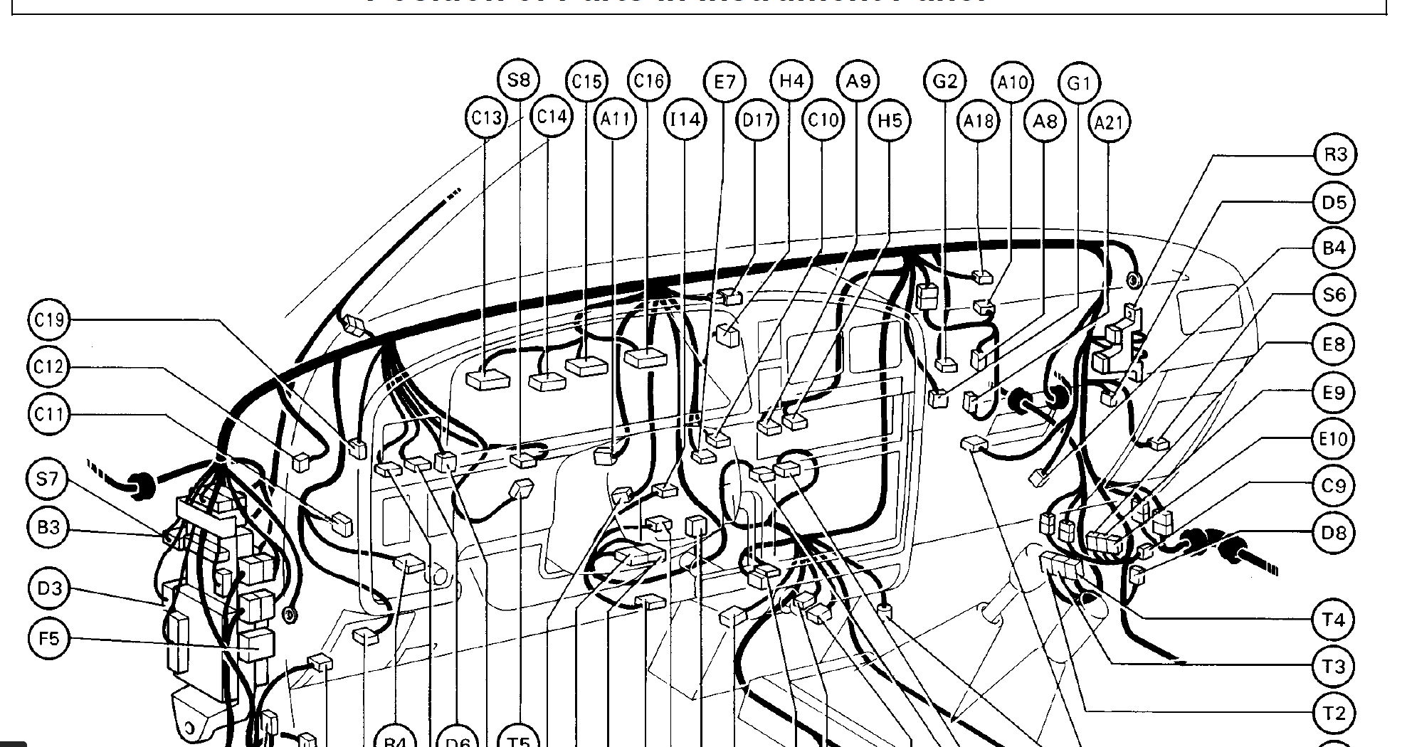

This is for a 1990, but likely the same wire colors. This of course is for trucks with factory AC.
For the location of the dual pressure switch (A10), check the diagram below, near top right corner it has A10 in a circle.

That's awesome! Thank you for the help.
