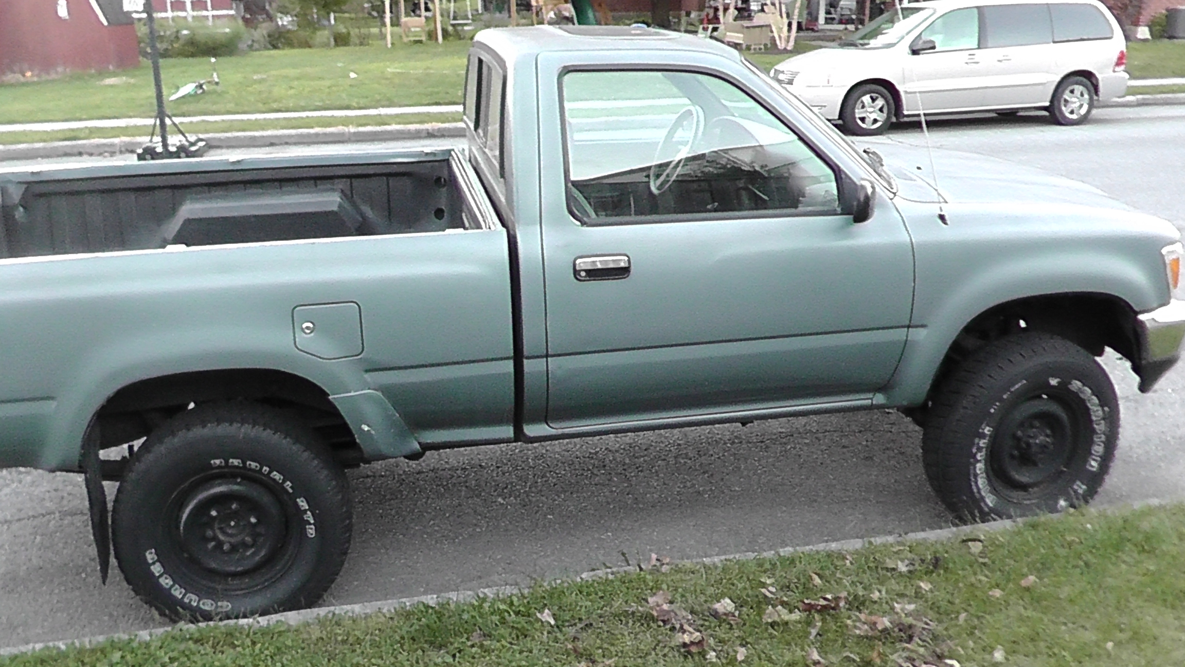

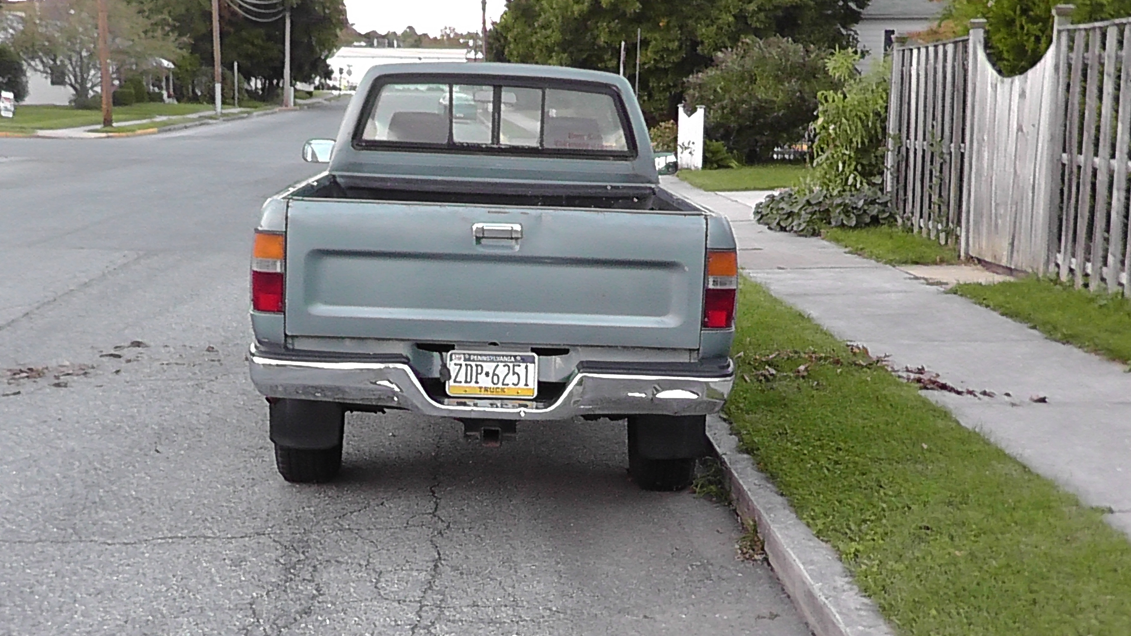

I attached some pics of it
Attached Thumbnails What are the weak spots on a 1989 4x4 Pickup?-bed.jpg   What are the weak spots on a 1989 4x4 Pickup?-back.jpg   What are the weak spots on a 1989 4x4 Pickup?-passenger-side.jpg

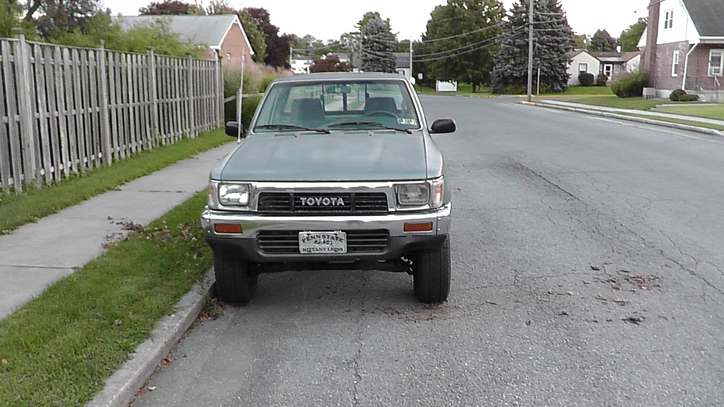

Here are a couple more. If there's interest, I have pictures of the under-carriage.
Attached Thumbnails What are the weak spots on a 1989 4x4 Pickup?-driver-side.jpg   What are the weak spots on a 1989 4x4 Pickup?-front.jpg
Old Nov 4, 2013 | 12:53 PM
85toy4runner's Avatar
Joined: Feb 2012
Posts: 223
that looks like a nice truck , I like that, and its got the 22re and 5speed , those sell fast with that combo
