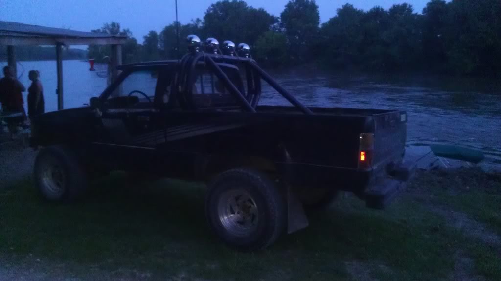

87 22r with 317k and 160k on motor, burns oil trans growls horrible in 3rd and 5th? but gets 23mpg and body is completely rust free as well as frame.

I put the visor and roll bar in other than that that's how I got her.
I'd say ur pretty lucky to find a rust free truck around here. I'm pretty fond of those graphics too. My mom had an 88 4runner and my brother had an 88 pickup that both had those same graphics. And now u have a parts truck for this one lol. Have u checked to make sure the trans has oil?
