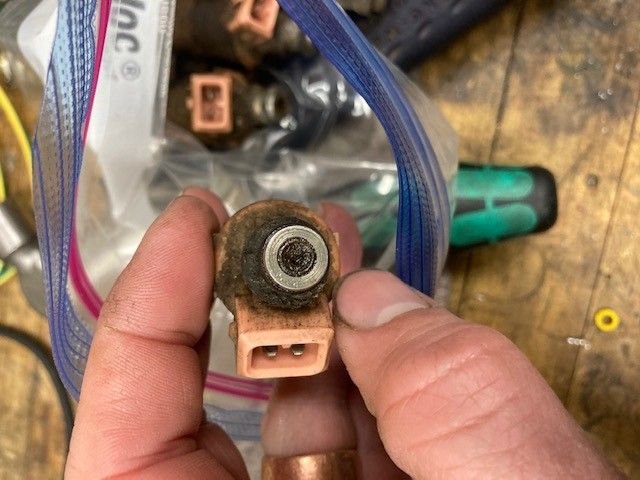

Well I finally figured it out (I think) I pulled all of the injectors and found cylinder 3 completely plugged with debris and cylinder 4 partially plugged I also found the fuel log to be half full of debris. Who are you guys sending your injectors to for rebuild? I am going to send all 4 and the cold start, not sure what is going on but the intake runners were completely full of fuel and the truck has not run in at least 4 months maybe a partially stuck open cold start injector?

I am here to report back, the clogged injector was the problem, truck runs like new. I have not swapped the tank out but it is full of water, I took the pump out and put it in a 5 gallon bucket and flushed all the lines truck started right up and runs perfect. As for my experience with 22re performance I am still on the fence, they are very knowledgeable about our trucks and these motors, however they were almost twice the price and they did not paint or really clean up the injectors (externally) and they did not give me any flow reports, I also have one that is leaking a little and I do not think it is anything I did.
