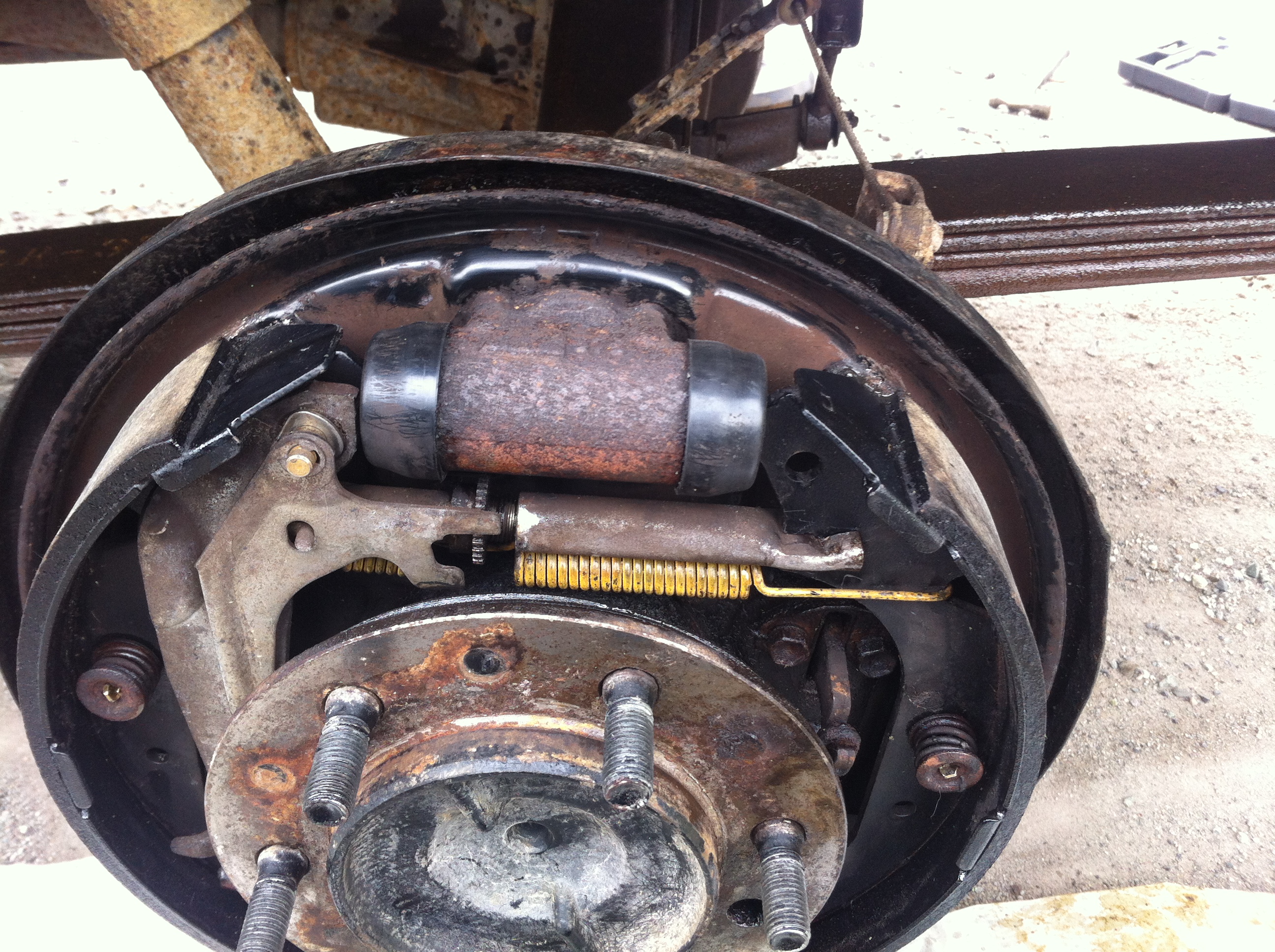

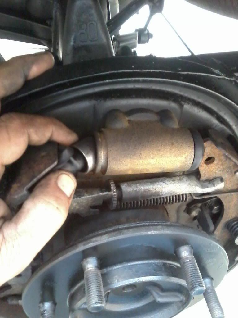

Hello everyone.
I have some trouble with my truck brakes. Cleaning the truck I noticed that the rear drum, driver side was dirty because of an oil leak.
I opened the drum and there was oil everywhere. I tried to apply the brake and see if there was a leak somewhere but it was hard to find. I think is the wheel cylinder because today when I cleaned with the brake cleaner I saw few drops of oil coming from the right side of the wheel cylinder. My first doubt was that the oil was gear fluid but the seal between the axle and the brake seems to be fine: that area is clean, no oil. Is it possible that the gear fluid is leaking from somewhere else? Is there only one seal for the gear fluid?
The other thing is that the brake light in the dash is on plus the oil in the reservoir was low when i bought the truck.
Attached 2 photos to try to clear a bit more the situation.
Thanks for your help.
Attached Thumbnails 1987 4 runner brake issue-img_6717.jpg   1987 4 runner brake issue-img_6718.jpg

Are you sure it's gear oil? If you have a leaking wheel cylinder, it will sling all over brake housing. If the brake fluid is dirty to begin with, once you mix it with the dirt in the brake it could look like oil.
Since it's almost certain that the wheel cylinder needs replacement, you could do that, put it back together, and check the axle-seal again after 100 miles or so. A wheel cylinder is $4-$15 at Rockauto.

Brake fluid and gear oil smell nothing alike!!
From your picture your wheel cylinder is leaking and should be replaced.
Brakes what you do to one side should be done to both!!

Doesn't your photograph show fluid under the rubber boot on the wheel cylinder? Didn't you actually SEE a leak? It should be dry under the boot; your wheel cylinder is leaking. (You can buy seal kits for wheel cylinders, but at $4-$15 to buy one already re-manufactured, I don't see how anyone could afford to rebuild one on their own.)

even if there is rear end gear oil leaking past the axle seal, it shouldn't be able to get inside the slave cylinder boot, so your pic of fluid under the seal sure looks like a bad slave cylinder.
i would get factory aisin slave cylinders, if you can find 'em, not remanufactured stuff from your local flaps; do both of 'em, not just one... i like to drain the old brake fluid out of the bleeder screw first, so that none of it gets into the new slave cylinders... start with the furthest slave cylinder first.

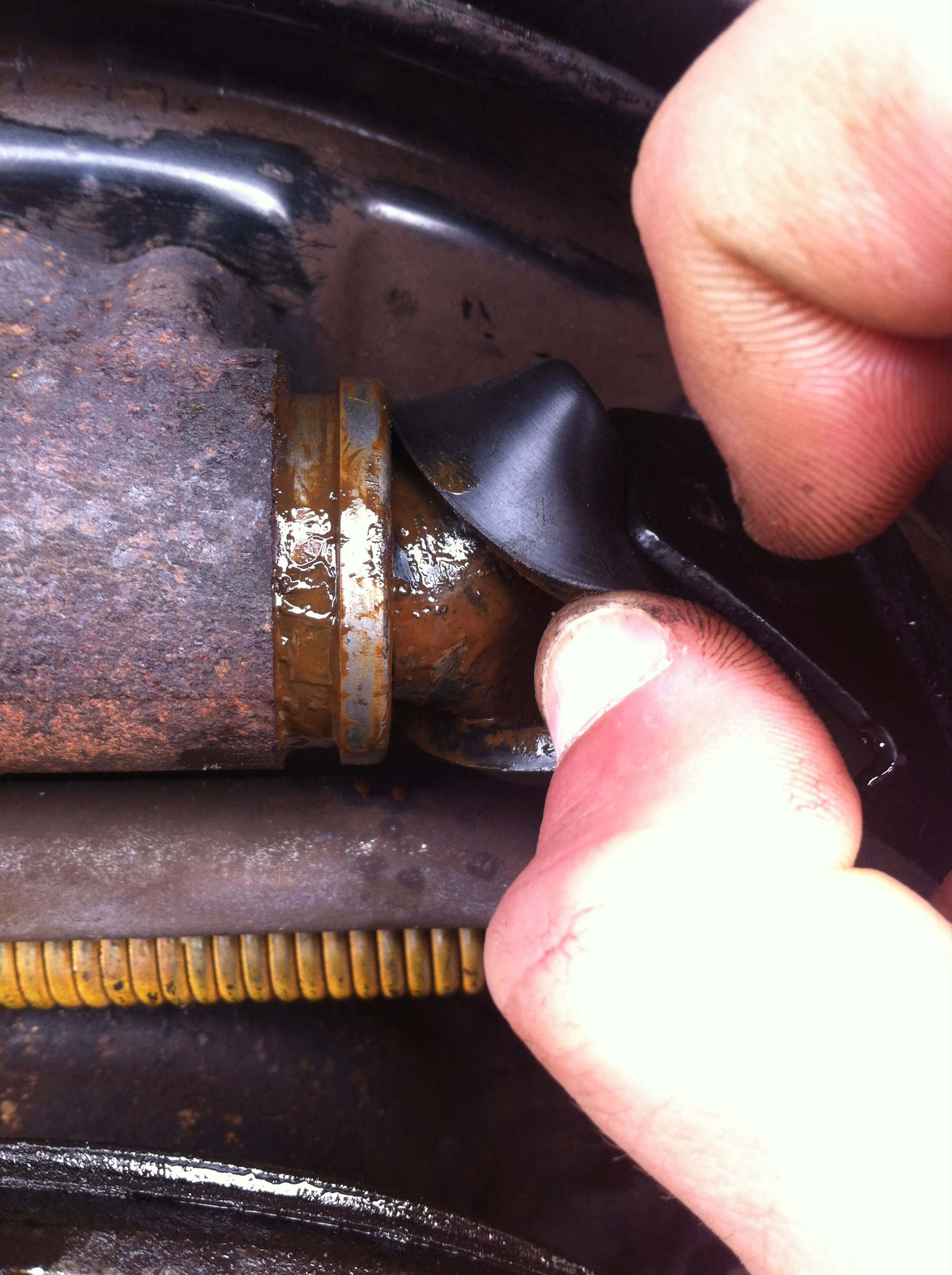

The one on the right is what I should of had all along. The one on the left is the parts store piston.
