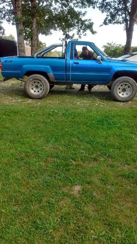

Here is a pic. I meet with the guy and 3k was the number.

There is a trick to getting the shafts out to replace the shaft or boots. I would replace the shaft if it were me. Seems like is was $60 per shaft if I recall right on my last job. Not to bad to do. There is a write up on here some where that shows how to do it. Been a while since I have done one.
I did not think your generation of truck had vacuum operated 4 wheel drive. Usually just the hub and transfer case. The newer trucks did have vacuum operation.
I have heard of people dropping just the transfer case. I prefer to pull the transmission and stand it on its end and drop the transfer case into place as per the factory service manual. I had a transfer case that I could not remove with it laying on the floor, stood the transmission on its end and it lifted right off. Not sure what was holding it together and would not release. I know separating the transfer case has been done with the transmission still in the truck, I just have never done it that way. Nice looking truck you have.
