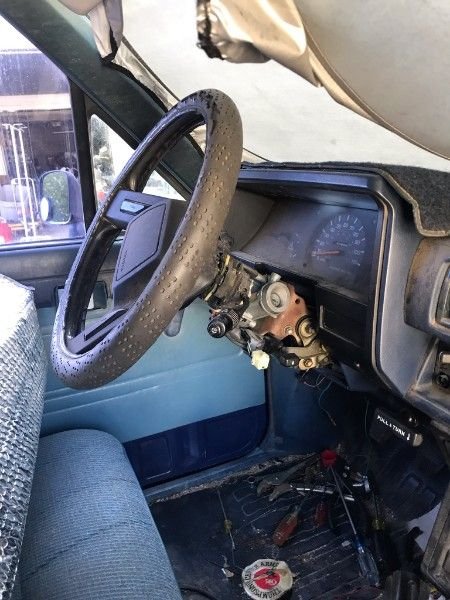

Do you think the “problem” is electrical or mechanical. The lift is minor and shouldn’t cause a problem as far as i can see. Test all the electrical functions of the column- lights, blinkers, wipers, key, highbeams, horn, then tilt it and test again. Maybe you can narrow it down to one of the typical-for-the-age failures.

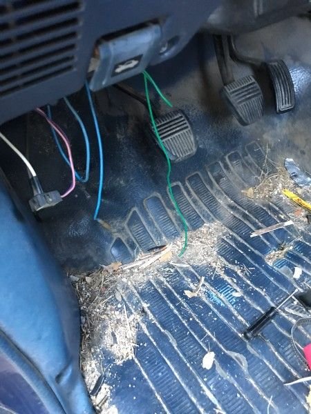

Looks like he may have been trying to bypass something with those blue and pink wires.

@Melrose 4r : Potentially, nothing was actually wrong, originally! My mom just wrote me "He hadn’t been driving it much in 2019, not at all since his stroke in 2020. He occasionally tinkered with it and seemed to enjoy that. He could pretend that he would drive it again. He thought a vandal had attempted to steal it and that led to his cutting the plastic off the steering column. That’s where it stands."
