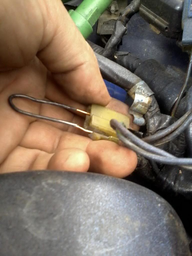

With the jumper in below will it run.
Copied...
Here is how you do a Fuel Pump Bypass on the 85/86.
Jumper wire the Yellow Plug on Drivers side. ( Jumper wire should be in both contacts for testing, I just didn't have it in for picture purposes and mostly a reference for me at a later time.)

Tried the jumper, still the same thing. All hoses are correct. Would timing have anything to do with it? If I put it at tdc on the crank and take the valve cover off the mark on the cam sprocket is at about 10 oclock position but the silver link on the timing chain is at about 4 oclock
