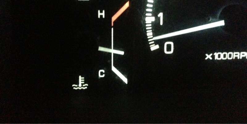

I paid closer attn to my temp hand when I started it this morning. After about twenty seconds it went up to here...

Haha, I sure am glad mine doesn't do it, a working one sure does come in handy alot.

That high in 20 seconds is not accurate at all. Do not trust it!
Sounds like your water pump is leaking from the weep hole on the underside.
Suspect the "steam" you saw was this leaking water hitting something hot enough to evaporate it.
Take a small mirror out of your wife's purse (ssshhhh don't tell her) and use it to look under the pump where the shaft enters. There will be a small hole there, if there is any discoloration or wetness there it is leaking and needs replaced.
