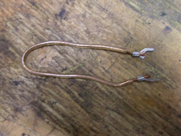

Are you sure you're getting a good connection with your jumper tool of choice? I couldn't get my rpm's to change using a paper clip. It wasn't making good metal to metal contact. So I used some speaker wire and put some connectors on each end that were a little wider than the paper clips and made a snug fit. Using that wire I made a good connection and was able to get the rpm's to change.
Rob
