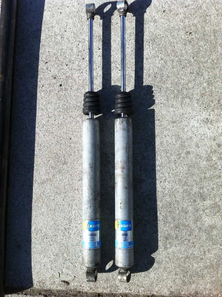

Originally Posted by zembalayan
I like the Bilstein 5125s, and have run them for several years with the Daystar EVS foam bump stops, but I recently went with Old Man Emu (OME) shocks I got with the 2.5" Dakar emu springs for my new to me 1984 LN65. Like the set pretty well.
How are those foam bumps???
Yea bilsteins are great, my 5150s do a decent job keeping up with my fox's for what they are. For some people the adjust-ability is really nice though

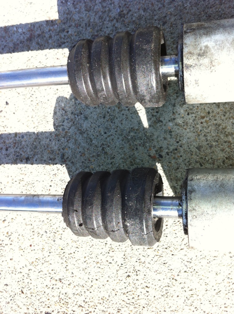

When i swapped out the stock link and coils on my 1993 4Runner for Marlin 5" HD rear springs, i did not install any true bump stops, but instead these evs shock mounted bumps set up on the rig in a way where they would compress before the springs entered a negative arch. They were great for crawling and slow wheeling, but I would not trust them for any higher speed bottoming out. Luckily, I never wheel like that. They are fairly cheap; they add a little piece of mind.

Here's some pics as reference:
