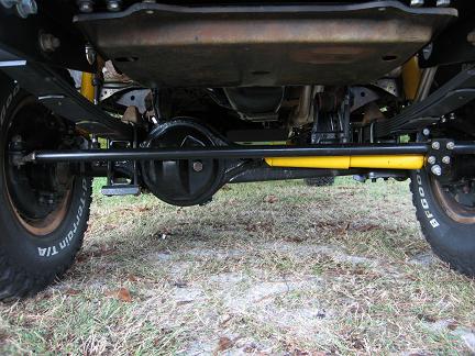

Originally Posted by Wardamneagle
You should be able to get a steering arm at a pick-n-pull for almost nothing. I see them on ebay sometimes. I would replace the Tie-rod with one from Budbuilt or Marlin with the Fzj80 tie-rod ends. They are much beefier than OEM.
Originally Posted by TOYOTA 1
^ i dont think they wont fit in the factory steering arms. 99% sure, but not 100% lol
Well I'm 100% sure that they will. This one is from Marlin and those are FZJ80 tie-rod ends.

Those are likely the FJ80 rod ends, but while the tapered end will fit the steering arms, the threaded end is larger than stock (at least for the pickup/4Runner) so they won't screw into stock tie rods:
Marlin Crawler was the first to use these beefy tie rod ends for Crossover steering on Pickup and 4Runners. These heavy duty ends offer more strength and security with up to a 6 mm larger thread diameter than stock.
I used to run a set of these one one of Marlin's original Marlink tie rods:
they are massive joints and if installed in the larger diameter tie rod you have a very strong setup.

Yes those are the ones but you will need one of their Marlink tie-rods to go with them. An alternative is to buy this tie-rod from Budbuilt:
http://www.budbuilt.com/new/tierods.html
You would still need the tie-rod ends from Marlin or a dealership.
