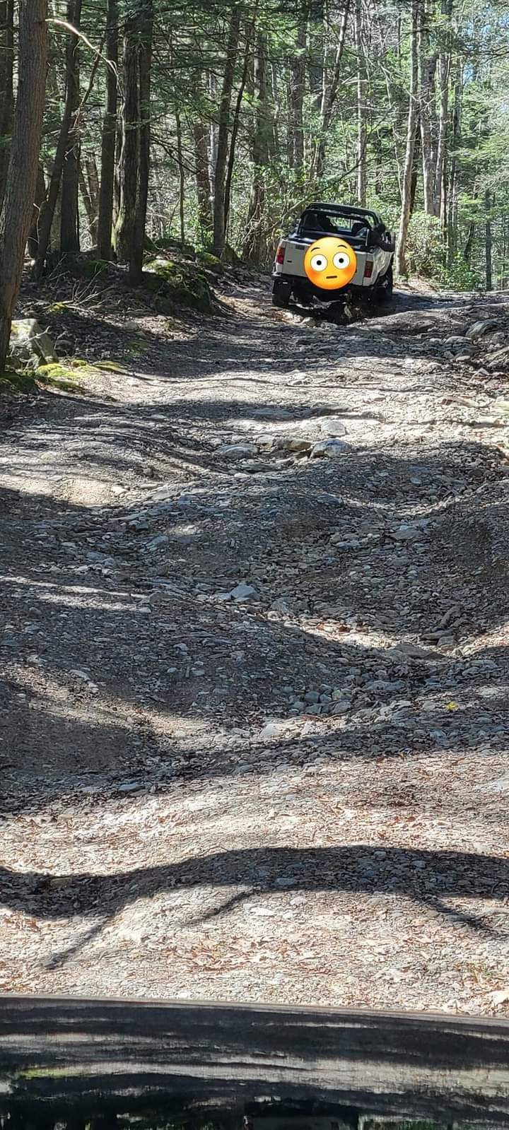

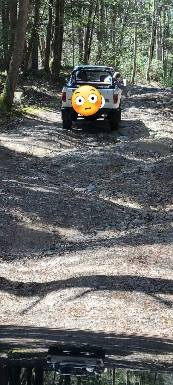

a fun week with the 4runner. First trip to the beach earlier than any other year and some light wheeling with friends today.

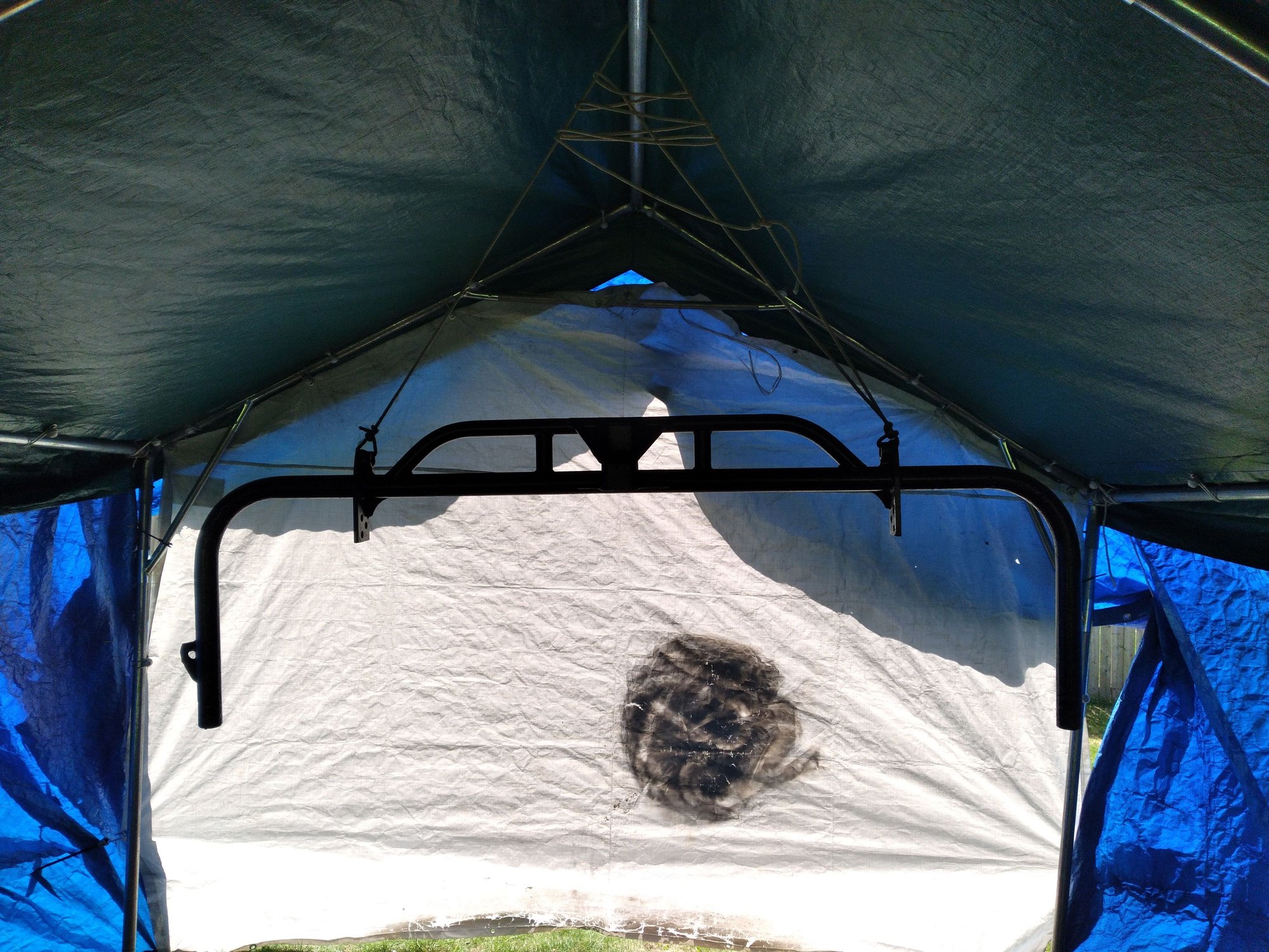

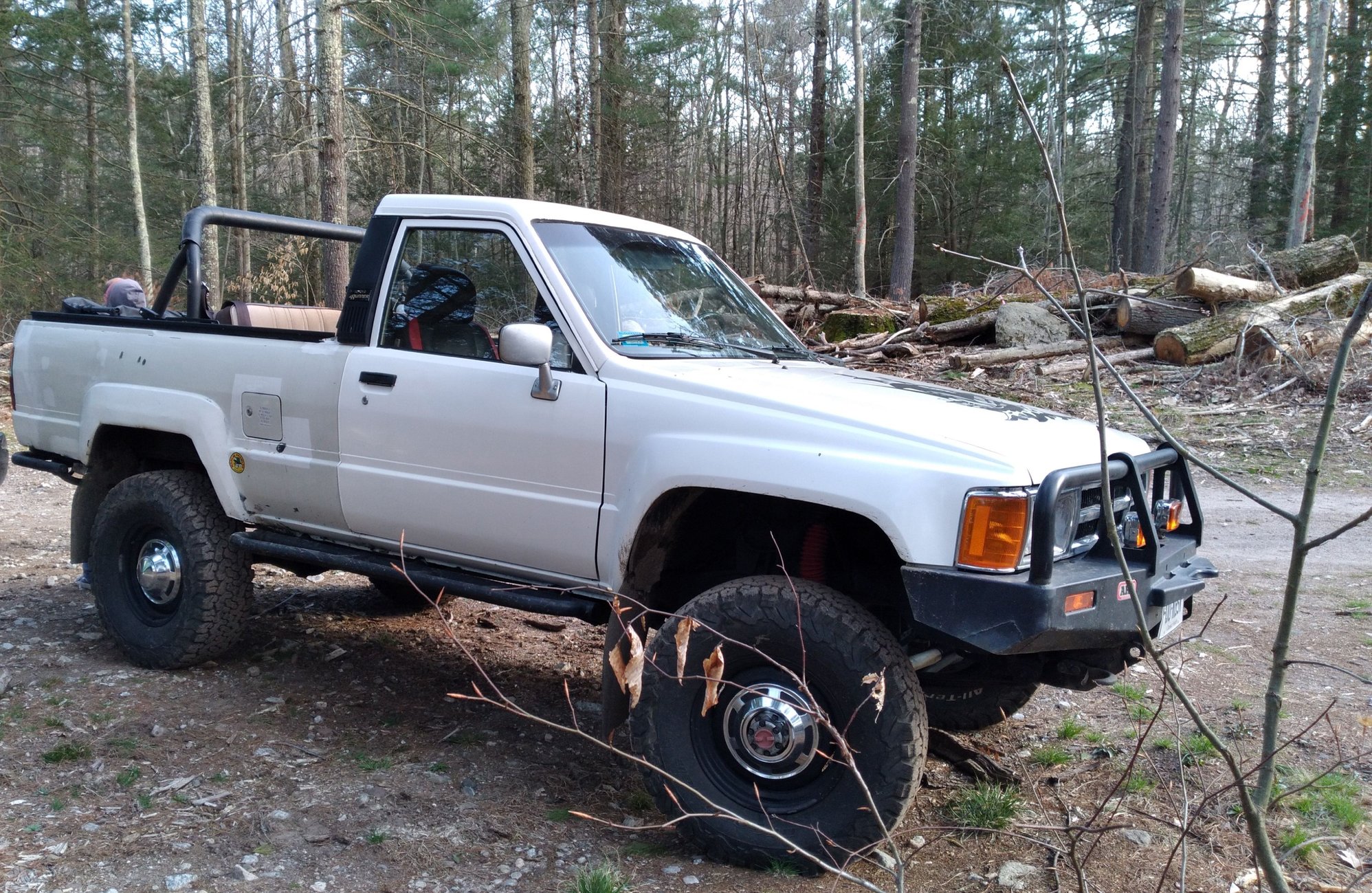

you gotta rig up a lift in the garage for the top. I still want to do something better for the current lift to get the top higher yet but it's so good now that I'm tempted to use it more often when the weather isn't as good as we've had lately but I do have a nice tent to park under these days. I lowered the tent too so there is less chance of rain going in sideways.

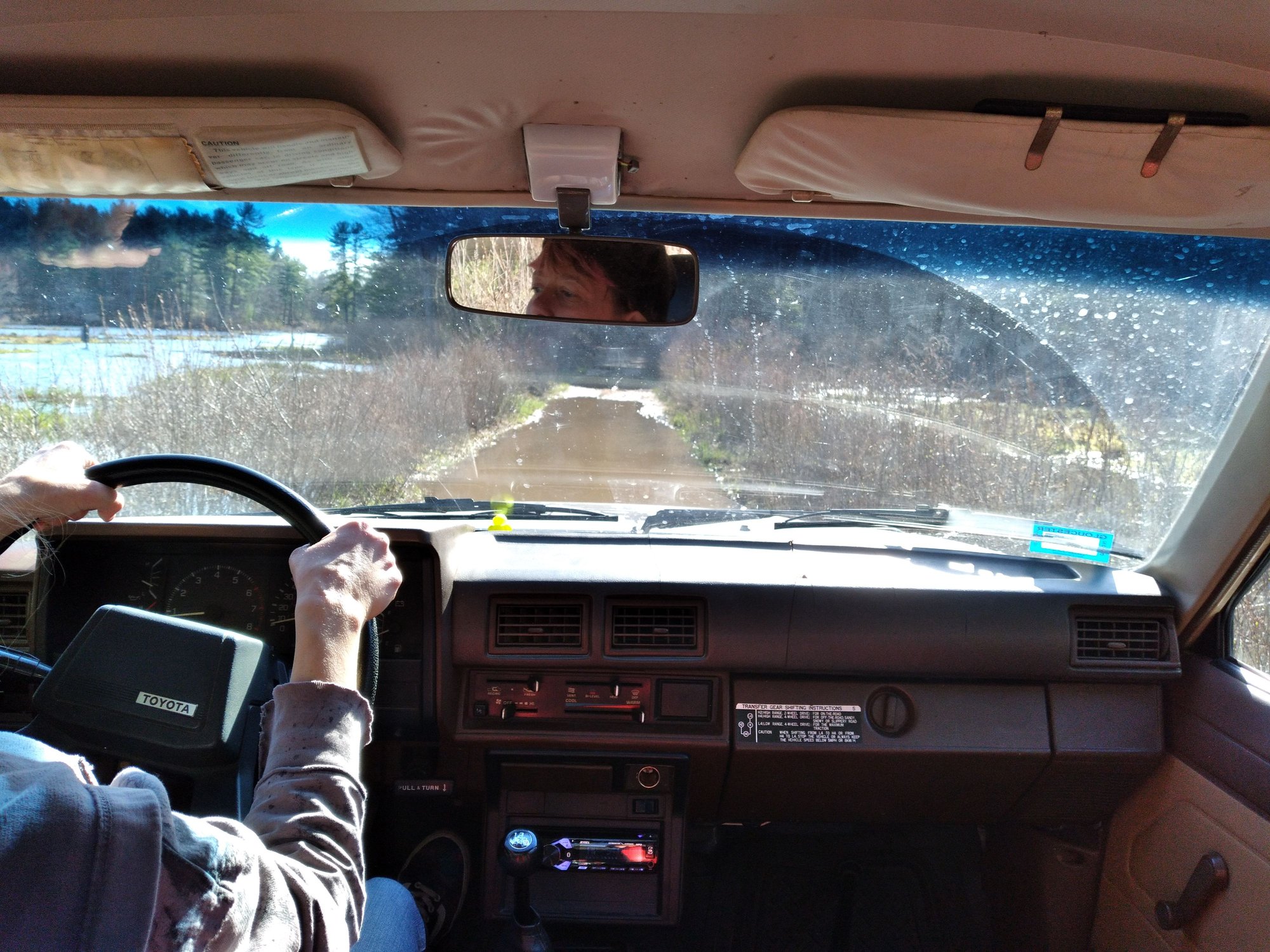

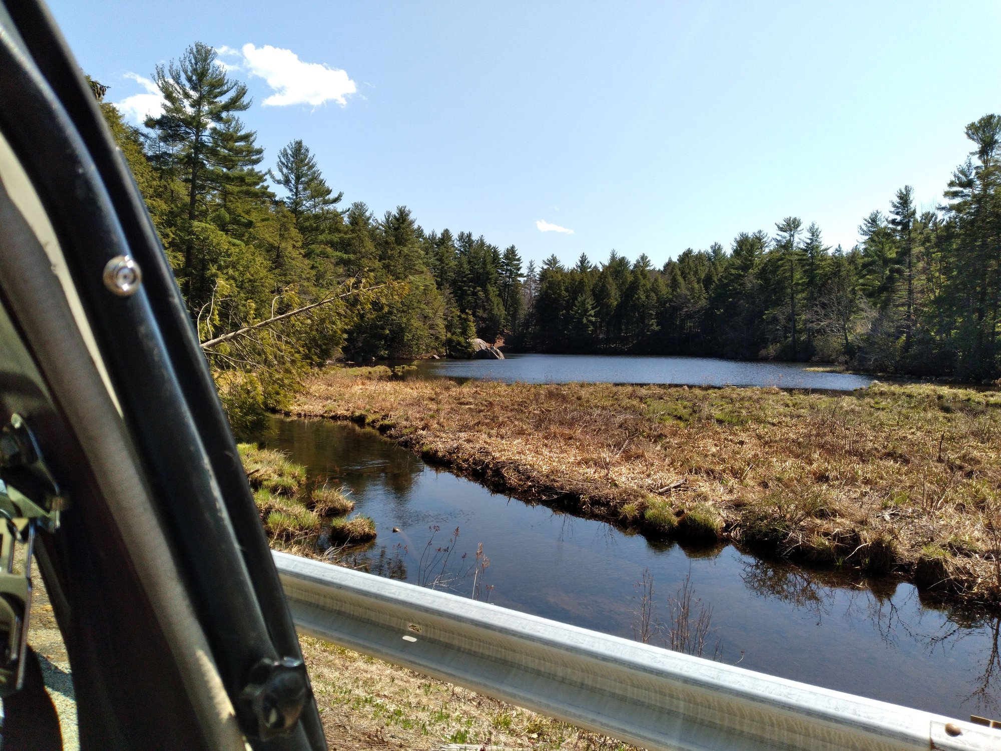

I was fortunate to have this week off from work and the weather finally cooperated for us! The last trail we were wheeling on our friends showed us and I was the one to tell them how to get there. I never noticed that other road all these years. Cool places out there. Nice little pond and an old stone house foundation .

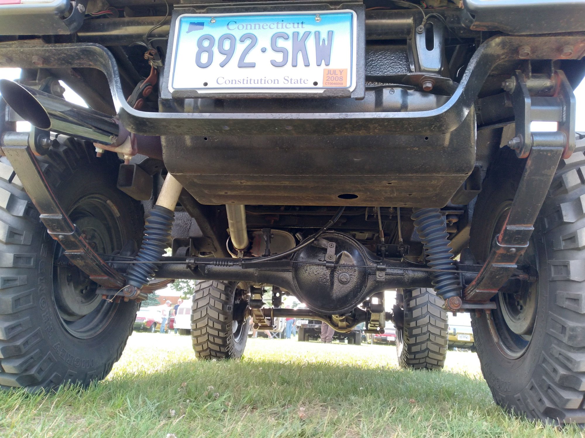

Well this turned out to be a bigger project than expected! I want to paint the rear bumper while I'm painting the roof rack for my FJ and not only was the bumper bolted on by atleast 8 bolts someone welded the bumper to the brackets and the brackets are welded to the frame.

Looks like you eventually won the battle!

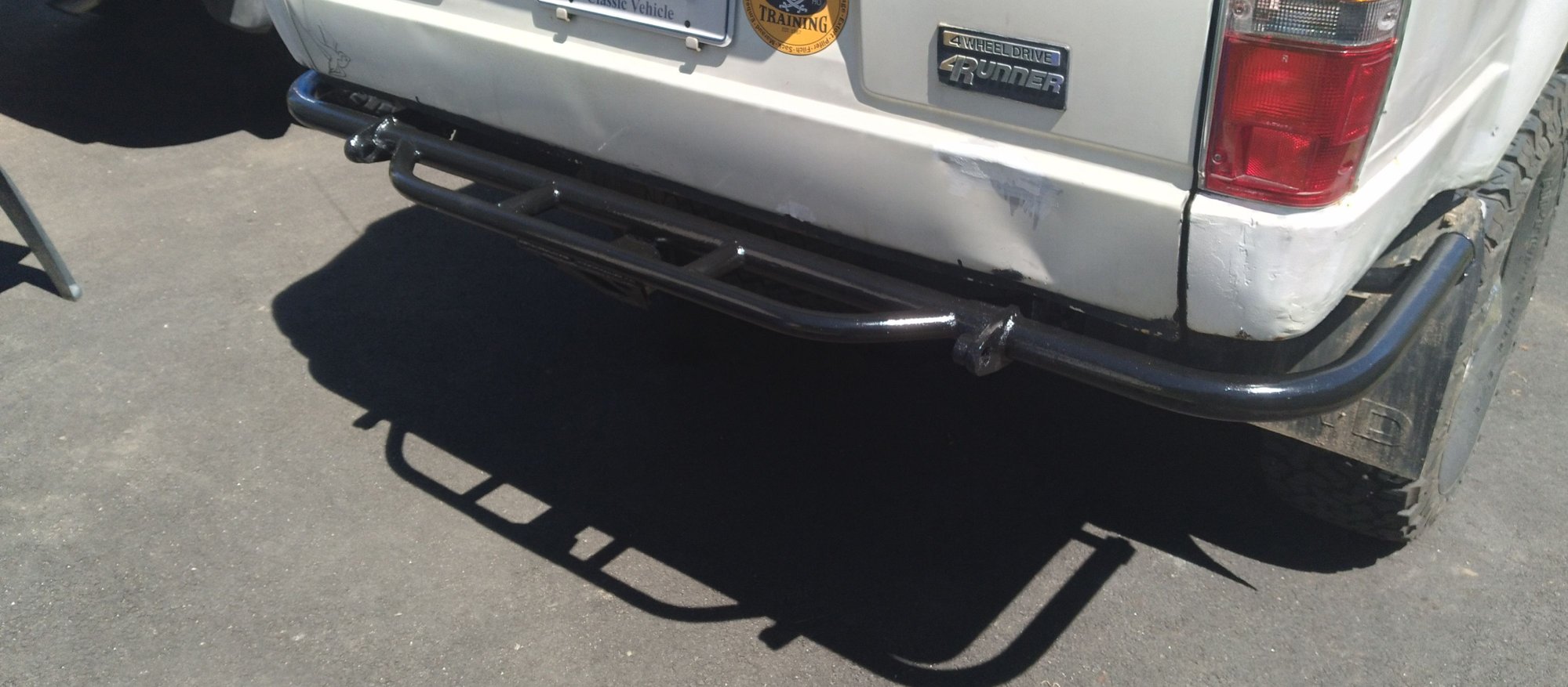

it took a little longer to get everything I needed together for paint so I only painted the rear bumper. The FJ roof rack will have to be done separately.

I put another coat of paint on the rear bumper while painting the roof rack today.

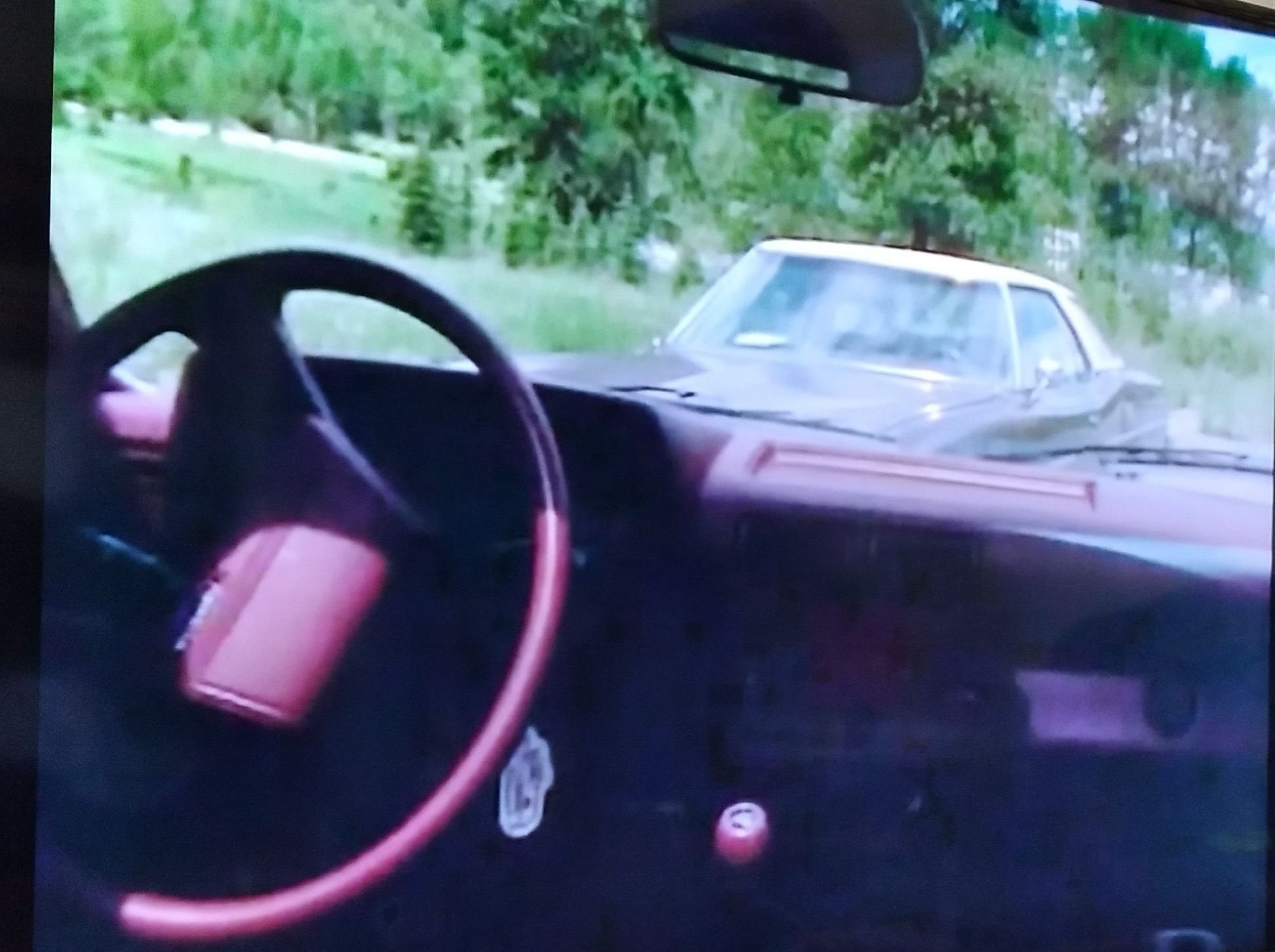

Spotted a 4runner on an old episode of Unsolved Mysteries today.

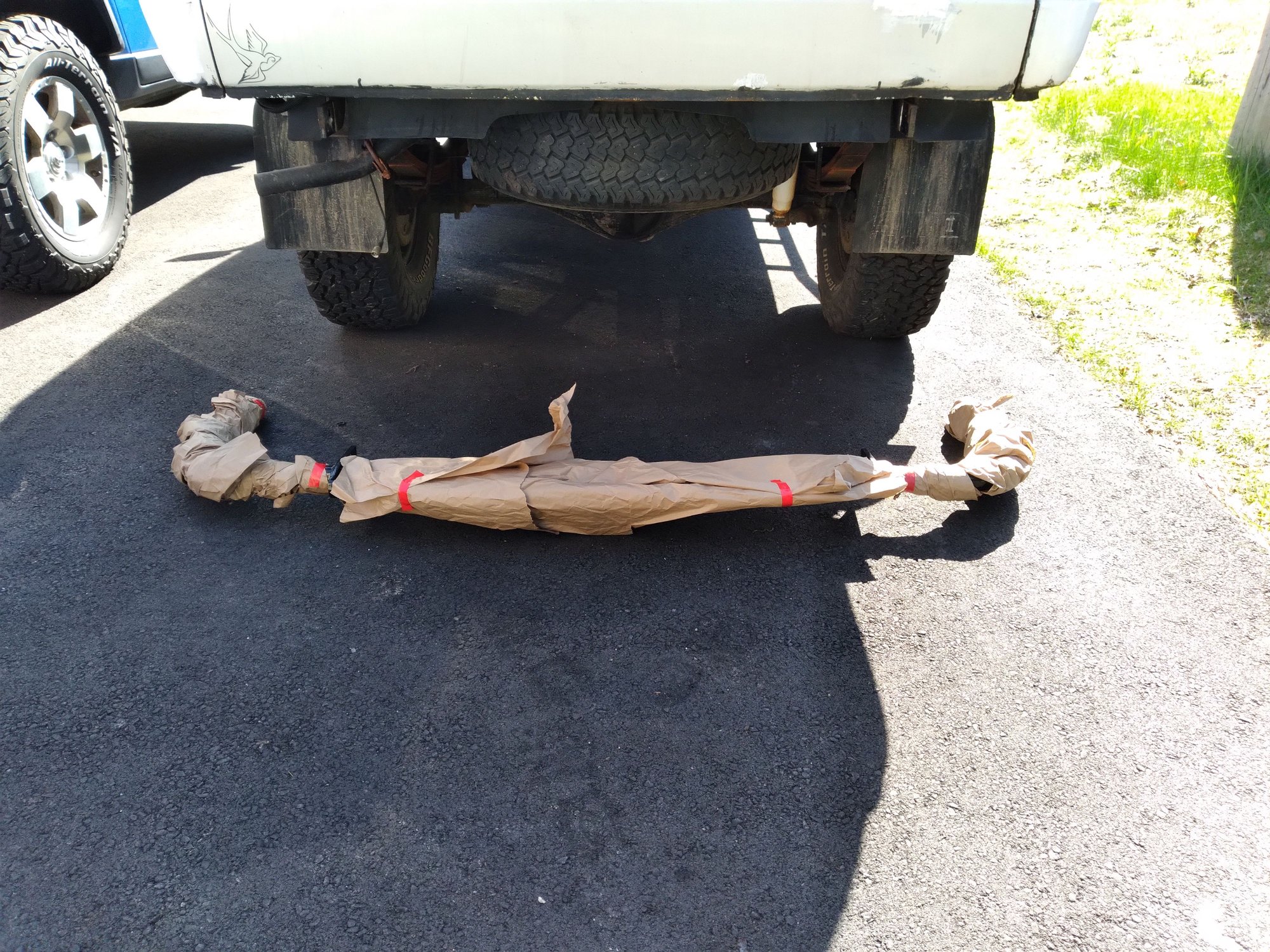

I wrapped the bumper up like a Christmas present and it's back on. Then jumped in to take it for a spin and I think I blew the ignition coil.
I pulled the spark plug wire from coil to the distributor cap last night so my wife didn't accidentally take it to work before I got the bumper back on. I think it ground out when I jumped in and turned the key forgetting that I pulled it last night. At first I thought it was the ignitor so I put in the spare that I have in and got it running. Then I put the old one back with an older coil that I had and it started.

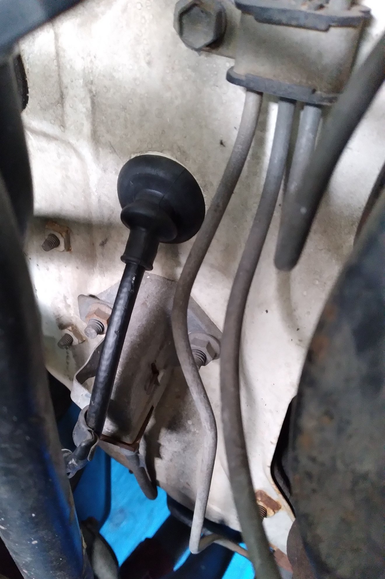

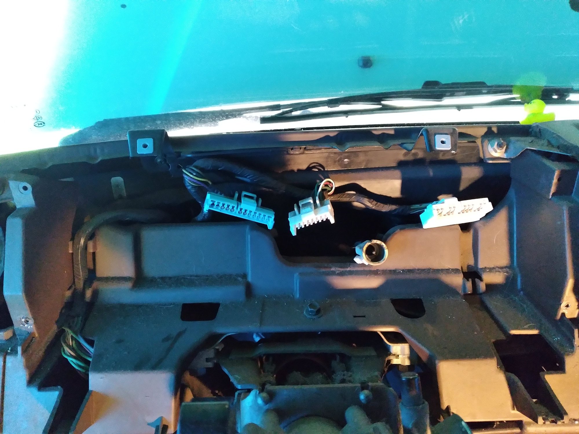

new speedometer cable installed today. I tried to get one from Toyota parts deal. com but the order was canceled. I looked it up again and couldn't even find one on there anymore. I got one on e bay that was custom made but no firewall grommet. I contacted the seller and he was like "use the old one because they are not available " the old one is toast and the grommet has to be installed on the cable before the ends. that's why the grommet is NA, it is part of the cable. anyhow I got one from yota shop (Speedometer Cable- Toyota 4Runner & Pickup Truck 22R & 22RE OEM Speedometer Cable (1984-1989) 83710-89147) it works and is a little short but reached the cluster and the part that attached to the transmission is a little different. it didn't fix the shaky needle though so come winter time we will probably still have the squealing sound from the guage cluster. the problem is probably the cluster.

So after a quick test drive the speedometer needle looked steady. I added just a little bit of grease to the end that goes to the cluster during installation maybe it worked out or maybe originally testing it by jacking up the rear axle wasn't good enough 🤔

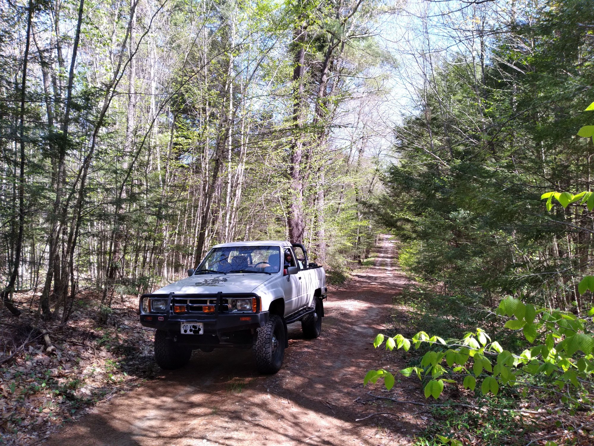

and today the 4runner in its natural environment. They opened the gates to my favorite dirt roads in Peoples Forrest!
sunny and 80s
we saw a turkey and a bear cub out there.

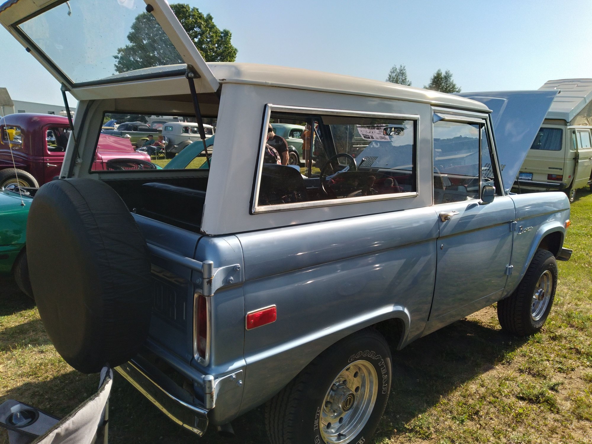

Today's adventure in the 4runner, we weren't the oldest Toyota out on the road! And a cool Bronco .

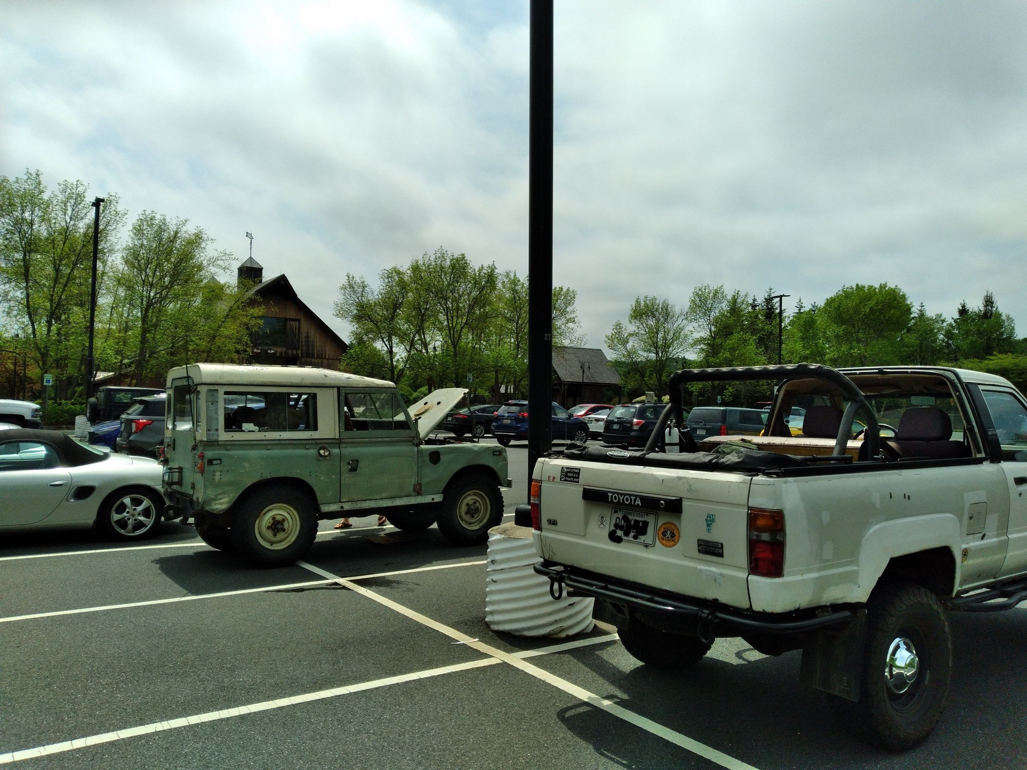

Ahhh our first trip to Vermont this year with the 4runner. I even managed to get in some dirt roads. Of course we weren't expecting route 9 to be a major dirt road! It reminds a lot of the logging roads in North Maine Woods right now due to construction.
we didn't have the oldest vehicle in the lot at the Vermont Welcome Station!

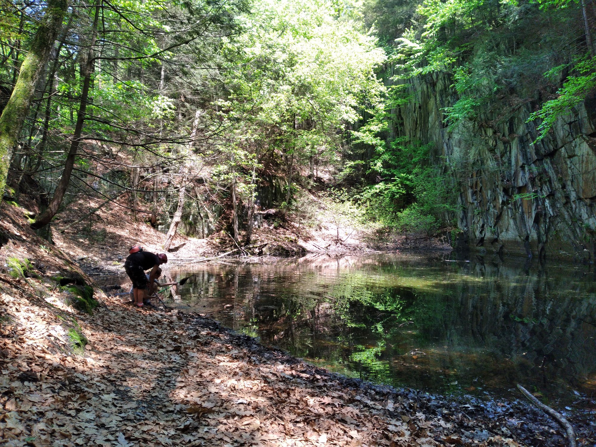

From the welcome station it's a short hike to this cold and clear little river that we cross to get to the trail that leads to Fort Dummer State park. It was nice to hit that river since it was 92 degrees even in Southern Vermont! The campground was completely empty since it's not open for camping till next weekend.

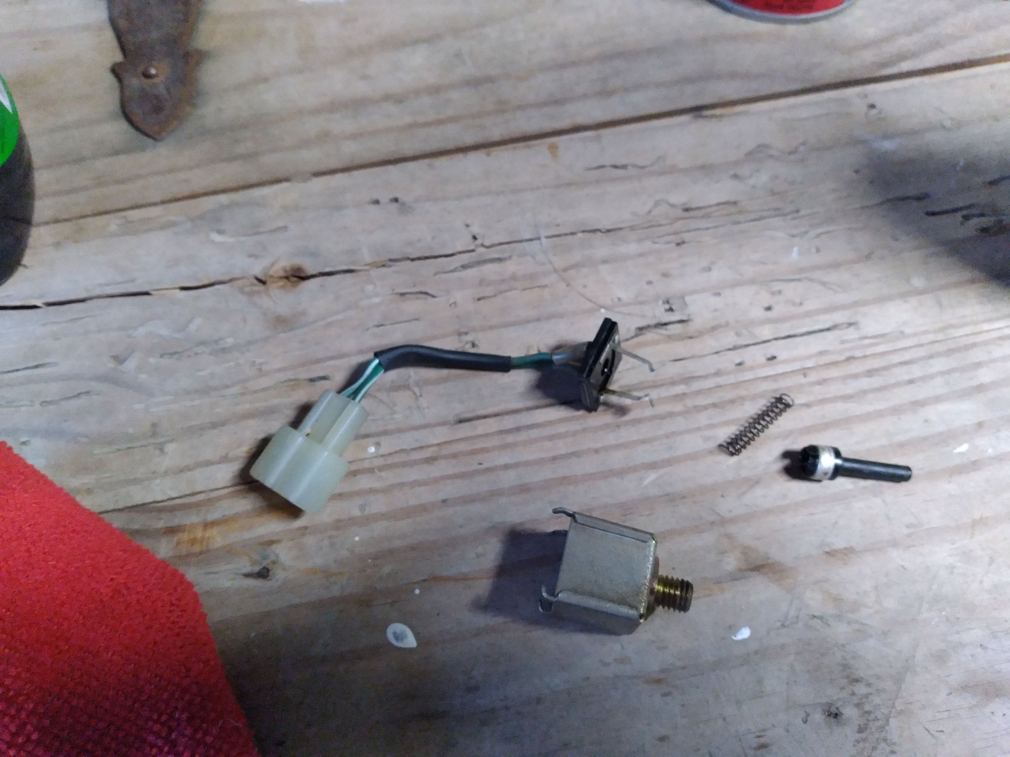

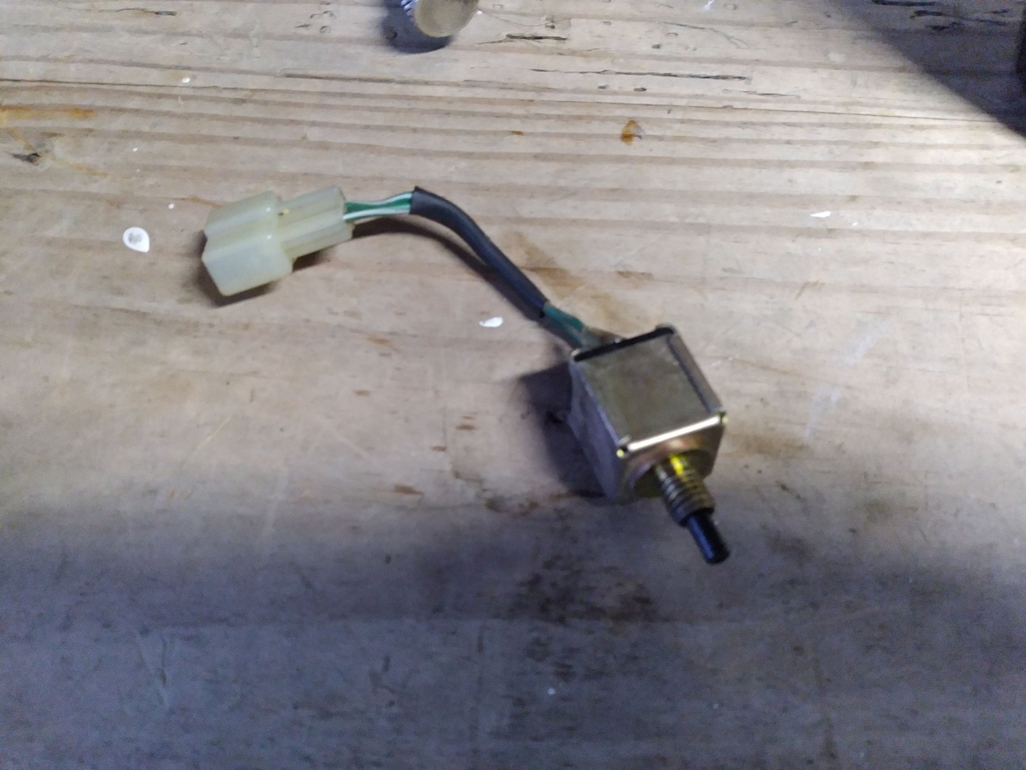

This is a weird repair job. When I got into the 4runner the other day heading to the beach I noticed this little part that looked something like an RC car part. It turns out the emergency brake light switch came apart. I think the walls to the switch spread apart. I cleaned, greased and reassembled it plus wrapped a zip tie around it.
