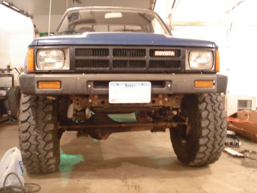

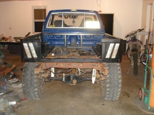

i finally got some pictures of my truck. Its still pretty basic. A cheap suspension lift, some 33x12.5 in tires and a custom made box (not complete) Tell me what you think and what you think i could improve.

nice man it looks pretty good. I like that custom box u have on there.

I like it !
I'll suggest sliders next and then on to the full exo !

thanks for the feedback although I dont know about the exo cage.... have never really been a fan of those. I would like to put some sliders on it at somepoint but im kinda strapped for cash at the moment. The next peice to go on, hopefully tomorrow, is a bumper on the rear. Any thoughts on cheap ways to increase low end power? i can cruise fine but it seems like im a lil bit lacking at the lower RPMs. oh and a floor goes in the box this week too. I was also thinking about running some seafoam in it and see if it makes a difference in milage. Im at about what i got with my trans am. 16.5mpg so im not complaining but every little bit helps. right now im focusing more on things to make it nicer/cheaper to drive and not too worried about the off road mods like sliders becuase i leave for college in a little bit over a week. kinda hard to haul stuff to college with no floor in the box.... lol

Damn it! That makes me wish I hadn't sold my '84! Looks good to me. With those tires I don't see much as far as gas mileage improvement though. Try some seafoam anyway, it couldn't hurt.

Can we get specifics on the lift?
As for recomendations, I recommend no rear bumper, let the bottom of the flatbed be the rear bumper, why take away departure angle? Get some sliders ASAP. As someone already mentioned, regear the axles for better low end. If you want a better crawl ratio you can regear the transfer case. That isn't as precise so you can do it yourself.
I wouldn't lock the front end on stock steering. I made that mistake, it was great for a while but ultimately I payed for it by a weekend riding along with someone else at Paragon AP when my steering gave out.
Get a locker in the back ASAP! That is one of the best off road mods you can make. I would do a locker and sliders before anything else.

now the other posts. I dont plan on selling it. I suppose i would if i was offered enough but it would have to be a lot. The lift is a superlift 3 inch kit. New springs up front and super cheap add a leafs in the rear, but one of the top things on my list is the chevy spring swap, since i have a junk 2wd chevy at my house anyways it should be cheap. I just didnt have the time. my rear bumper isnt going to be any lower than the rear shakles so im not going to loose too much, plus it should be really easy to remove if im going to be doing any sort of serious off roading where ill need max approach and departure angles. i really wish i had the money to do sliders and lockers but that will have to wait till the middle of winter or next spring at the soonest. About how much would regearing cost and how extensive is the work to do it? also what gears would be good? and what locker is a good choice for a daily driven truck?

from what i have read they articulate better and ride smoother because they are a longer spring with less arc. All i know is that my rear add a leaf is harsh. I avoid a few roads to spare my back and neck the beating. I am looking for ways to soften this up and so far im thinking that the chevy spring swap would be a good way to do that and gain some articulation while im at it.
The wood is just about ready to be installed on my box. Should be some new photos tomorrow of the complete look....for now
