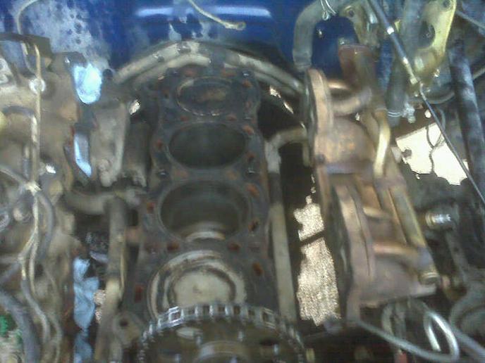

Old Jul 26, 2010 | 12:28 PM
clg82's Avatar
Joined: Jul 2010
Posts: 9
Ok here is pic one let me know what you think...we only had water in the first two heads.....

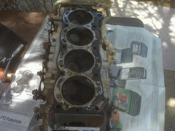

Old Jul 26, 2010 | 12:34 PM
clg82's Avatar
Joined: Jul 2010
Posts: 9
here's pic number two......

Did you have water in the block at all when you pulled the head?

Originally Posted by clg82
it sat for 5+ years because the granson she bought it for didn't like it...
Dumb, kid. Oh well, his loss is your gain
Good God that head is ugly. Make sure the mating surfaces are sparkling clean. If you had to make short cuts on cleaning any kind of gasket surface... this one is NOT it. Razor blades and laquer thinner all around. And if water is sitting on top of the pistons, soak it up and spray some WD on the cylinder walls and piston tops.
Also, you should take the head down to a local machine shop for routine inspection. You can get a pressure check, sandblast (lipstick on the pig), and the bottom surface shaved for roughly 100 bucks.
