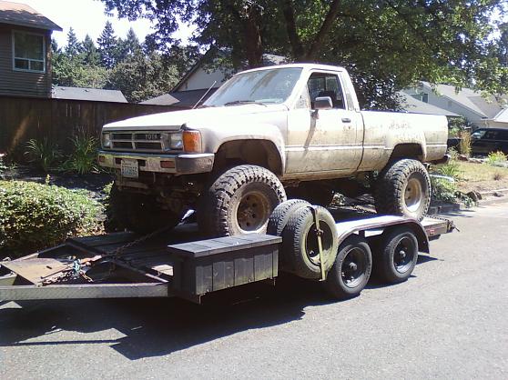

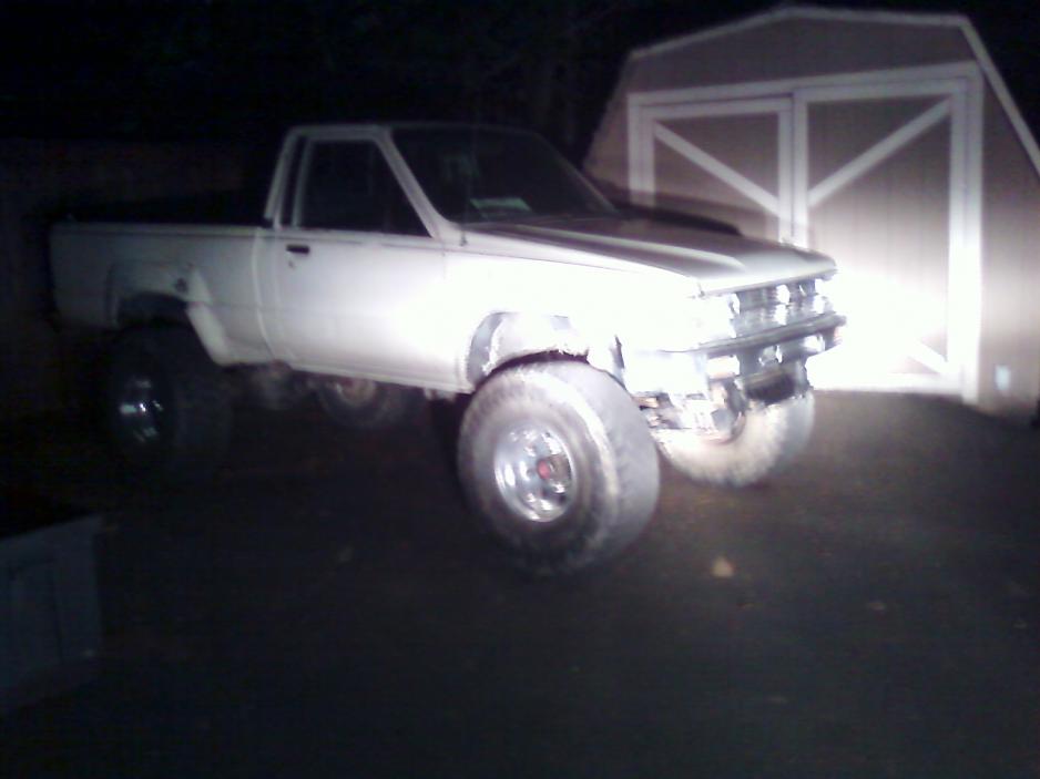

I bought a 1987 toyota pickup 22re-turbo with straight axle swap, lifted on 35s for 500 bucks, did a compression test found out 1=150psi 2=150psi 3=45psi 4=40psi so i was wondering what my options were, im thinking about parting it out but it would make a sick wheeler i just dont wanna dump money into it.

Try selling it as for 1000 dollars, or keep it and find another engine to swap in to it.

dont part it out, i have been looking for a turbo truck for a while and will buy from ya. 1500 sounds like a good starting point, let me know if your interested. but if you wanna keep it slap in some new rings with a hone and swap in new rod and crank bearings and drive the shiy outta that thing. PM me if i can purchase from you
