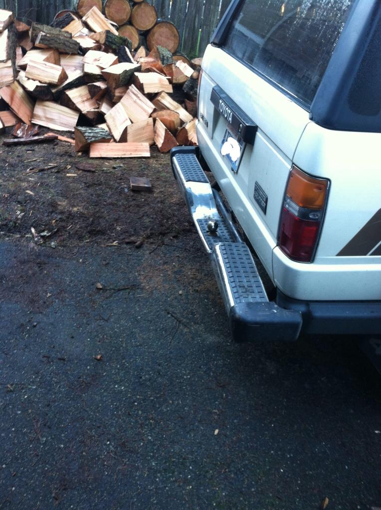

So I straightened out my rear bumper today. Looks better but still need a new one. Name:  2D17EAC6-AFA8-4EC8-A6DD-5DA04CEC3074.jpg

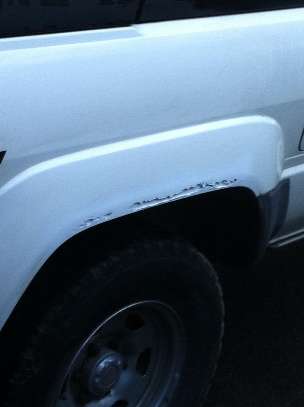

Also pulled that pos chrome strip that has done a great job of traping debris and creating rust on my rear passenger side wheel well. Ground the rust away mostly. Then gave it a touch on rustolium white to seal it. Name:  6C1ADC76-C868-4FFA-9A84-8585C1ADD800.jpg
