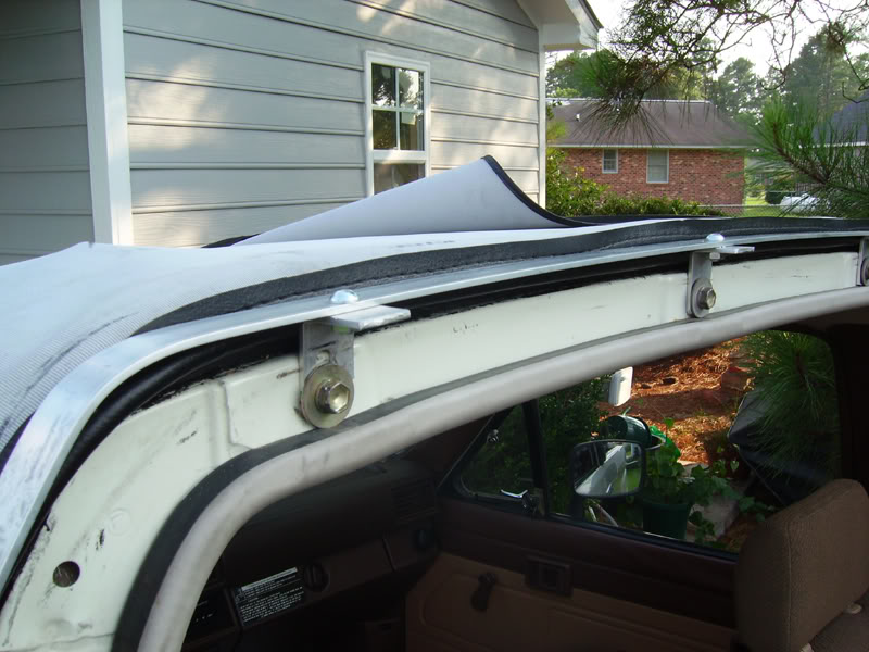

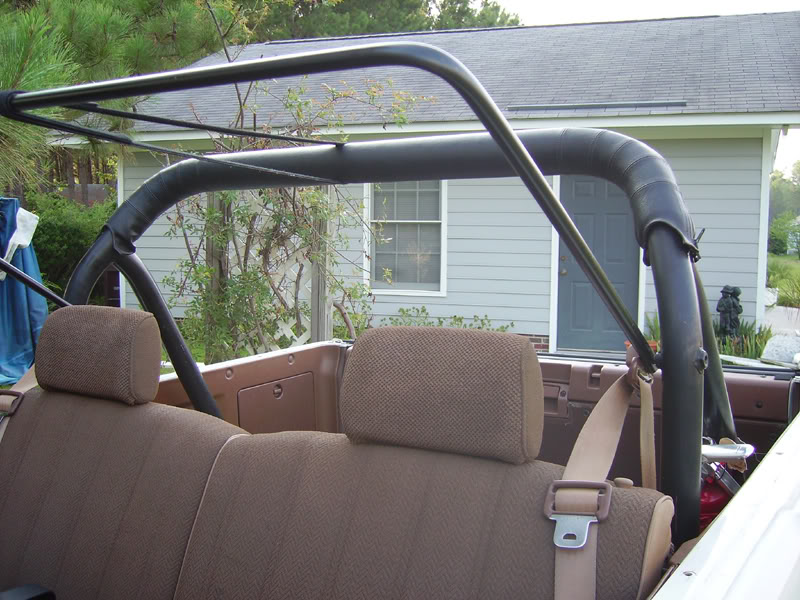

I've had several PM's from people wanting to know about my top. I got the top from TPI, a landcruiser supplier, it's a top for a fj40. The only mod I did to the top was to have the rear straps shortened 10". I went to Lowe's and got a stick of conduit and a 1" by 1/8" by 8' piece of aluminum flat bar. I bent the flat bar to the curve of the cab/top. Some of the extra was cut and bent to make the 4 bolt brackets.
I bent the conduit, drilled holes at each end and wiped it down with lacquer thinner and painted it black. I got a 1" wide velcro strip to help support it in the middle.

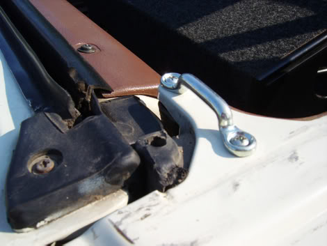

The footman ,loops which came with the top, were mounted at the back corners.

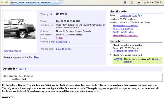

I couldn't believe this on ebay a couple of weeks ago.
there's one born everyday.

OK, more pics. First, this is the dumbass way I came up with last year to hold the top to the cab. I cut a 2x6 to work.
Then I was looking at some pics showing how a CanBack top mounted and got the idea to use the metal. It's alot easier to mount.

This is the conduit I bent and painted.

does the front of the bikini top have like a round peice of metal or something stiched to it?............so you just layed down your top across yourangle peices then layed down that peice of meatl you bent then tighted the screws on top of the little angle peices?
Old 07-10-2007, 06:50 PM
4runnerx3's Avatar
Join Date: Jul 2006
Location: North Carolina
Posts: 922
Received 6 Likes on 4 Posts
Yes, it has a round bendable wand sewn in the front edge. You can see it in the first close up shot of the aluminum flat bar.
