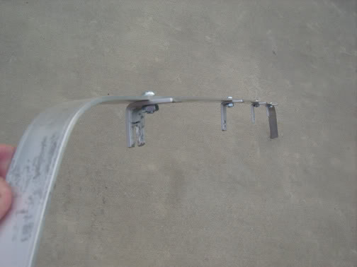

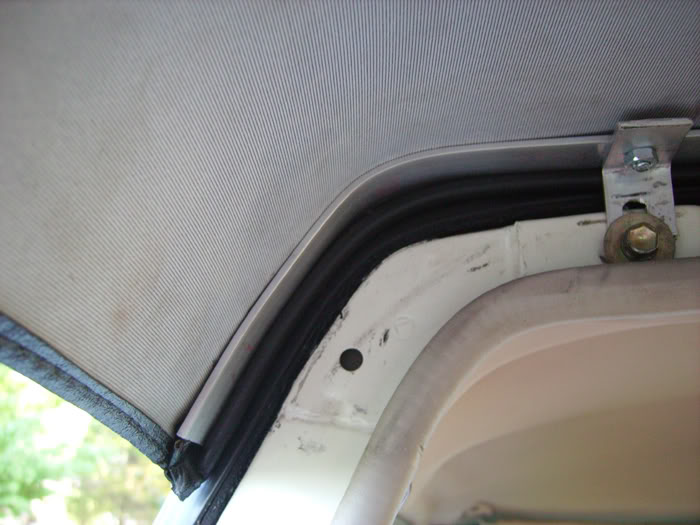

A few questions: So the flat bar pinches the top material between the bar and the metal edge of the cab or do you mount the screws through the fabric? I am thinking of using a little wider piece of flat bar, any reasons this would not work?? any tricks to conforming flat bar to the shape of the cab???

The flat bar pinches the top against the weather striping. The top overlaps the small screws that holds the flat bar to the angle brackets. You can't hardly see them (bumps) under the vinyl looking down on the top. You could use a wider piece of flat bar. I bent the flat bar to the shape of the cab using the red top you see in the background as a bending form. You probably could heat the flat bar a little and bend it very easy.

one more pic.

Pic of the flat bar.
