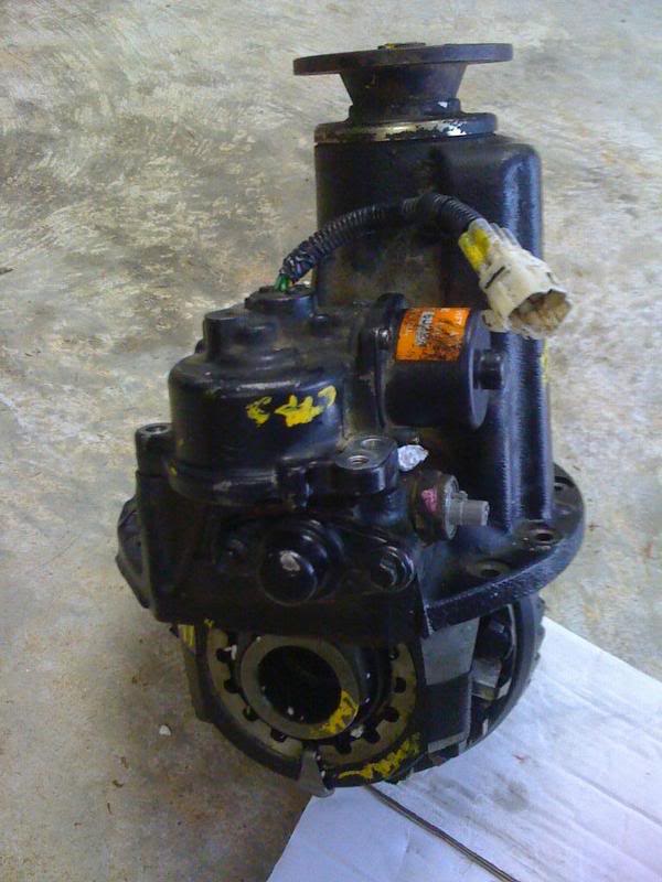

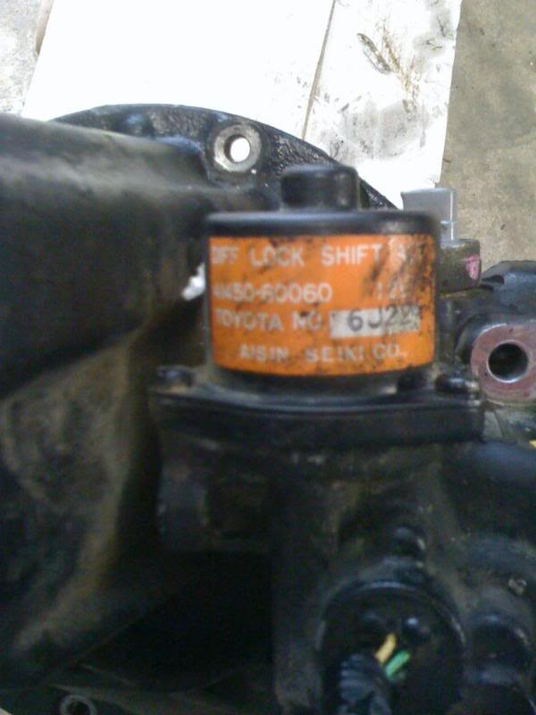

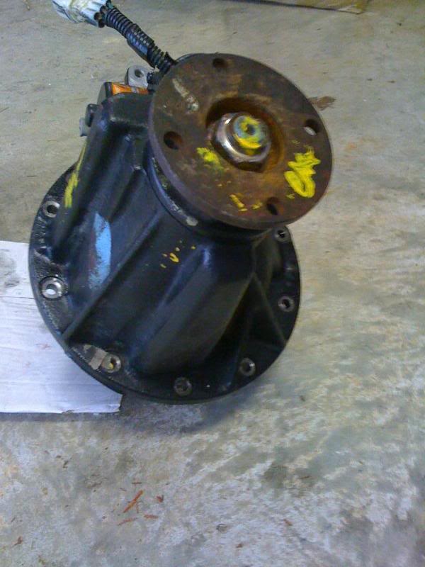

here's some pics of the high pinion e-lcoker
Size:  65.0 KBName:  IMG_0229.jpg
Size:  57.9 KBName:  IMG_0230.jpg

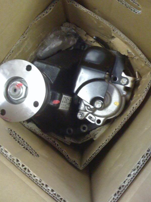

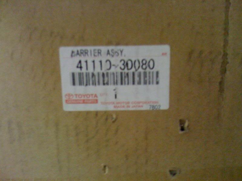

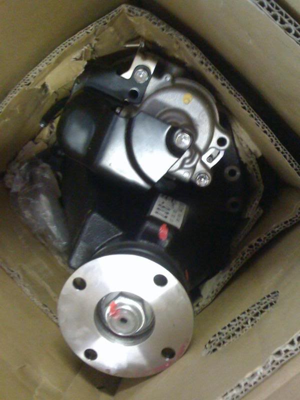

here's some pics of the nib rear e-locker
Size:  48.9 KBName:  IMG_0232.jpg
Size:  51.9 KBName:  IMG_0233.jpg
