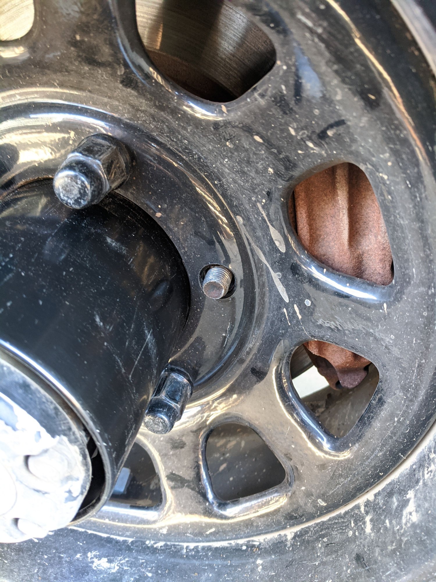

AZ: Yeah, I put the 2" spacers on to get the rim to clear the caliper. The PO had done some sketchy spacing to get the rim to clear (and just barely at that) that left the lug/nut thread engagement much less than I would like. See pics:
Spacer
Not much lug there
Dang that's close!

Yep, Rattlewagon is right about the rotors. It's all coming back to me. Years ago I ended up putting T100 calipers and rotors on mine and a dual diaphragm booster from a third gen pickup. The booster made a big difference.
