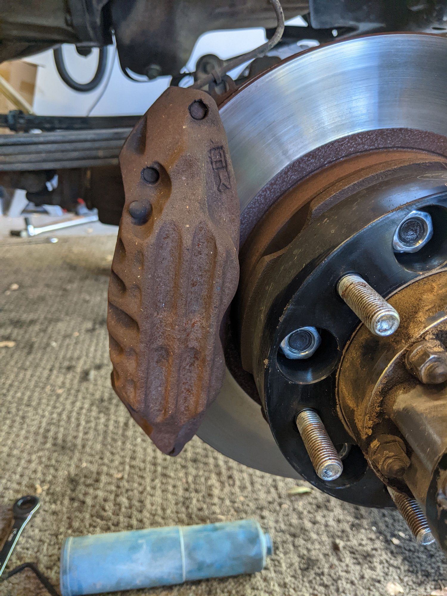

Can anyone identify which calipers and rotors these are?

Caliper outside
Caliper back (I know, the clip was dragging)
Caliper inside
Caliper stamp

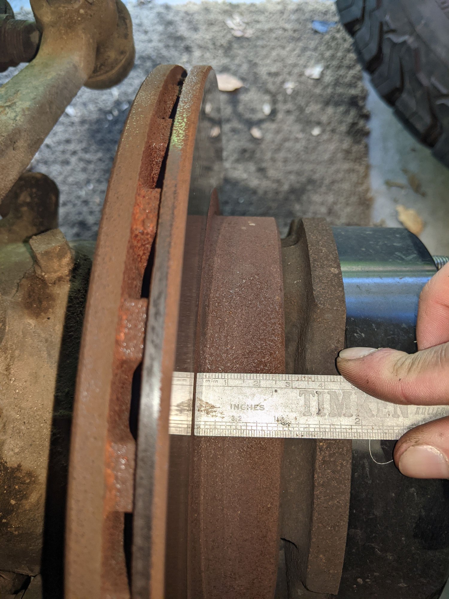

Rotor thickness
Rotor hub attachment / measurement

That looks to be a V6 calipers with SFA hubs, just like what I'm currently running. The IFS hubs moves the wheel mount surface out ~1.5".
You have the SFA V6 rotors, they are not off the shelf V6 rotors, but the calipers and pads are. The rotors are made at the right offset that allows the system to just bolt right up to SFA knuckles.
I'm pretty sure the stock V6 rotors have a bigger offset because they're meant for IFS style hubs.
EDIT: Just so all the info is here too, Rattlewagon noted in another thread that the rotors used in this mod are FJ60 rotors, mine were just from a LCE kit so I didn't remember.

So looks like we're looking at 3.0 V6 calipers and FJ60 (or maybe FJ40? / LCE? / other aftermarket SFA V6 rotors?) on SFA hubs.

Stage 4 S12W calipers, appear to be from a 90's 4Runner.
https://www.rockauto.com/en/catalog/...b,caliper,1704
https://www.google.com/search?q=s12w...hrome&ie=UTF-8
Last one I just googled "S12W caliper, based on the number on the caliper shown in your 5th pic.
