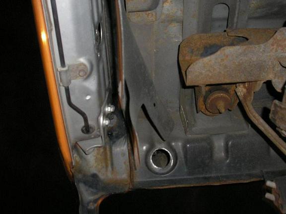

I may need to look again, but I don't have any holes. Just a rubber splash guard with a couple of slits in it. Here are some pics..... I am assuming there is some sort of bracket that connects the frame rail to the bumper bracket?

You just slide the bumper bracket into the frame rails. Lift up the rubber thing, and put it in.

There are holes in the sides of the frame rails:
Looks like you are missing part of the brackets for sure. Unless you have a 3" body lift, there is no way a straight-in bumper bracket will work. You can see what I had to do to make brackets for my old rear bumper:
http://www.4crawler.com/4x4/4R_bumpers.shtml#Rear

yeah, I dont even have those bolts. I need to find the brackets. I am guessing that would be a good junk yard find. Anyone have a stock rear bumper and similar pics of the underside bracket?

Ahh. my mistake. I assumed the object in the upper left of the third picture that bskey posted was the bracket. So, no brackets....hmmm. See if you can get some used, or order new ones from smiity built.
