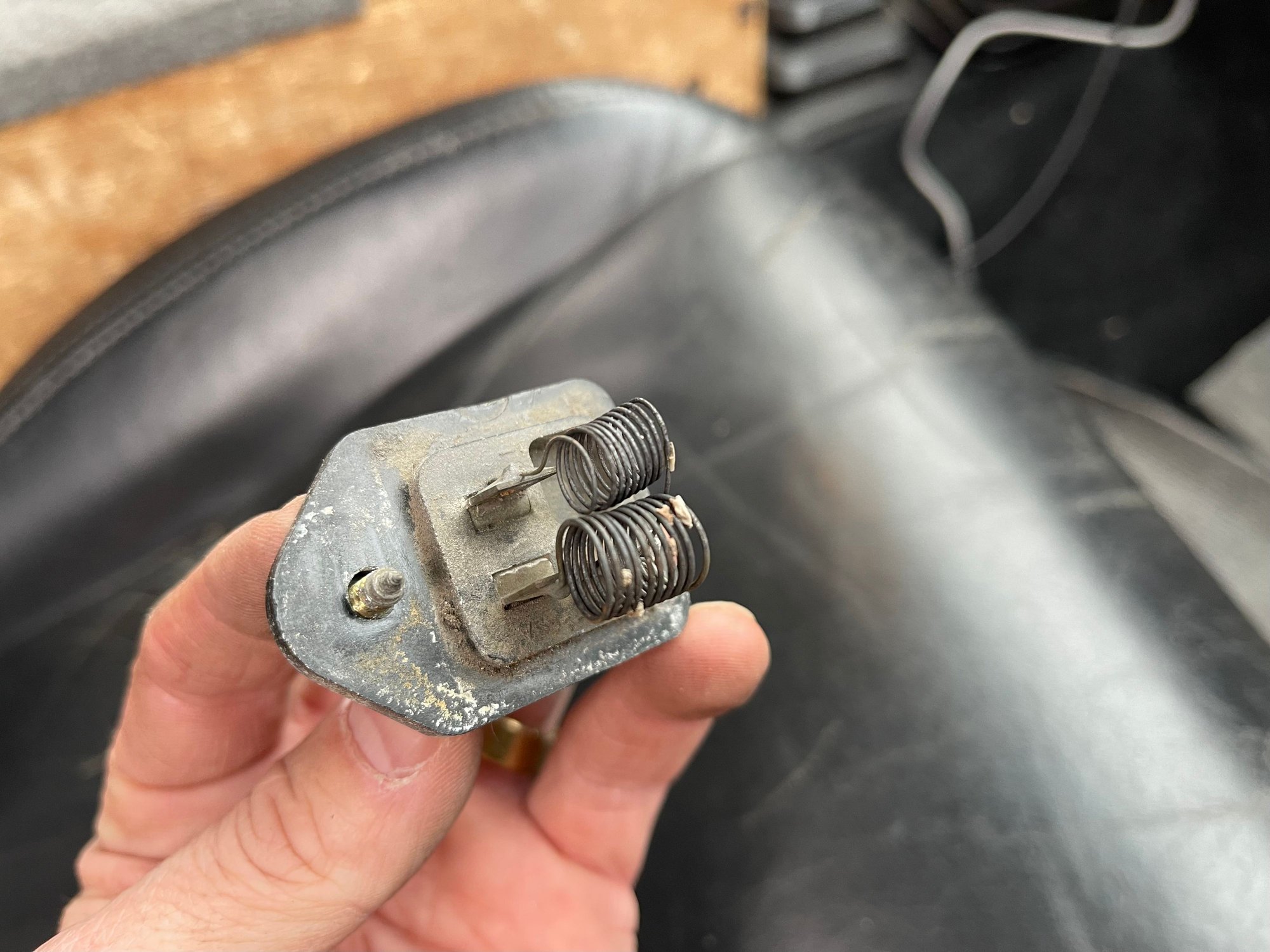

Took out the resistor and this is how it looked.
Not great looking but, the coils aren’t broken. I checked even though I know this isn’t the problem. The motor still won’t run on high.

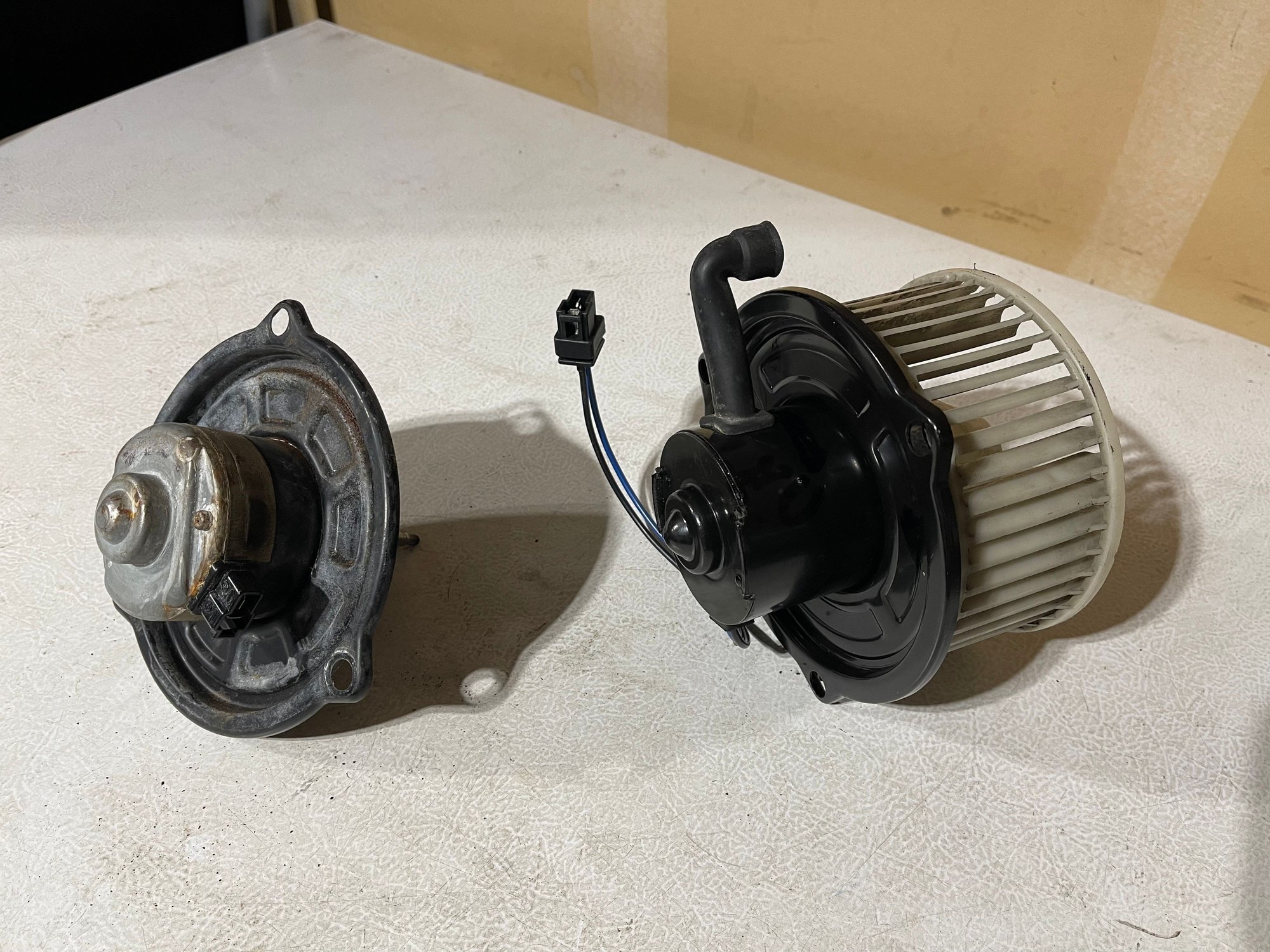

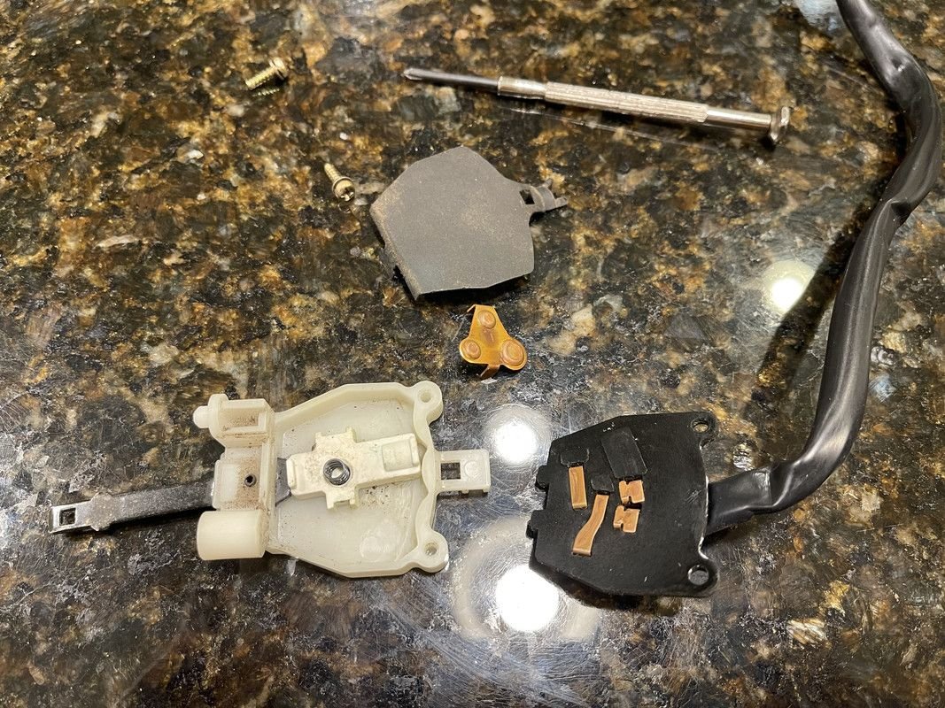

I lied. Pass is closed so I can’t leave town. Tore the switch out. Doesn’t look like it’s seen a lot of heat.
Inside didn’t look too bad. Some lubricant of some sort and a little grime.
Cleaned up the contacts and triangle slider and threw it back together.
I’ll go throw it back in the rig and see how it goes. I’m hoping it was just grimy enough to keep it from working. If that’s not it, I’m really stumped.

Got everything back together, key on and nothing. I took the motor back out to test it again and this time, no go. First tried 2A, then 6A and not a bit of movement. Will order a new motor and throw it in when I’m back from Thanksgiving. Leaving early tomorrow morning so, this project’s back on hold.

Time to wrap this thing up.
Out with the old, in with the new.
Just like new, again.

Nice! Glad you got it done AND updated the thread.
That switch you cleaned is nicely built. The one I took out of the 90 was definitely a throw away. The blower motor you took out might be serviceable. Maybe a clean up and a set of brushes, bushings/bearings?? 85 parts are getting hard to find.

I hadn't thought of rebuilding it. I ran and grabbed it out of the trash before it went out yesterday. I'm always up for an inexpensive project.
