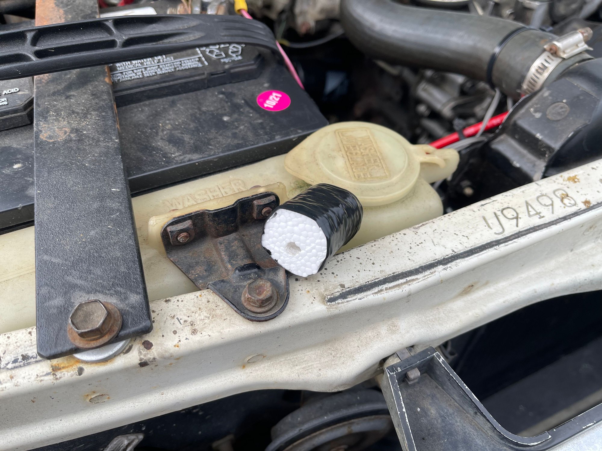

Here’s what I’ve got, for now. Maybe a little janky, I don’t care. We’ll see if it works. Should help isolate the sensor from the outside air and hopefully get a much better of just the rad temp.
Piece of styrofoam to insulate the temp probe.
Installed
We’ll see how this goes.

A little update on this. I think I was jumping to conclusions. I live a mile from work and do very little driving more than that. I give it time to get warm in the mornings but, it almost never gets warm for long. I know that's not real great for engines. The other day, I had to run to few different places in town. It warmed up, dash temp sensor rose above 3/4 but not into the red then cooled quickly, When I got back home, I could hear the fan kick on. I think the entire system needs to get warm and the fan will work as normal. It seems like the initial heating up needs to get pretty warm before the sensor gets hot enough to trip the fan. After the initial heating up, when it seems it gets towards the hotter end, the fan kicks on and it never get's that warm again, even when the fan cycles off. Seems everything is good to go. I do think my insulation of the end of the sensor helped. Anyways, thanks for the help.
