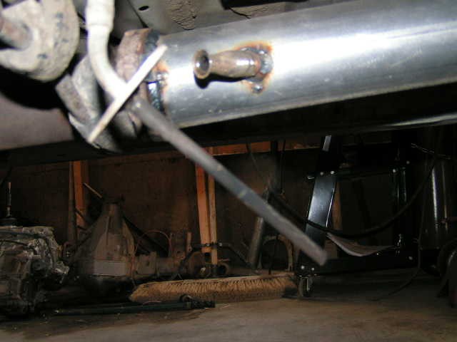

I Live In Nebraska And Need To Replace All Of The Exhaust Its All Rusted Out. I Dont Want To Spend Much On It Now, Just Enough To Make It Through Winter. I Have A 2001 Tacoma 3.4l To Put In It Closer To Spring Time And Am Planing On Using Most Of The Exhaust Off The Tacoma.

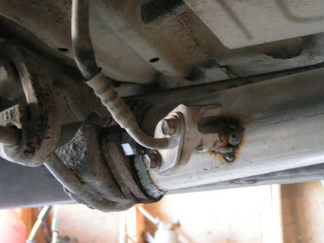

Here Is A Couple Of Pictures. I Went Ahead And Cut The Flanges Off The Cat And Welded In Peice Of 2.5 Inch Pipe The Same Length As The Cat Into Its Place. Then Cut The Sensor Mount Off The Cat And Welded It At An Angle Into The Pipe. The Sensor Or Probe Is About 3.5 Inches Long Nothing I Have Ever Seen.then Used The Muffler Off The Tacoma I Am Parting Out Cut Pipe To Length And Welded The Flange On. Bolted It All Together And Good To Go Till Spring

Old Oct 27, 2008 | 04:57 PM
XtraSlow_XtraCab's Avatar
Joined: Apr 2007
Posts: 661
From: Wackoville, California
That my friend, is a test tube (not the laboratory kind). Its an old way of determining whether or not your catalytic converter is the specific reason a car doesn't pass smog. I also have one of those on my truck; regardless of horsepower gains if I only use my cat one month out of two years... I'll die of old age before it wears out

You get an attaboy for that nice job on the probe. I'm sure that would pass most state mandated inspections.
I believe that's a thermal probe. I even believe that my '78 Federal no-Cat PU has one (but's too late to go look...). Again, I believe, the exhaust temp was input to the primitive brain; which only had control of the Air Injection solenoid. And, it worked as a safeguard - if a threshold temp was reached, the Air Injection was defeated. I have a hunch that CA BAR doesn't even perceive it as Smog Related Equipment. (Any techs out there?)
