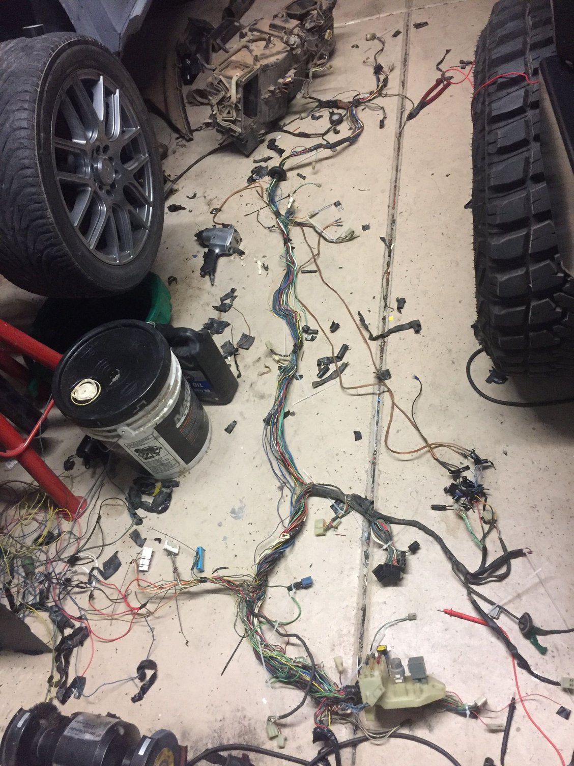

A lot has happened since my last post. I removed the broken brown dash and replaced it with a clean (for the most part) grey dash. While I had the dash out, I removed all the wiring and cut-out the dead wires. I think I may have removed one wire for the A/C. Unfortunately the pictures are on my old dead phone. All this occurred last summer.

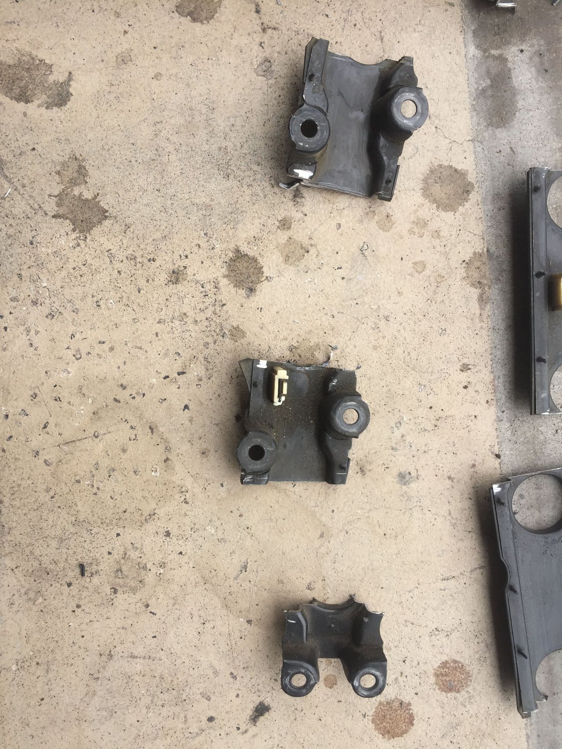

I found some of the pictures!

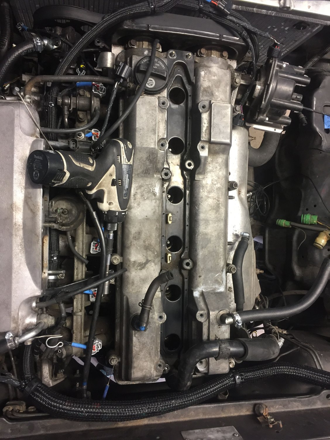

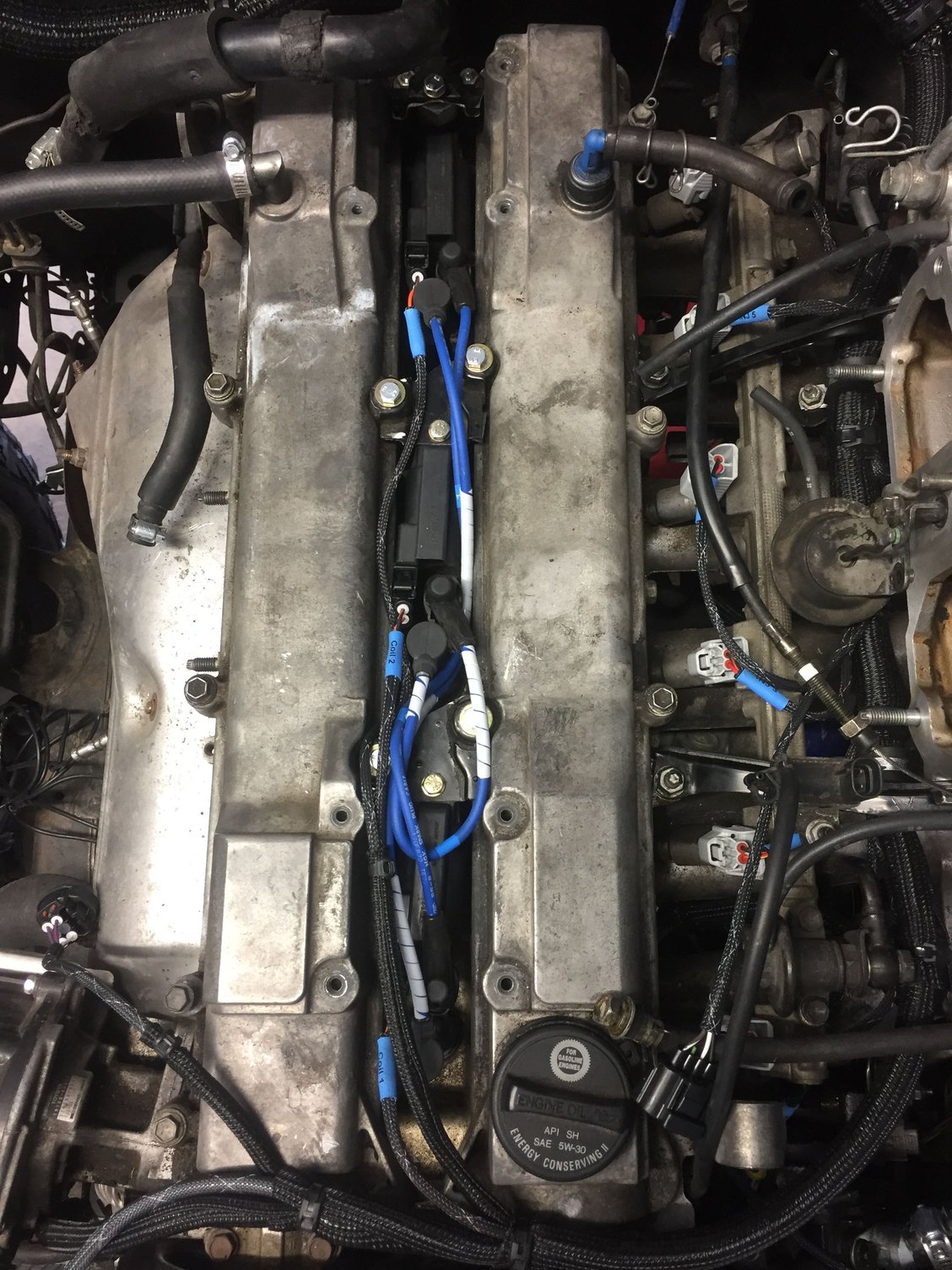

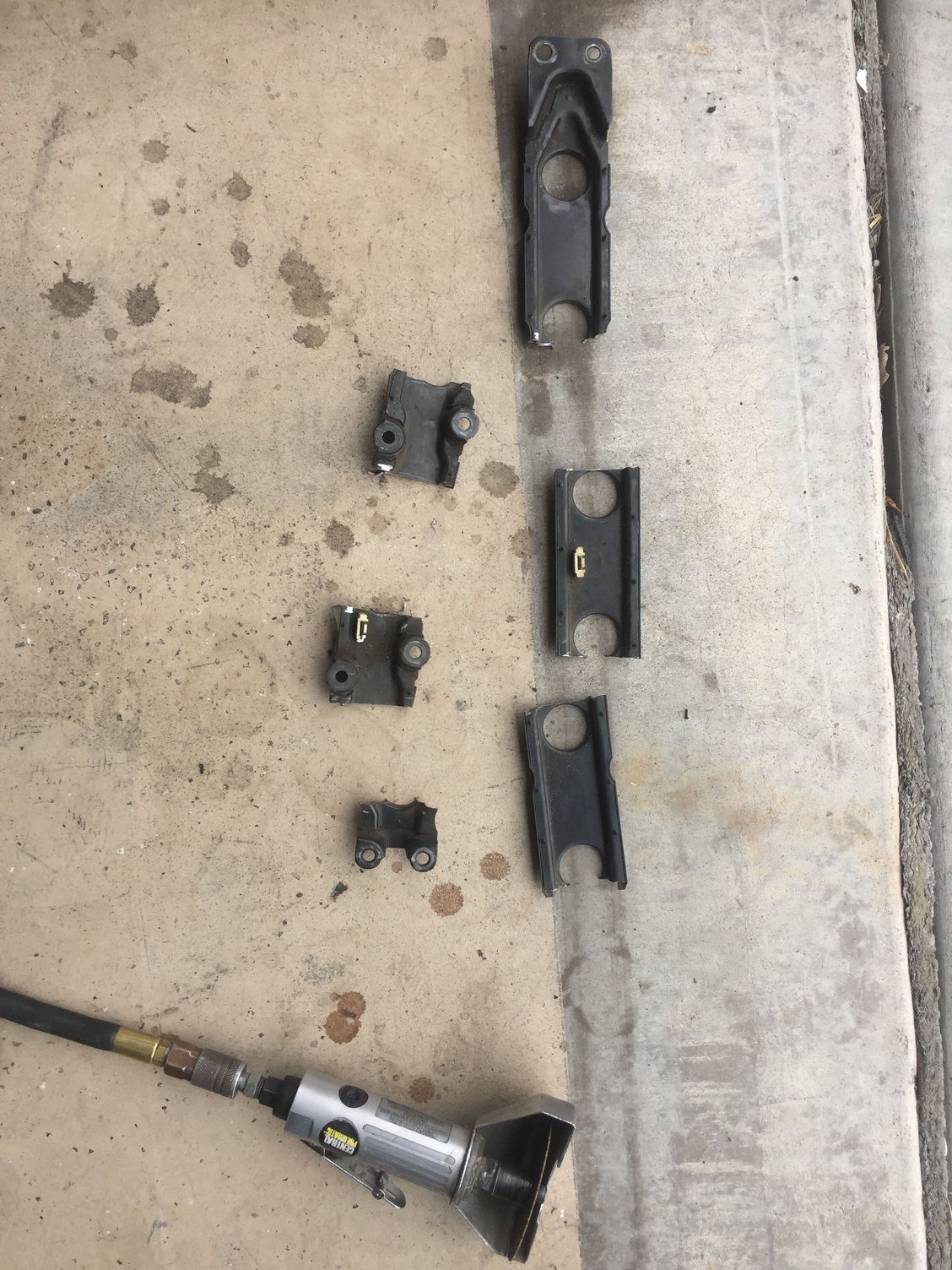

Below are the pictures from the factory spark-plug wires to the IS-300 wasted spark conversion. I removed the factory bracket and used it to create brackets to the coil-packs.

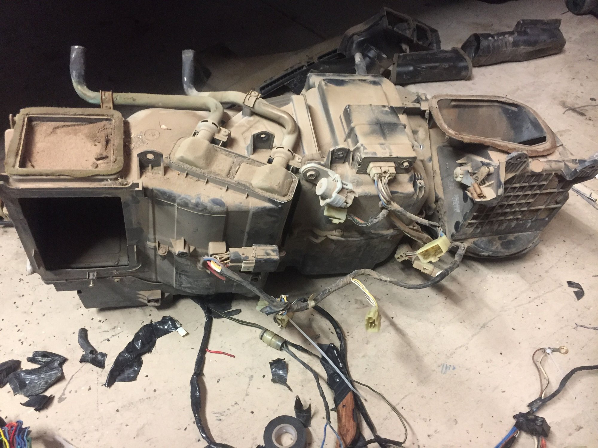

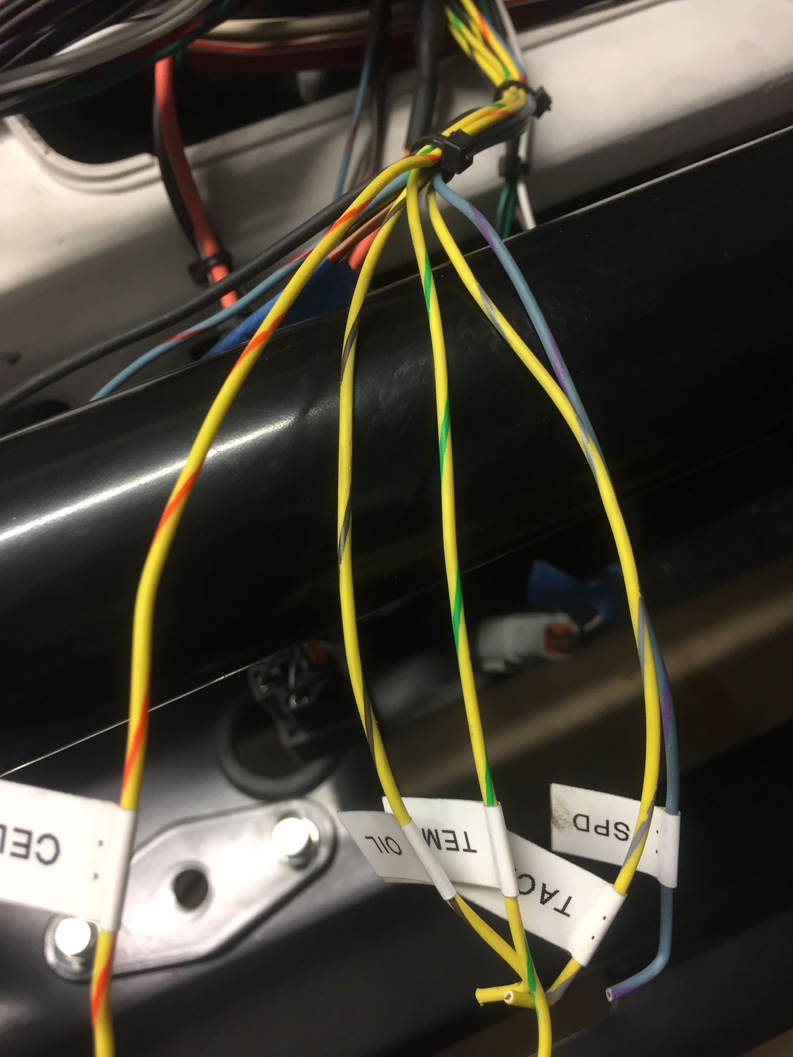

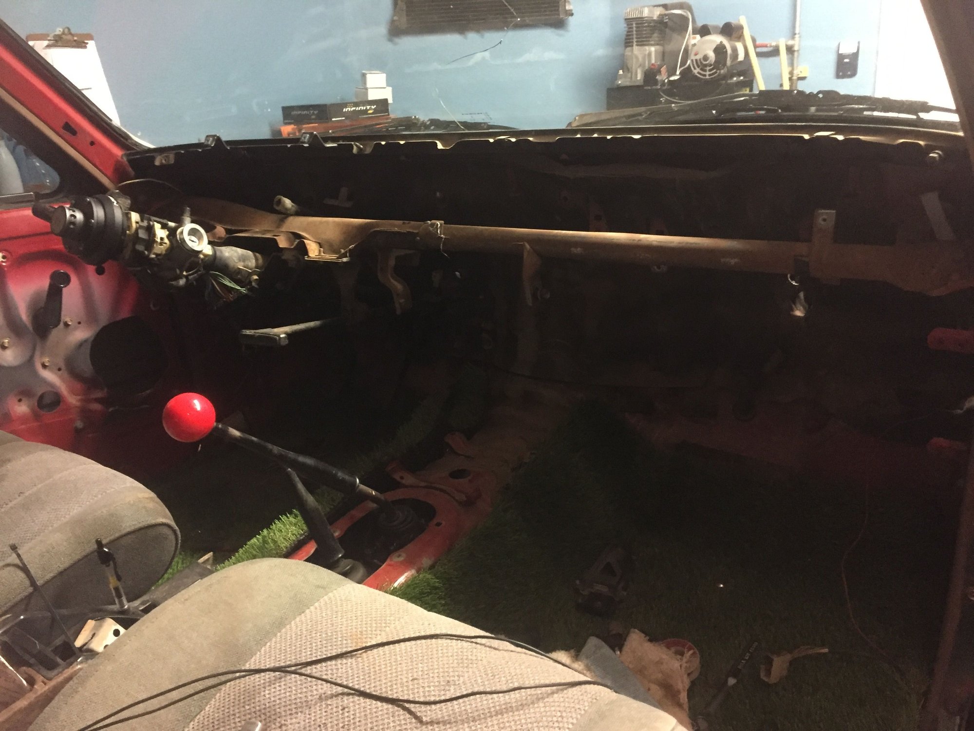

As I mentioned before, I found a "clean" grey dash and interior pieces. I removed the old dash and cut out the unused wires. I also removed the heater core and AC evaporator. Currently they have not been replaced so no AC or Heat. In Arizona, the heater is not as much of a concern but it would be nice to get that AC working. I also labeled the gauges and turn signals.
Pics of the new dash coming soon.

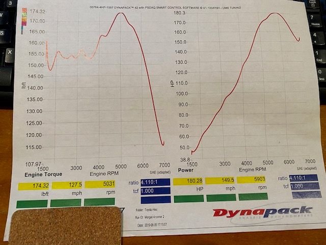

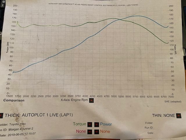

I'm not sure what the power gains are of the 3RZ over the 2JZ but here are my dyno results at the rear wheels when the ECU was tuned. 180hp @ 5900 rpm & 174 lbft of torque @ 5000 rpm.

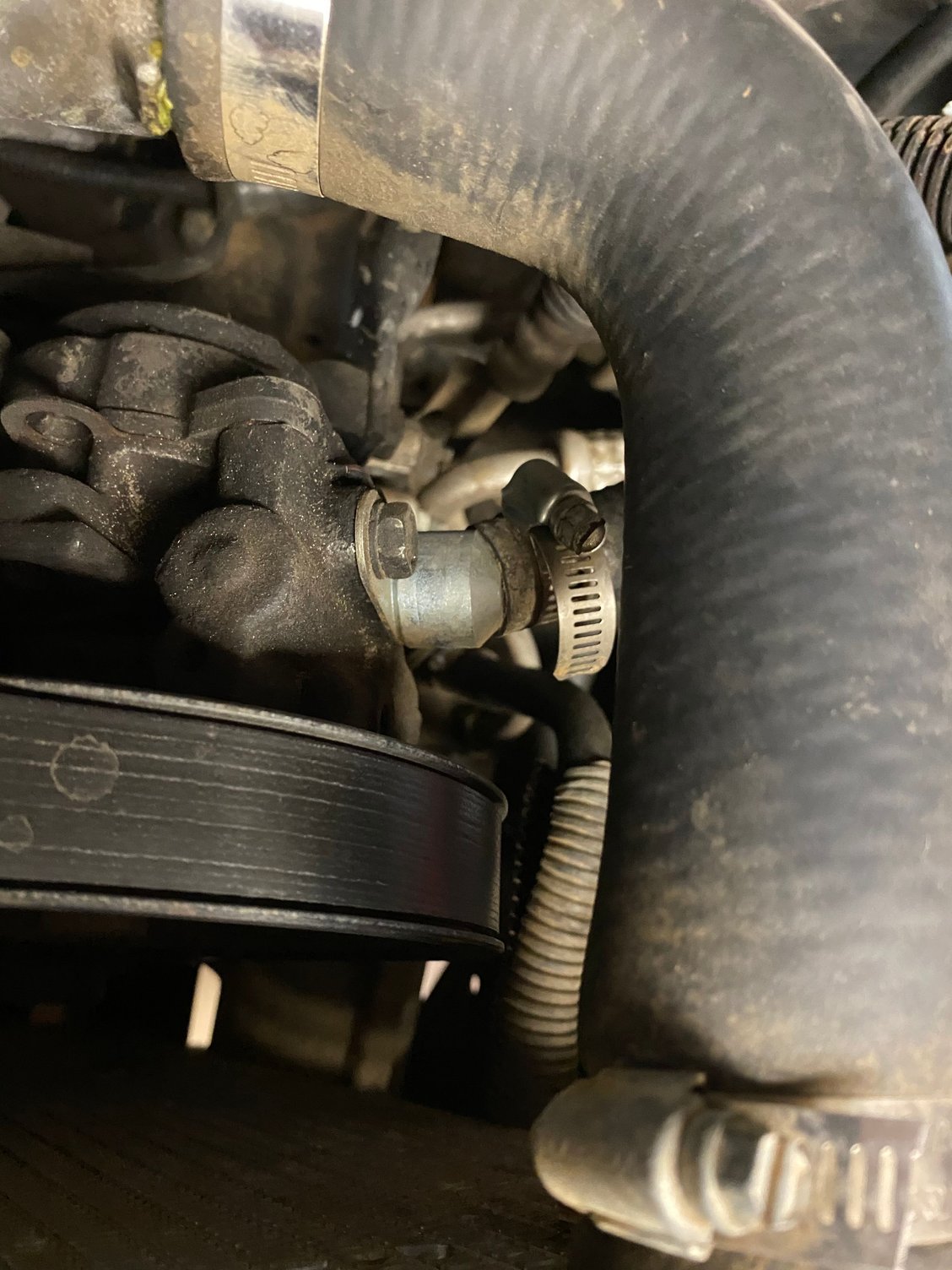

This is for a member who asked me about the some hurdles during the swap and wanted to post the pics for everyone's viewing pleasure.

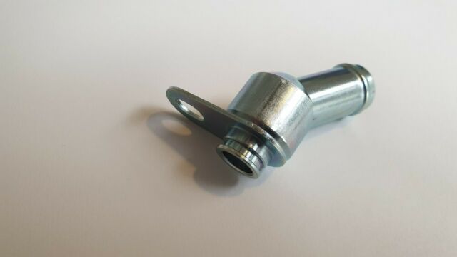

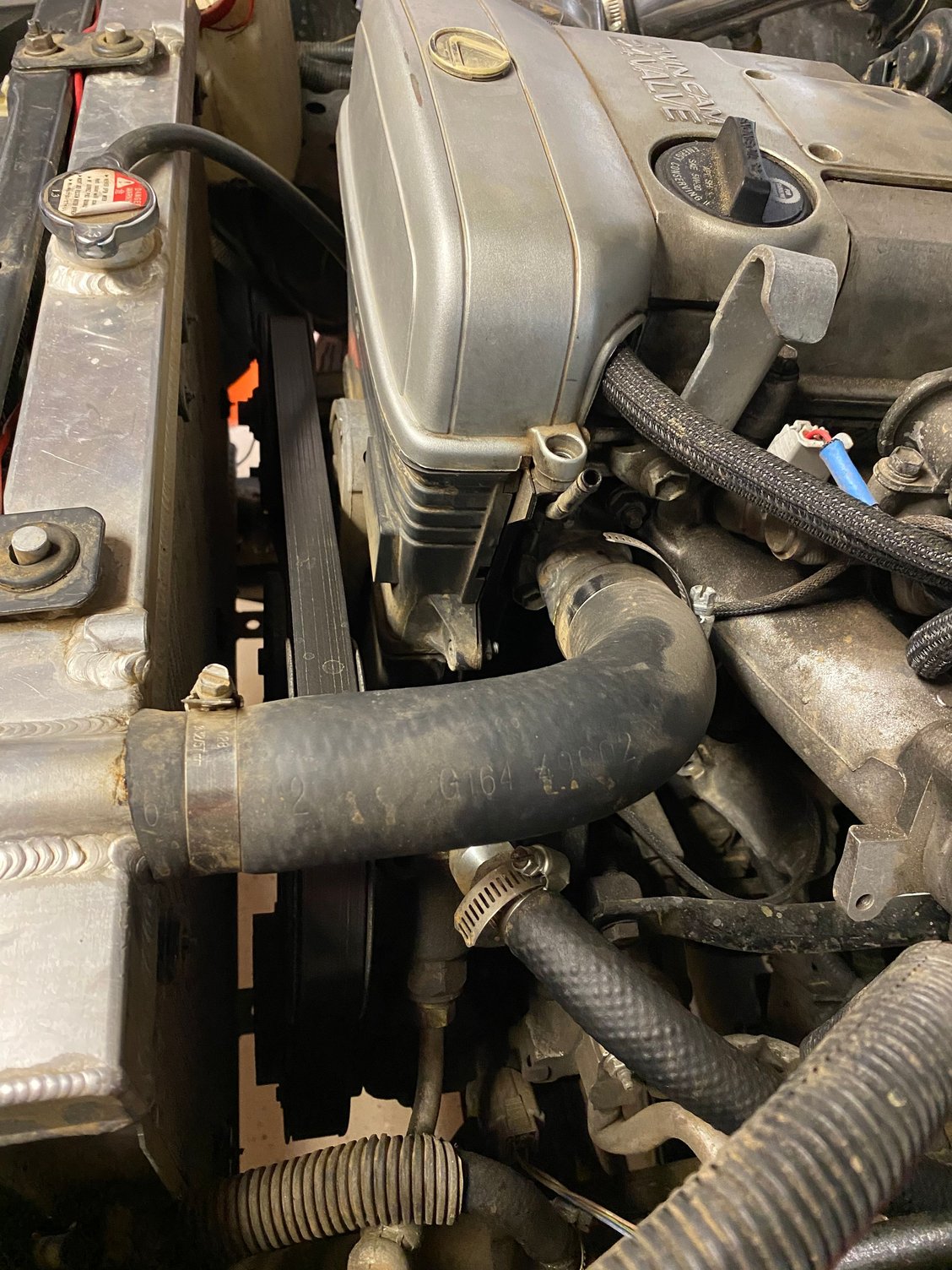

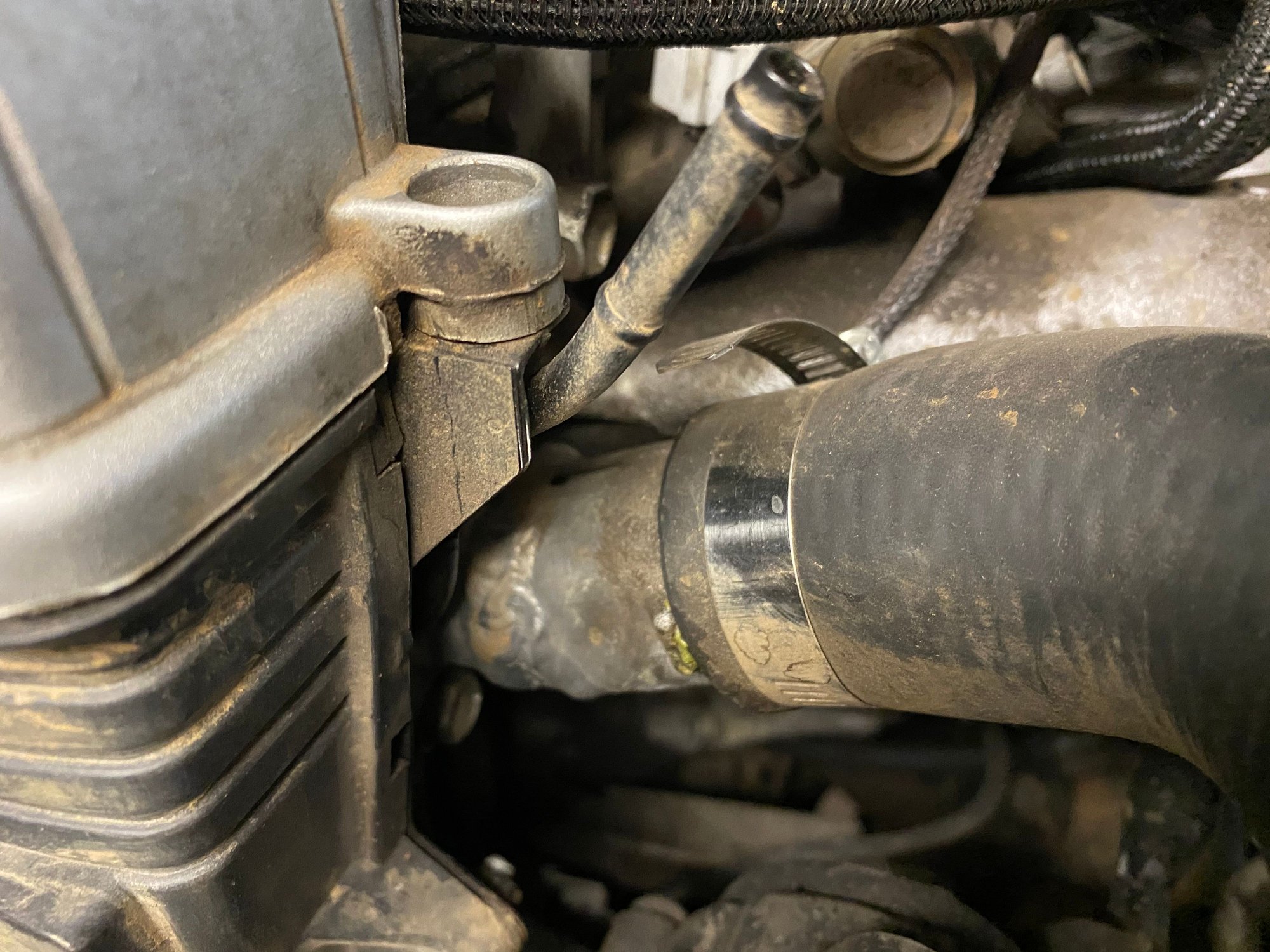

One issue I noticed during the build was how close the thermostat housing was to the radiator (see post #23). To correct this, I removed the 2jz factory power steering pump reservoir and installed a suction union joint. With this installed, I was able to reuse the 4runners factory power steering reservoir.
image courtesy of ebay.com
Then I had the thermostat housing modified to exit the straight out of the block which allows for a 90 degree hose to be used.

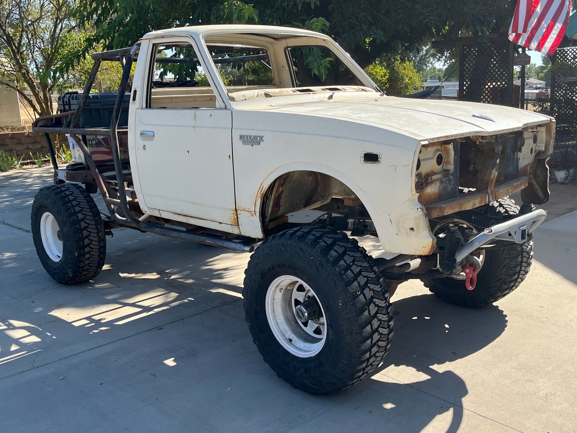

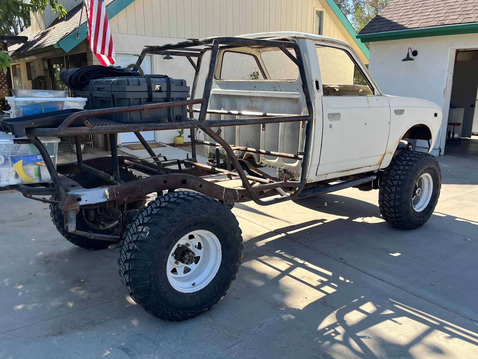

Here’s my new project. It’s a 1972 hilux (pre-smog!) that I’m putting on a 1980 frame. I’ll do another build of this one once I have more content.
