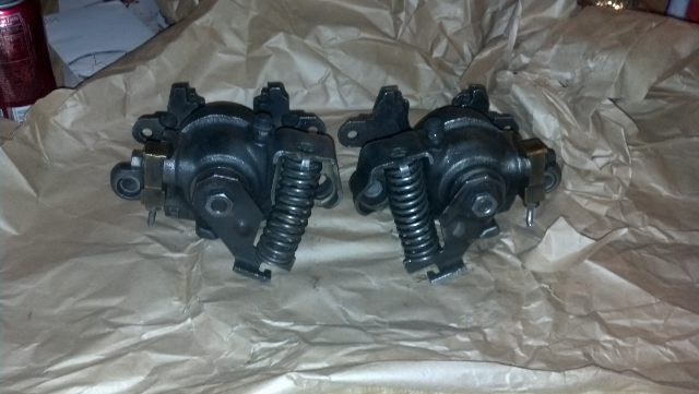

While driving to and from work today, i noticed the brakes are really soft, so i bumped up my plans for the rear disc brake conversation a little early, since i would have to do some brake work anyway for inspection. I'm going to be using sky manufacturing's brackets, rotors and lines. Since its required in the state of NH to have a mechanical e-brake, I've sourced a pair of '79 El Dorado rear calipers (pictured here, they arrived in the mail today) with the e-brake attachments. I'll add photos as the parts come in and the build progresses
