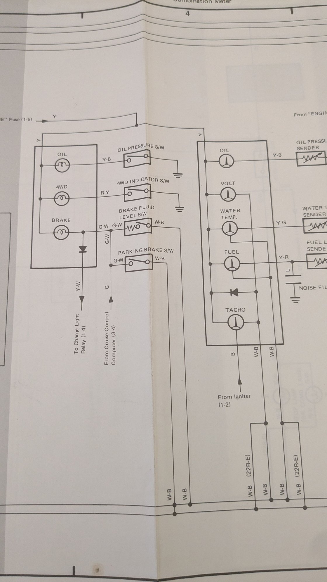

yes .. there is a bulb/indicator as you found ... here is a schematic . red w/Yellow stripe wire .
If you have a power probe , just put 12V to the wire you found and if the light on the dash lights up .. thats the wire !

Solved! Looking at the wiring diagram did nothing, all it told me was the wire leaving the transfer case was red w yellow. I ended up finding a pin out diagram of the ECU. That led me to the same red w yellow wire. I followed the ECU red w yellow wire to a small connector near the ECU, at that connector the wire changed to light green (mint green) and went to engine bay. I found the light green wire in the harness under the intake manifold. It was cut with no connectors, and buried in the harness, likey a sin from a previous owner. I connected the light green wire to the red w yellow from the transfer case and my 4x4 dash light works.
