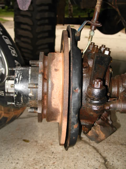

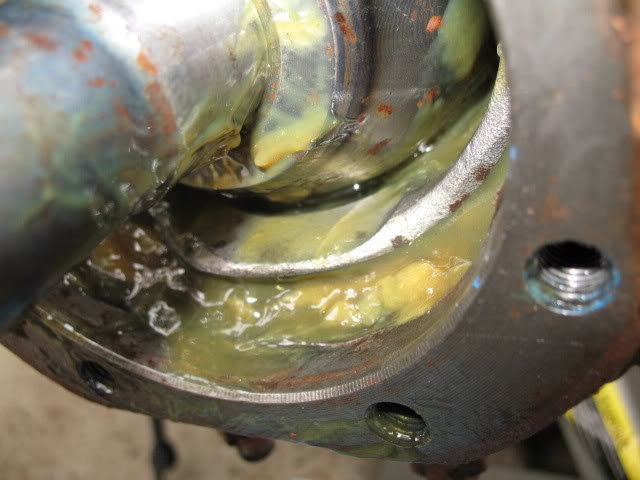

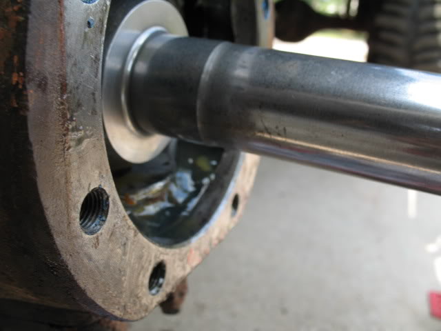

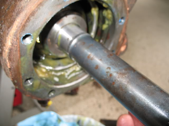

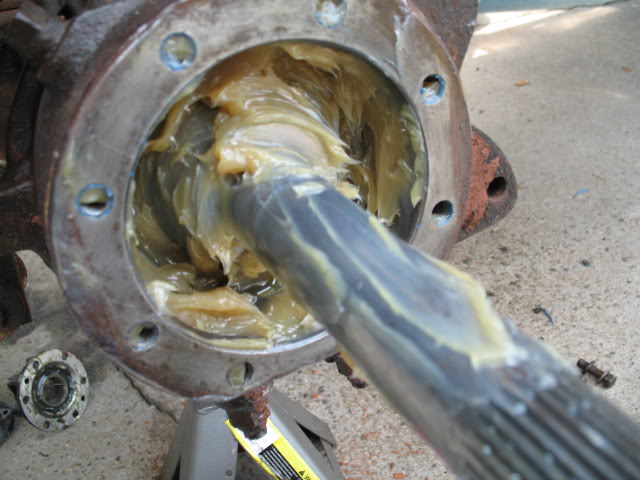

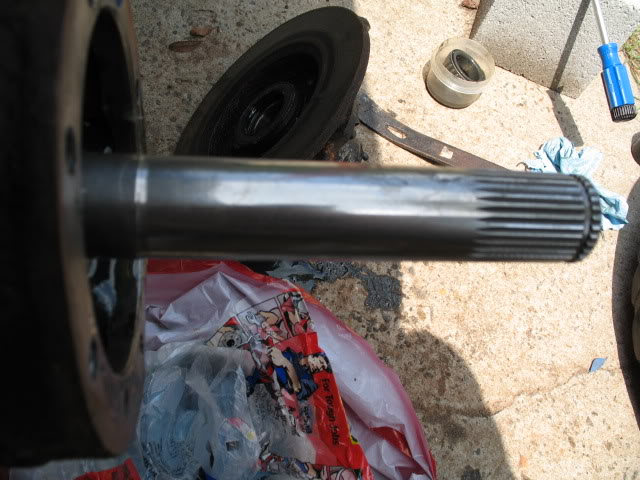

OK I pulled the other side & I am convinced I have the birf all the way in. The only thing it could be is I haven't positioned the dust cover correctly, the bearing isn't lining up or I didn't set the axle into the birf all the way.
Here's the cover on the one that won't go back together:
This is the way the other side looked before I pulled it:

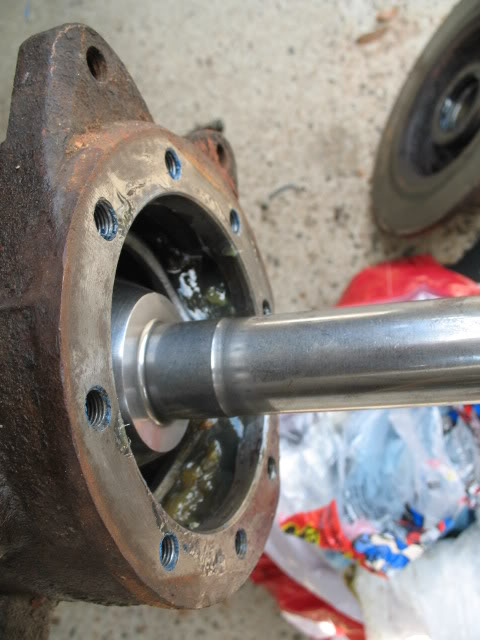

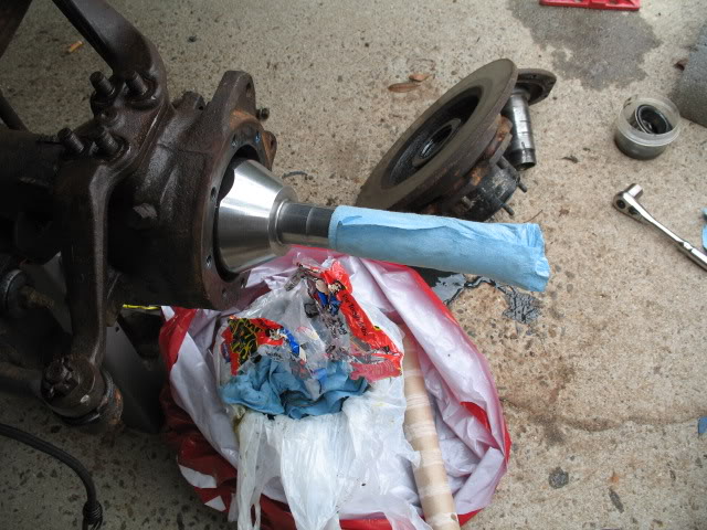

So I pulled the long side:
And changed the inner seal. Then made sure the new axle was seated in the birf by pounding the crap out of it
Got it in this far & it stuck:
loosened the 3rd member bolts, jacked that side way up high & jiggled the diveshaft & pushed in on the birf & it popped in. It felt & looked exactly like the stock one did before I took it out:

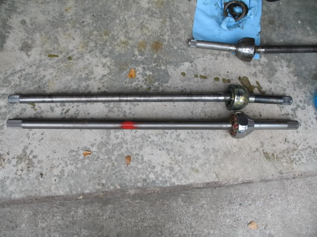

Stock:
New:
So I am pretty sure this one is in there as well...
Obvious difference in those pictures that something isn't seating right, whether it is a bearing or a seal would be my first guess if you are sure the birfs are in right. Compare the d-side to that passenger side as to the order, seating of the bearings and seals etc.
Just think of all this in this manner...if you ever have to R/R another one, you won't have to look at an FSM again.

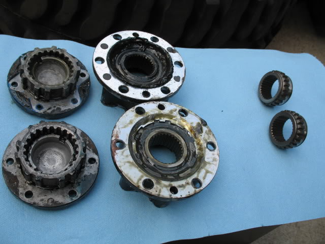

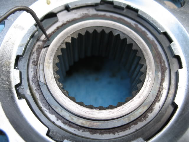

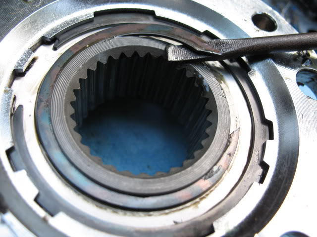

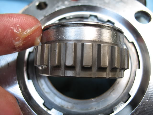

Theen it was on to changing out my hub gears with the 4340 chromoly inners from Longfield:
Pretty simple, but the clips can be a pain. I used a screwdriver & a tool I found at Napa.

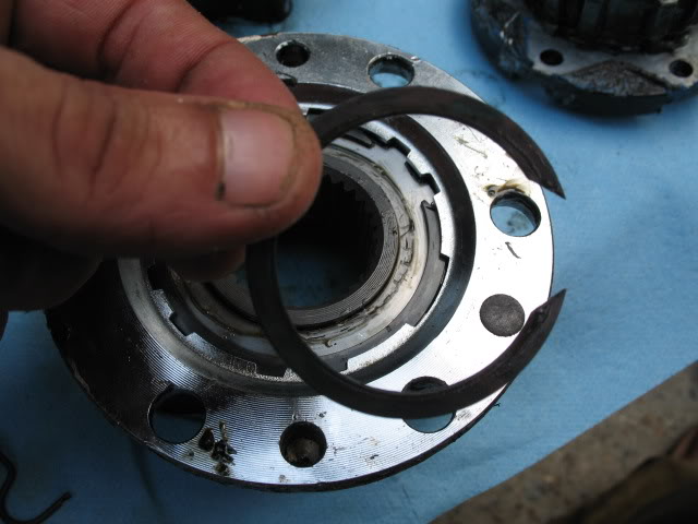

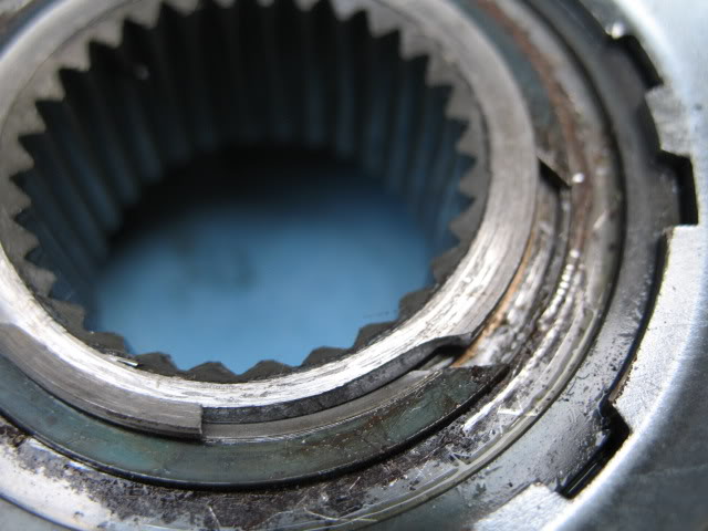

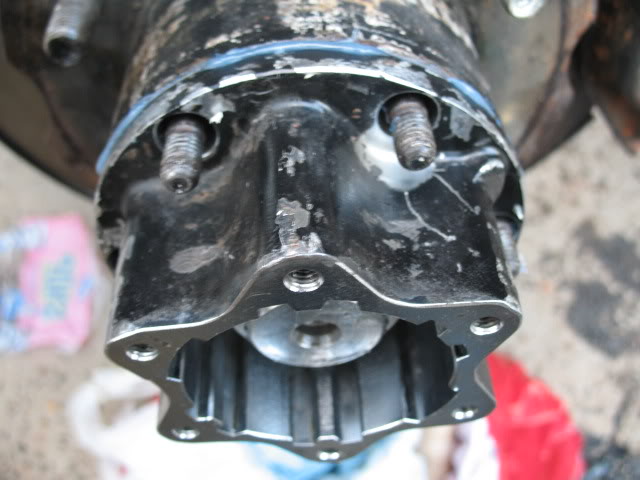

Flip the hubs over & remove this clip:
Don't do this in the process:
Get under the clip & pop it off:

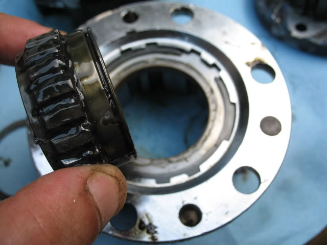

Then the hub gear will come out:

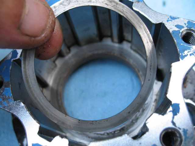

Clean the whole hub up & grease & install the new hub gear:

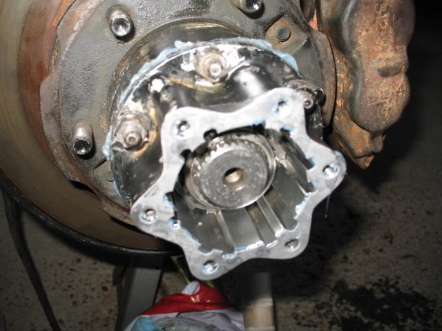

There is a metal spacer between the hub gear & hub body, don't lose it:
If you have trouble getting the clips off, a BFH will work. The old hub gear will break & you can remove it:

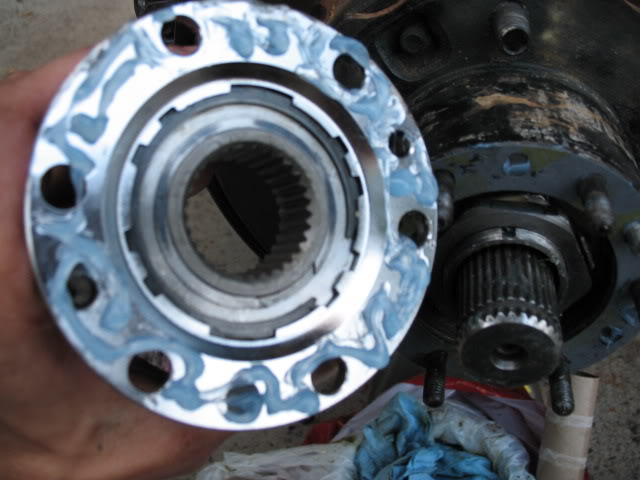

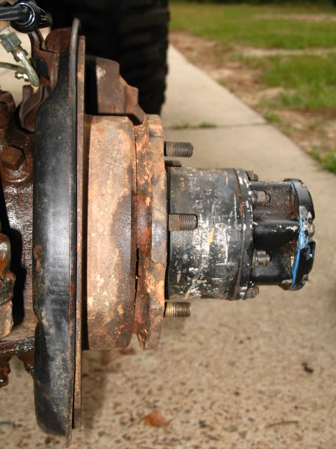

Once the new hub gears are in install the hub with sealant:
Put the clip back on:
Cone washers:

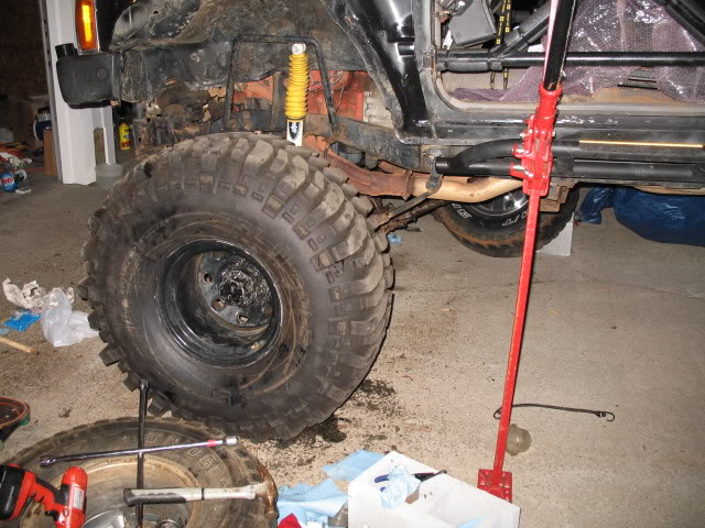

Wheel & tire:

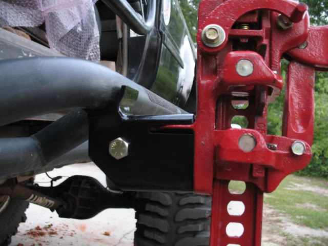

Buy one of these adapters from Wabbit if you haven't already. They make lifting the truck easier & safer:

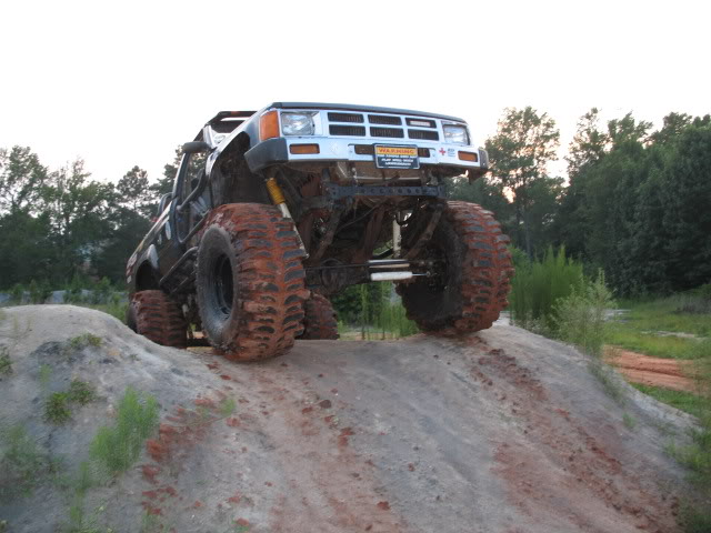

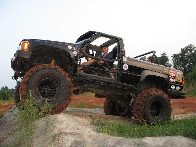

Newest member of the 30 spline Longfield club:
Testing. Yep they work.
I let Tyler drive because I'm the coolest Uncle on the planet according to him :
