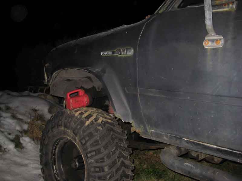

So I went and looked at the truck again. Unfortunately we didn’t get there until it was dark, but the flash was nice!
I took some pictures to help you help me. Now the draglink, is that suppose to be bent? Or is that just jerry-rigged? Also do you need that arm from the front axle housing to the frame?

Looks like a dropped drag link (after market). Sway bar should not affect steering, but the missing torque rod (from the axle bracket to the frame up front) can, at least under braking. If nothing outside looks to be binding, then it is something internal.
Looking the picture of the truck it looks to me like the truck might have been lacking some maintance in it past. Worn components (tie rods, TR ends, bad wheel bearings, out of balance tires etc) can contribute to poor steering)
