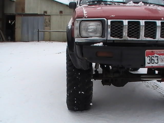

Put my spacer on today! I think my lugs need to be longer though. I can only get about 1/2" of threads on the lugs when I put the spacer on and I would like the lugs to be about 1/2" longer. Any ideas on where to get longer lugs. I think the stock ones are 44 mm long.
Before Spacers
After Spacers

Do your wheel spacers bolt on to the hub with supplied nuts or do they just slide over your existing lugnuts effectively shortening the usuable threads. If they slide on I would toss them in the trash. There will be too much stress on the lug nuts and I would be worried about losing a wheel. Constant re-torquing will be required. Only use a spacer that mounts to your hub (on your original lug studs) and holds your wheel to the spacer with is own set of lugnuts. That would mean 12 lugnuts per wheel. 6 holding the spacer to your hub and 6 holding your wheel to the spacer
