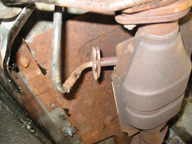

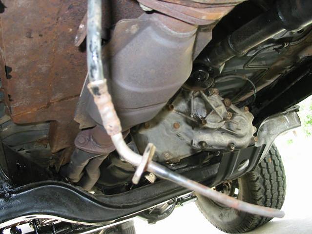

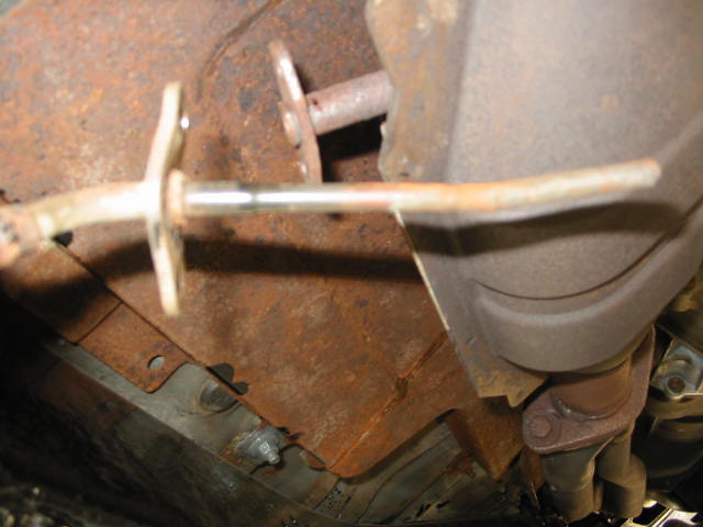

so I crawled under the truck and took some pics. Anybody know how important this is? Apparently it's not working and is not available from Toyota. Is there a work-around for it?

looks like you could shove it back in and used two bolts in the 2 holes in the flange to hold it together. is it preventing you from Passing emissions/

x2 emissions garbage, probably air injection to burn any fuel in the exhaust

Yep, what Slisdexia said. It's an air tube to "flush" out the exhaust system.

I bet its a carbed cali rig and thats a exhaust temp probe for the emissions computer they put on california models

I'm not sure how important it is, but the smog requirements in CA keep getting tougher so I want to be sure everything is working. How sophisticated is the ECU on this truck?

Dipstick to check condensation in exh. system
