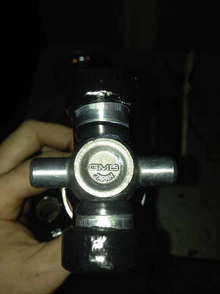

Toyota PN is 04371-10011, Beck Arnley 1020288 (but stamped GMB...). Also used in the driveshaft of 68-79 Corollas. RockAuto has them but they're in the Drivetrain section along with the other U-joints, not the Steering section.

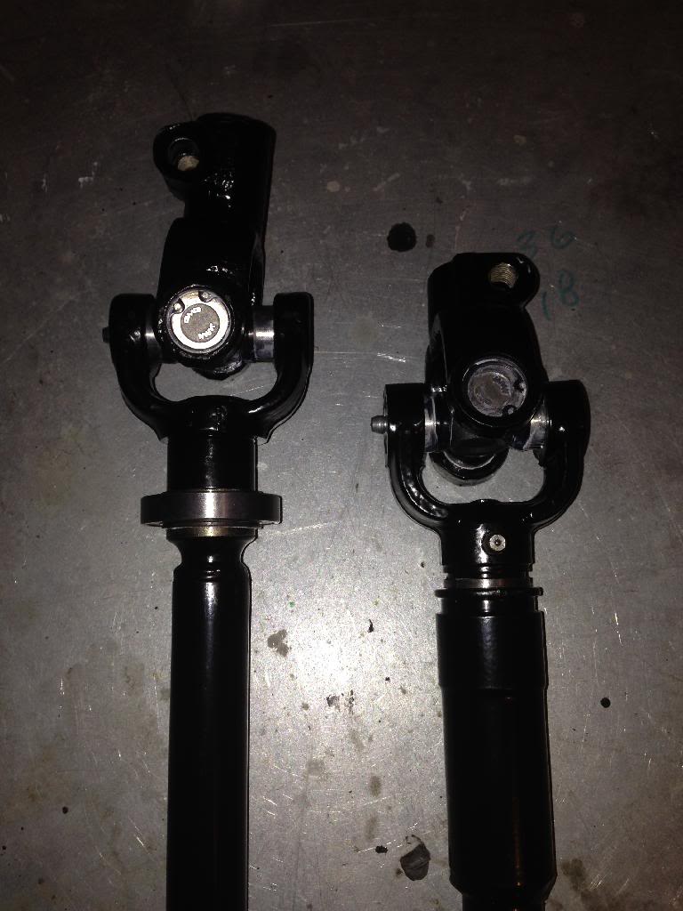

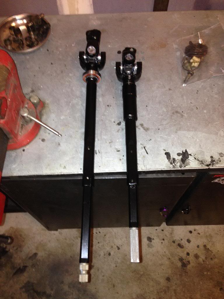

Google the part number with Beck Arnley, GMB or Toyota and I'm sure you'll stumble across somebody that has them in stock. You'll need two of them for the portion of the steering shaft that runs through the engine compartment. There is a third one up inside of the steering column that is different (I believe it is only in the tilt columns). I wasn't able to find that one, but it doesn't receive as much wear as the other two.
Here are some shots of mine:
