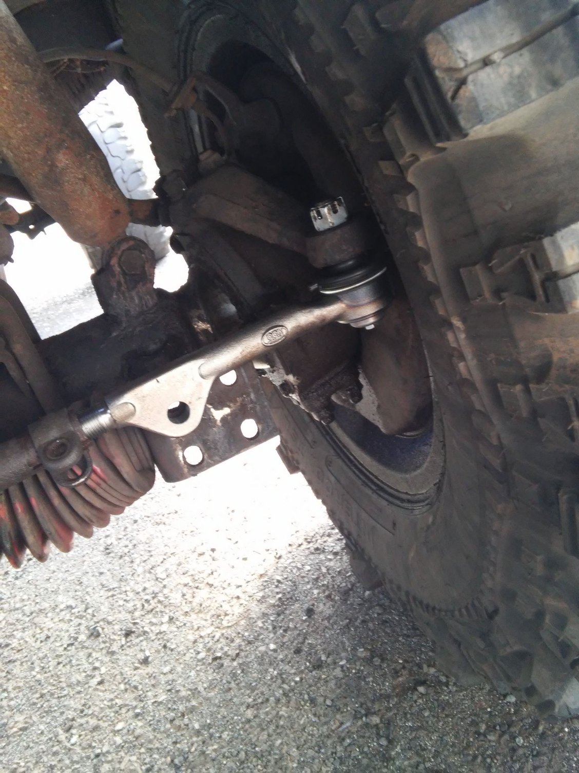

My project this weekend was to change out my worn, blown, completely destroyed tie rod ends on my 83 4x4. I was experiencing wobble, steering wheel play and the clunky noise of my tie rod moving around.
I chose Moog problem solver greasable tie rod ends. Product numbers #es2366 and #es2376. Purchased from Amazon at $47 shipped.
In my opinion very high quality parts. Stamped made in japan. I thought Moog was in India but maybe the bearings are Japanese. In any case I dig it.
Swap out was easy even though it was my first time doing it. You tube videos rock. What a difference it made. No wobble, shimmy, steering play or noise of any kind now. $47 well spent.
Moog #es2366
Moog #es2376
Next project....knuckle rebuild and front axle service as you can see my knuckle is bleeeeeeeding oil. Lol
