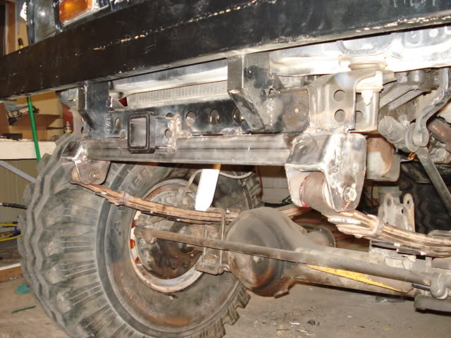

here are my springs
Old Nov 28, 2008 | 08:51 AM
4x4YOTA's Avatar
Joined: Oct 2007
Posts: 1,308
From: colorado
what about using YJ leafs up front will that work?
Old Nov 28, 2008 | 02:13 PM
oldgold3vze's Avatar
Joined: Jan 2008
Posts: 341
From: Loveland, CO
You could just get some random leaf packs that are 2 1/2" wide and start adding to your stock pack, sure. It'll probably help with the lift, but I'm sure it'll ride pretty stiff. I see you already have some pretty long shackles, so those would probably work better with a more arched leaf pack. Just start experimenting, it's way more fun than surfing the forums all day to see what other people have done.

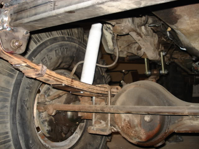

Here's my rears up front...
40s with lots of trimming, probably 5-6" lft.

Spring pack from top to bottom:
-1980 rear
-1980 rear
-trimmed down 89 pick up rear
-1980 rear with clamp
-trimmed down 89
-trimmed down 89
The 1980 rear leaves have way more un weighted arch than the 84-89. My first rears up front pack used the main leaves from an 88 4runner, and I got about 2" less lift, but it was only a 5 leaf pack.
Rears are chevys with a 6" shackle and an (ahem) 1" block. The bed of the truck sits 100% perfectly level, that's part of the reason I used the block, plus my u-bolts had about 1" of exposed threads, and I'm trying to make sure those 40s don't rub.
