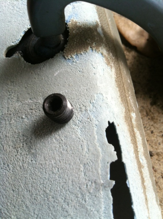

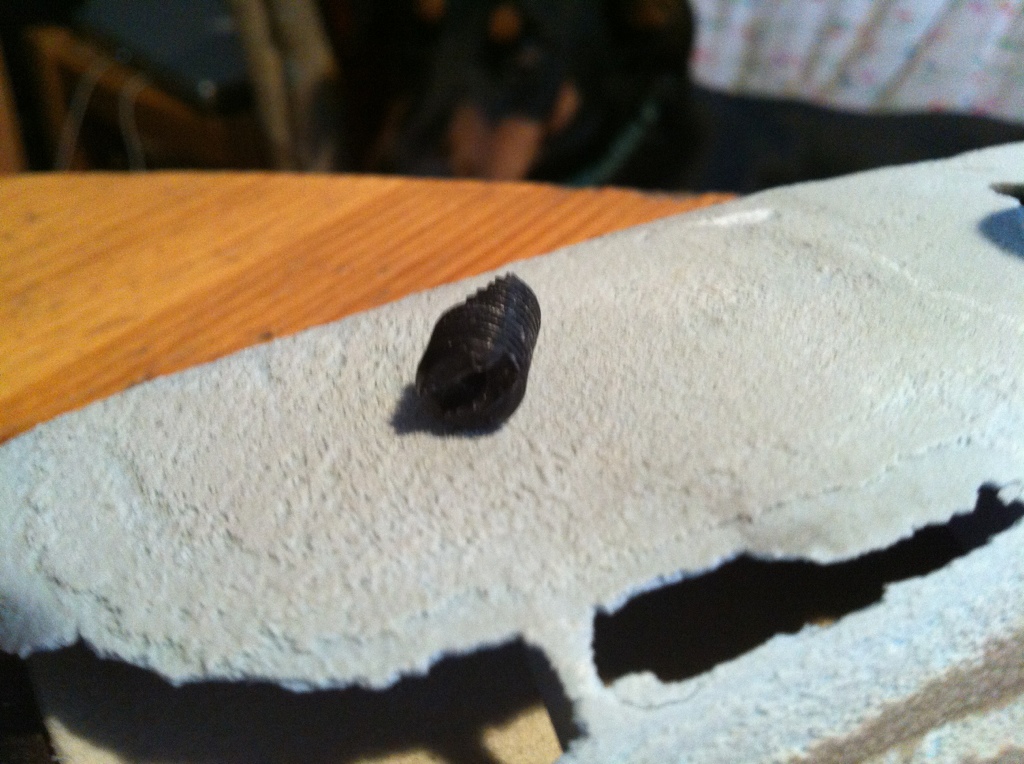

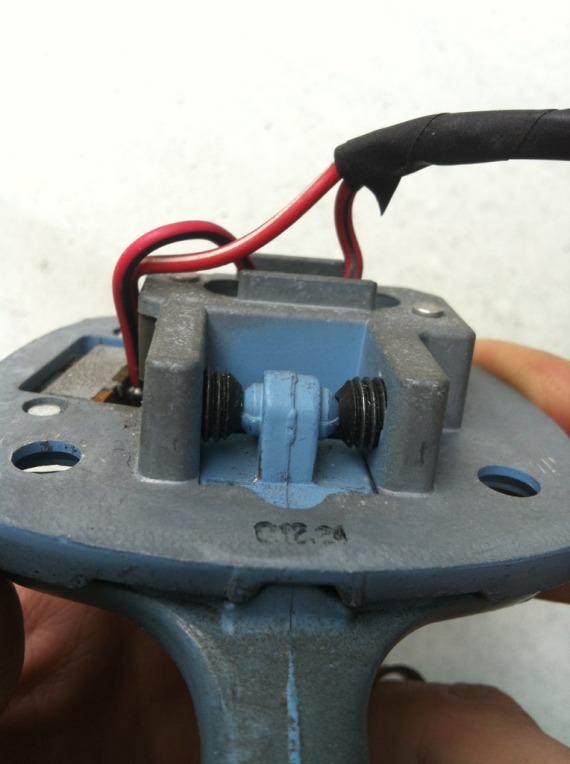

So the other day I was loading a very large box into the passenger seat and accidentally bumped the rear view mirror. I Knocked it out of its bracket and the little internal plastic screw broke. Super brittle and frustrating. I'd like to find a replacement part or just the little screws as everything else is fine. I don't want to JB weld it if I don't HAVE to.

got your PM and replied .. sorry i though you were talkin about the outer mirror .
anyhoo 87827-12020 is what your lookin' for

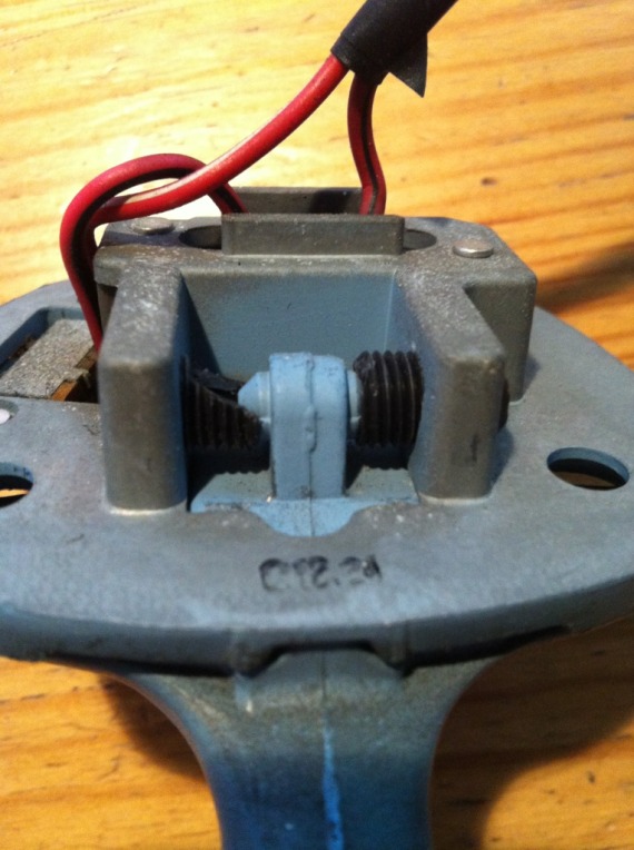

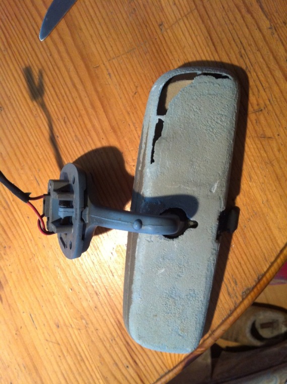

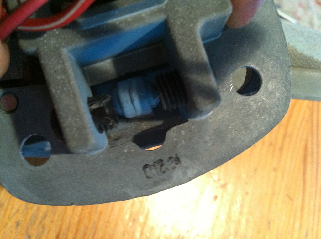

Thanks, now to find a source haha can't imagine most dealers can even get that individual part
more pics for just for clarification
yes my mirror has been eaten by the sun. That's why the part was so fragile.

Do you know anybody with a lathe?
Old 03-22-2013, 08:56 AM
SCToy's Avatar
Join Date: Oct 2009
Location: Santa Cruz, CA
Posts: 1,560
Received 1 Like on 1 Post
yea, I have some access to a lathe. I may have to get the correct threaded bolt and make some replacements. Could cut the head off, hollow out the tip and give it a slot to turn with a flat headed screw driver. Wouldn't be the end of the world.

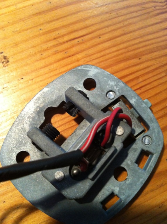

I found these screws at Ace Hardware, they were technically standard fine threads, I believe 5/16. I'm Forgetting that at the moment. They threaded in, a little bit tight, but it worked. They should be M8x1.0, but they didn't have this style screw with those threads, only coarse.
$1.08 to fix it and I replaced both the screws since they are metal.
