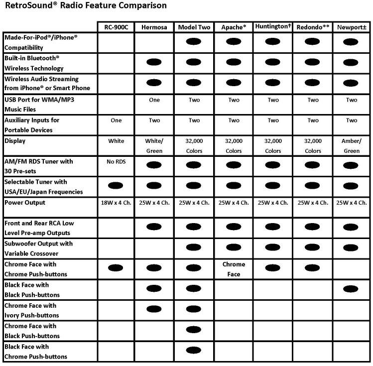

Damn, they must have changed it since you bought yours.. there is no such model anymore, only for Pontiac "Firebird" (checked both summit, Jegs & retrosound.com) I do see the button options available (40-80, but the 215 is no where to be found)
Also all the radios i see sell with the adapter plates.?
Is there a specific model of receiver, that comes without adapter plate & buttons.?
The retro sound website doesn't show anything else, just the "Model 2" or the "900C" (or the obvious wrong ones.. Apache, etc)
Also, looks like the main difference between yours and the 900C is 18x4 watts instead of 25x4, which if you're gonna use an amp wont matter.. IF that is the only major difference.
This is definitely the way to go, just takes some searching to put it all together.

They don't make the Zuma anymore, but the Model Two and the RC-900 Radios are the same thing dimensionally. Then you just get the appropriate adapter plates - 115 for chrome or 215 for black. I found that the black one is not as common to find though - might want to call RetroSound

Awesome, yea i do some other differences too, the model 2 might be worth the money.
I edited my last post to add some info
