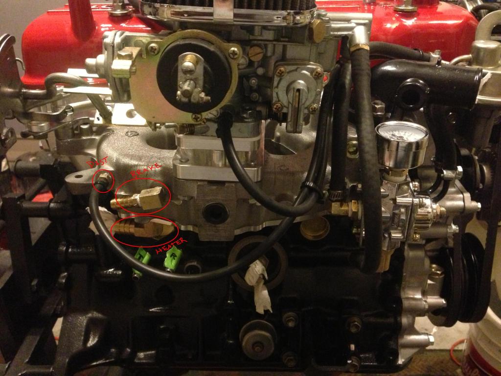

If you are looking over top of the engine, coolant runs kind of runs clockwise - basically from the lower radiator outlet on the driver side, to the water pump, through the engine, out the thermostat housing and into the upper radiator inlet on the passenger side. I think what may confuse you is that it enters the water pump and loops around the engine and the back through the thermostat.
Here is how I am running mine (keep in mind that I am 100% desmogged and everything is plated off):
-Hose from the under side of the intake manifold (LCE Intake Block Off Plate) to the heater core valve
-Hose from the heater core valve to the passenger side inlet of the heater core
-Hose from the drive side outlet of the heater core to the factory hard pipe down by the driver side engine mount.
-Hard pipe then ties directly into the radiator via radiator hose.
Here's some pictures I had from my desmog thread:
-The barb under the manifold goes to the heater core valve (circled in red, labeled "HEATER")

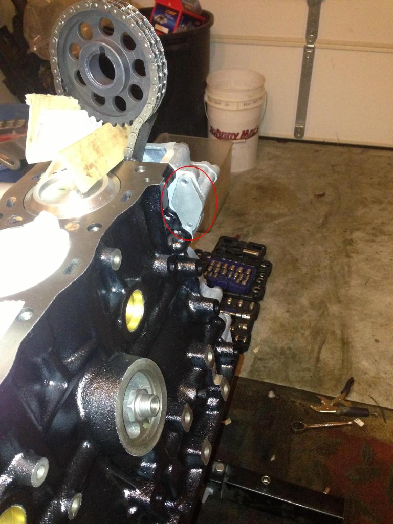

-You can also route a heater core inlet hose from the pipe that attaches here (circled) that I blocked off
