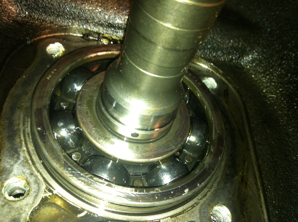

got to here, started comparing the kit bearing with the old one. Discovered they were not the same bearing, as mine definitely has a larger race. You can wiggled the input shaft by hand easily quite a lot. I can see the bearing internal race shift around. Hopefully nothing else is wrong.
Called Marlin Crawler, spoke to Zack, who helped me confirm I did in fact have an L52, not an L50. I know it's the original tranny, so I guess some 81s came with the L52. They will be replacing my kit and hopefully I will be able to get her running again soon. When you turn the input shaft by hand you can hear some nasty noises, hopefully nothing else is wrong in there. Once I get this bearing replaced, if it still sounds like that I will have to revaluate things.

is the top input bearing pressed in,or is it retained by a c-clip?

It has 2 c clips. One around the OD that prevents it from being pressed further in, one on the shaft that prevents it from slipping out. From what i can tell the bearing is a press fit on the shaft, but just slips into the housing. I need to get a 2-jaw puller to get it off the shaft.

I already removed the clips in that picture cman. I can put them where they go if you'd like to see.

nope,i get it now,it always helps to have a visual! thanx!

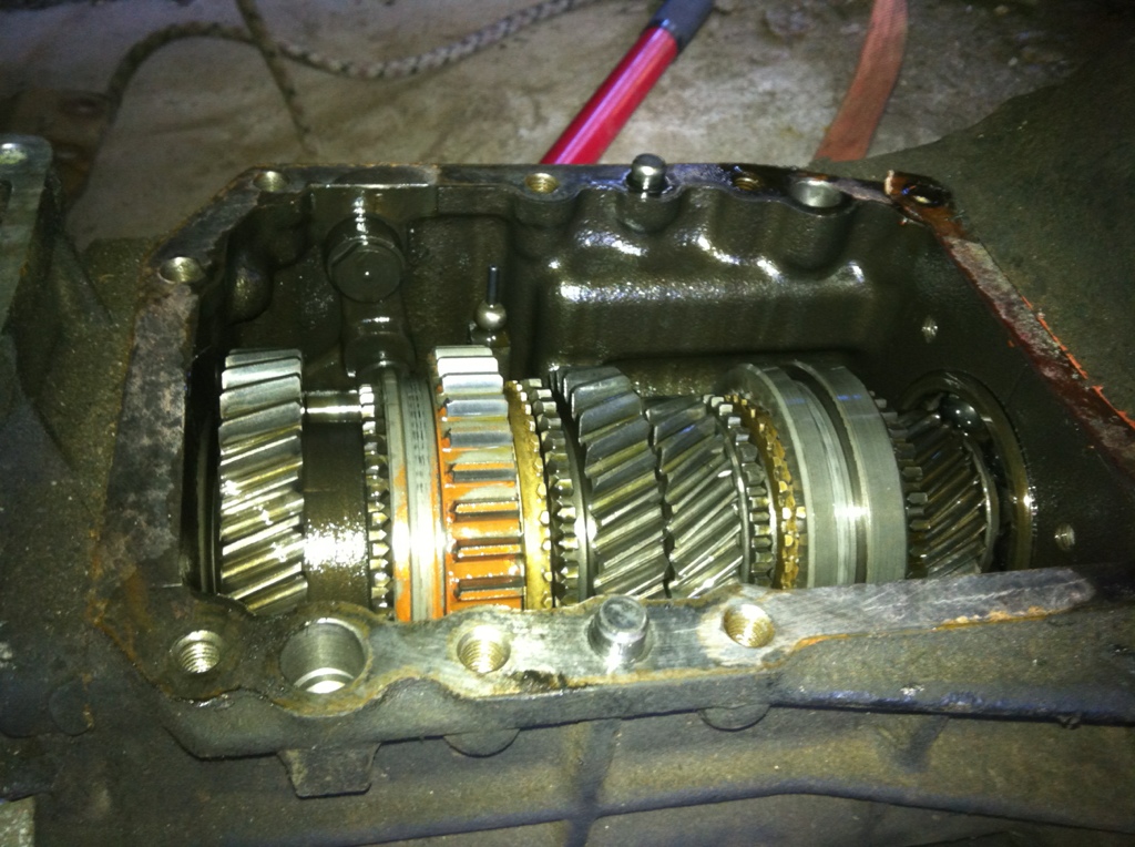

the gears and synchros look pretty good to me

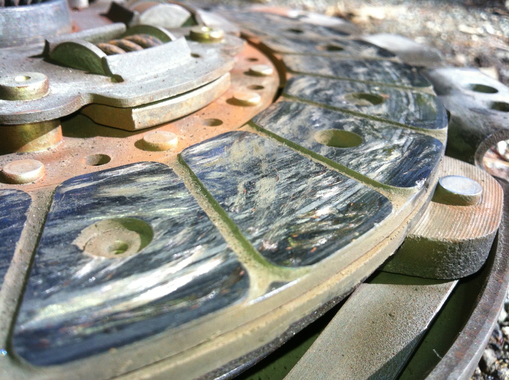

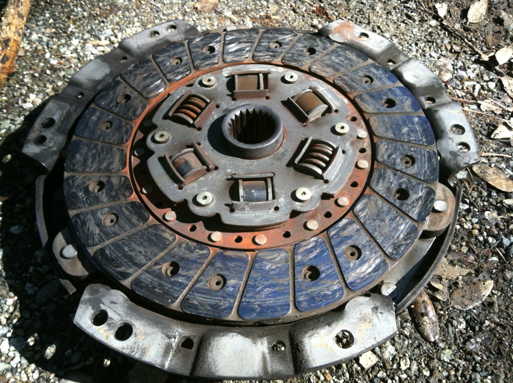

Should I replace the clutch while its out? I don't know how much meat was on it when it was new, so I am not sure where in its life span it is.

id definantly replace the clutch,ive had really good luck with marlins clutches.

I ordered a clutch kit from marlin and a new shift boot.
All the gears and syncros and gears look fine to me, considering breaking it apart to replace the other bearings though. Any insight on the difficulty of that?

If it shifted good. Didnt whine. And was only a bearing growl....do the input and leave it alone.
Rebuilding a manual the first time is a nerve wracking chore.
