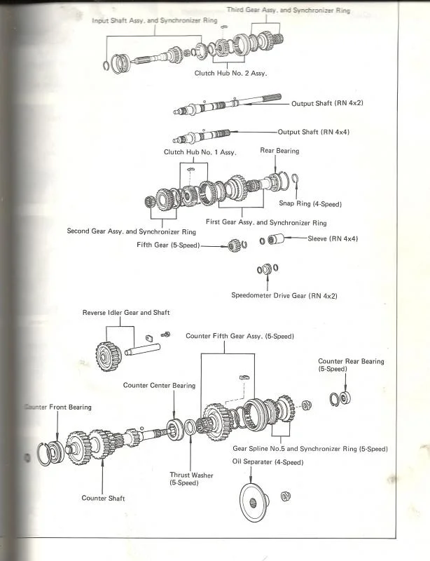

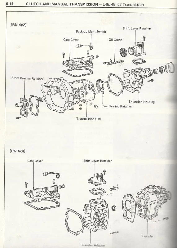

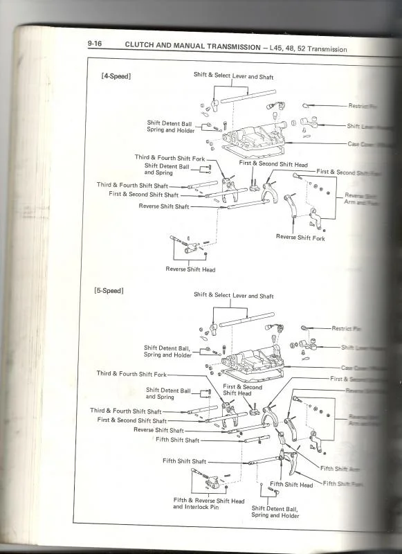

here are the pages from the fsm for the L52

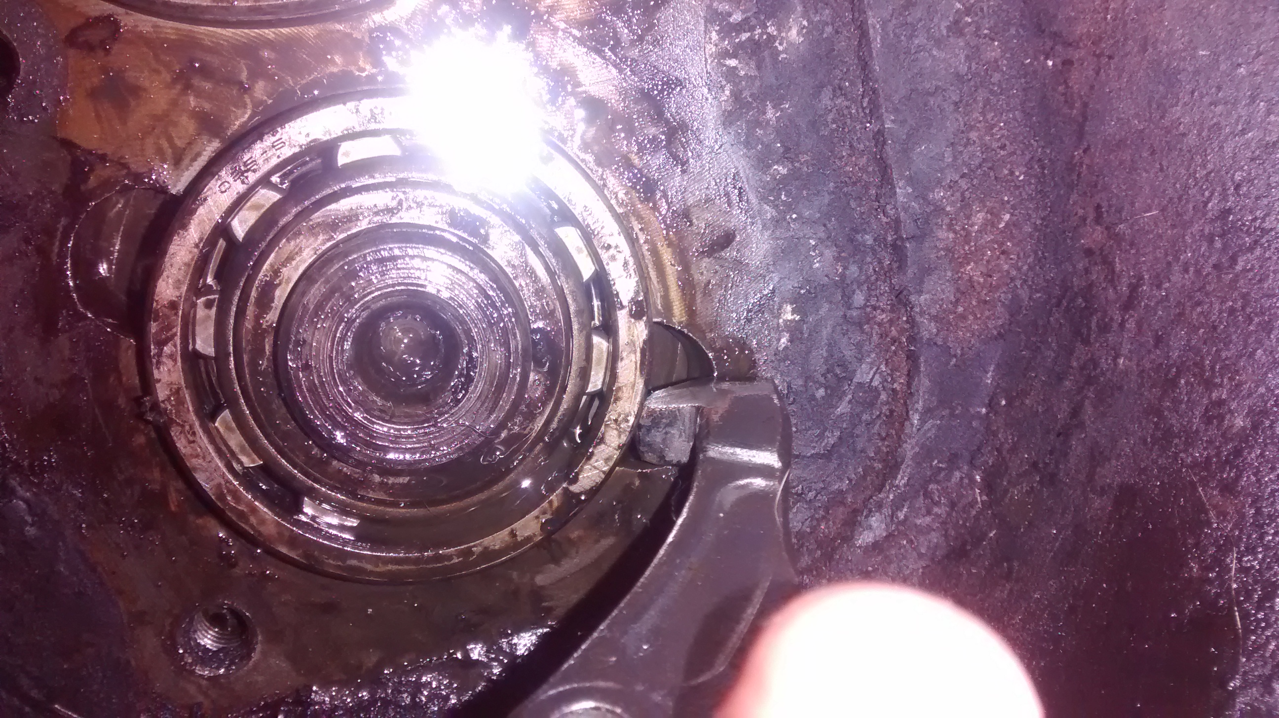

bringing this thread back up, I'm tearing down an l45 to grab the front input shaft to fix my l52, I want to know what tools and methods you used to remove the front and rear input, output and counter shaft bearings, I'm having a really hard time, They need to be removed to pull the shafts out of the transmission.
Old Dec 12, 2015 | 05:57 PM
gillesdetrail's Avatar
Joined: Jan 2013
Posts: 803
From: Montreal, qc
