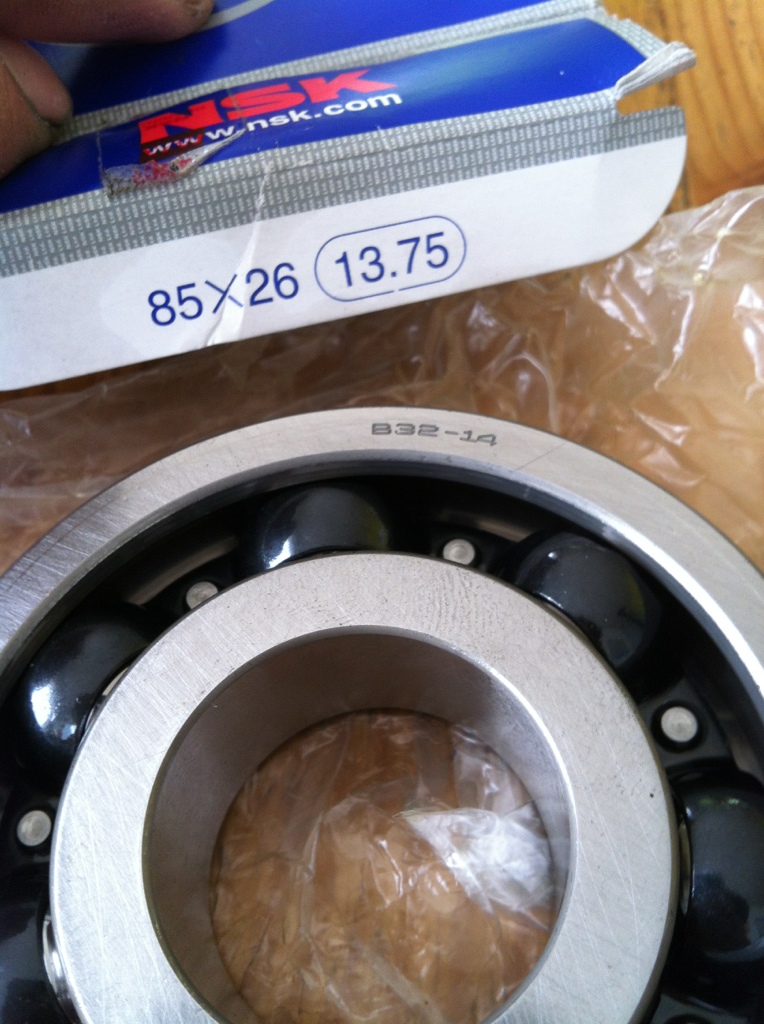

SC toy, can you measure your input bearing for us with a pair of good old Harbor freight digital calipers? I am interested in the inside and outside diameter of that ball bearing. Thanks.

Sorry i don't have a caliper, its at the shop. If you google
B32-14 it should give you the specs. This for the L52. L50 is smaller and the bearing id stamp is listed on marlin's website.

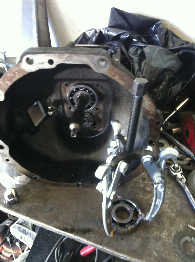

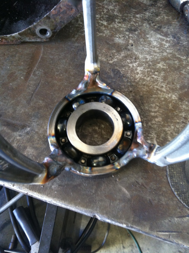

Got it out, took more weld then i expected. Used a 302 stainless rod, tore the metal out of the bearing twice, but then i added a good chuck of weld and out it came. Thankfully castiron is a poor conductor of heat as well as the bearing being isolated by the balls. The shaft didn't even get warm. Really no way to talk about it without sounding dirty haha

Well its a pain to get that bearing out, seems like you pretty much have to customize your tooling to grab that snap ring lip. I bent a 2 jaw puller, 3 jaw just can't get a good grip on it because of the orientation of all the cast iron surfaces and counter shaft bearing below it. If you know a TIG welder, that's how I did it, but I killed my gear puller in the process. Otherwise you get to pull the internals apart, which didn't look appealing to me. Hope yours comes out easier than mine.
