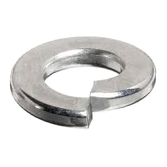

You might want to recheck the new hold-down bolt you put in, to make sure it is the right size, length, etc. According to what I can find, it should be a metric M8 - 1.25 X 30mm. If it is right sized, especially the length, and as long as the threads it goes into aren't stripped, you might consider putting on a split or wave washer of the right size. This will "tension up" the bolt at the head, making it less likely to back out and loosen up on you. Do NOT use threadlocker (LocTite)!
You can go to any hardware store, take your bolt out & have them match up a washer for you; should cost pennies & take minutes.
Just in case, here are pics of the washer types:
Split Washer:
Wave Washer:
Worse comes to worse, there is also this:
