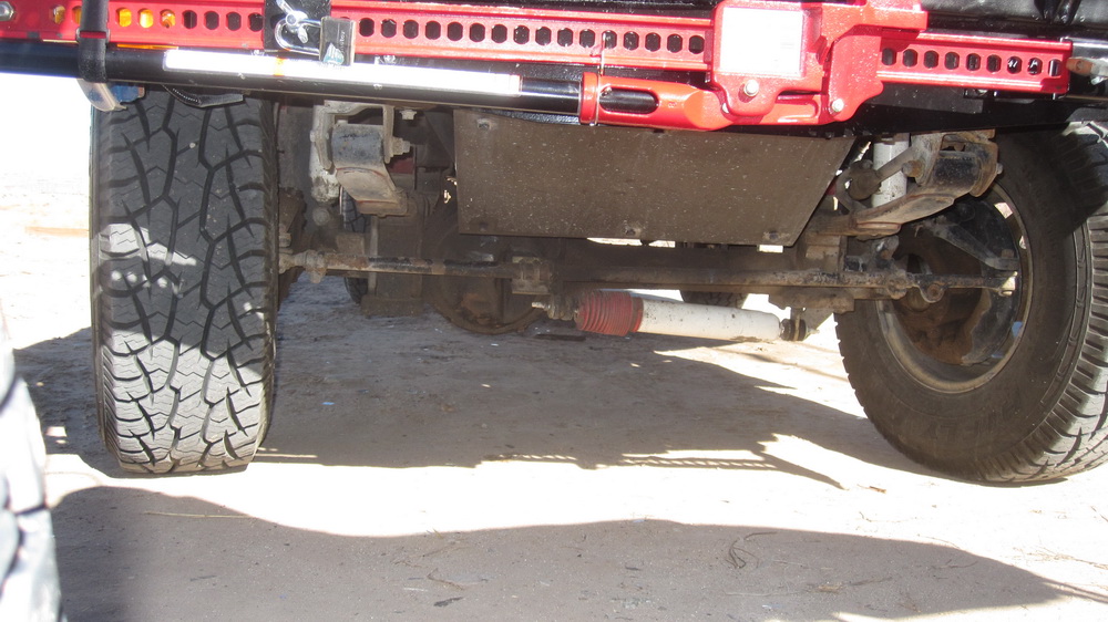

This is the first truck that I've owned that was lifted. If I am driving at highway speeds and must turn sharply to avoid something and turn back its...kinda scary. It's overcompensation when returning to driving straight. Realizing it acts like this I am extra careful in these situations. I don't know if this is normal with a lifted truck, but I doubt it. So I would like to know what can be done to eliminate this and make it handle better in situations like this. When I first noticed it when I bought the truck, I brought it to a mechanic that suggested I add two more shocks to the front end. You can see one of them only because the mount for the other one broke and I removed that shock. However, after that modification was done, i noticed little if any difference. Any suggestions anyone?

I'm not seeing the swaybar links or the torque rod in the picture above (hard to tell with that skid plate in the way) so if it was removed at some point then that could be part of your sway problem, but I never had one on mine and it never bothered me. For what what you've say so far, it doesn't sound like a sway issue as much as it is what I call "steer delay." It can be caused my anything loose in the steering which basically delays your steering action and makes it feel like you have to turn the wheel farther than necessary often resulting in over compensation when you suddenly swerve. Have somebody stand outside of your truck while you turn the wheel while you are parked. Have him tell you when the wheels starts turning as you slowly turn - it should be instantly. If not, it is something in your steering
