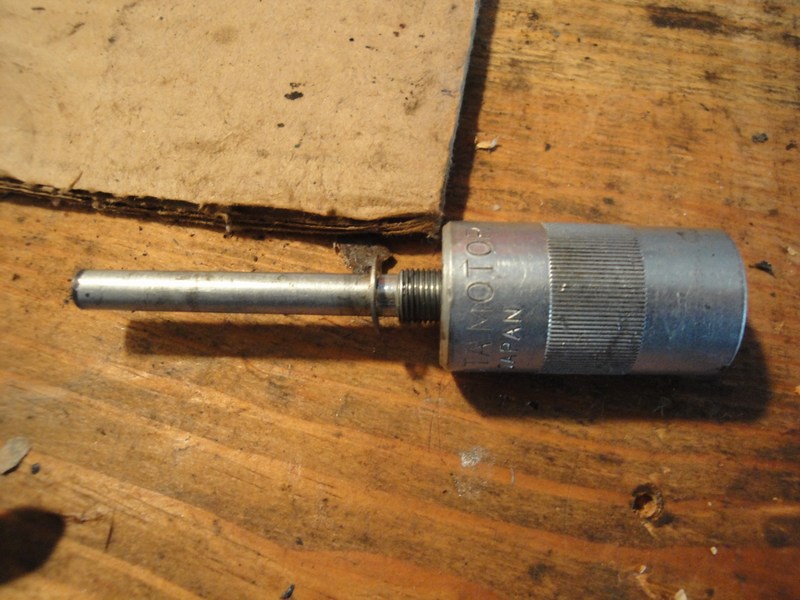

I need to grease the zerks on my u-joints. when I try the attachment Toyota gave me with the truck it does not work. Check ball is good in zerk it opens and closes as it should. but whenever I try to put grease in my U-joint it does not go in the joint, it goes all over the joint. A normal grease gun fitting is too big.

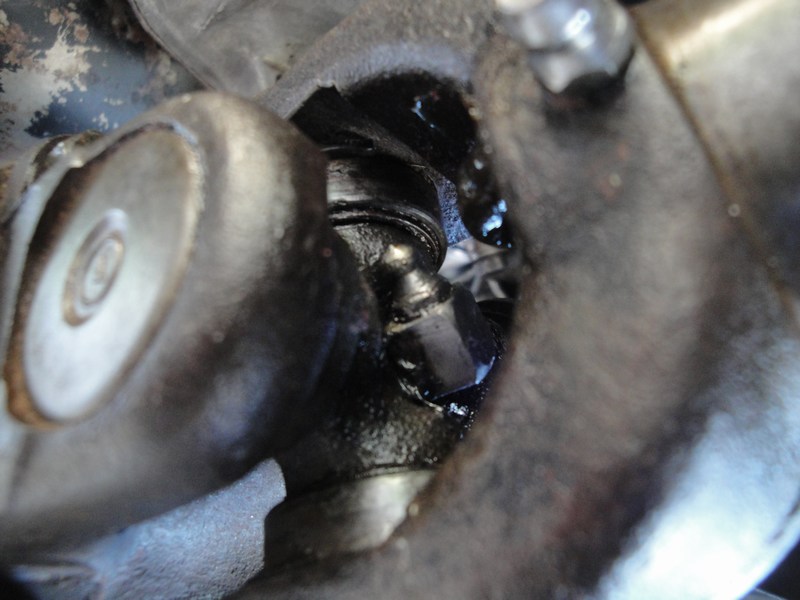

mine are in the center of the u joint the grease gun tip isn't narrow enough to fit in between ujoint body and snap on the fitting.
instead of the zerk being @ 45degrees its at zero with body of ujoint
center of u-joint has square block and zerk is screwed into side of this. I believe it is a 6mm fitting instead of 8mm or whatever the standard equivalent is.
this is a KOYO Joint

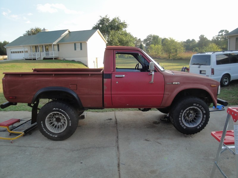

picture of zerk, truck ,and factory attachment

I've seen some like that where you had to rotate the u-joint to get it in an angle that gave enough room for the grease gun tip. Turn it where it opens up.
Now I wonder what my u-joints are, as the zerks on mine are in the ends of the u-joints, very easy to reach. All three of them on the front shaft are like that.

the 2 big ones have the fitting in the end of the cap. I had the drive shaft out and tried every possible angle, but still cound not get it to seat properly. If that block is threaded I was thinking I could back it out just a bit and have a better shot @ it.

I had a little trouble the first time I tried to lube the spider, grease everywhere but where I wanted it.
So I made sure the check ball was free and then with a solid barrel on the grease gun, I squared the tip of the toyota tool over the end of the zerk and applied enough pressure to the tip to force the grease into the zerk rather than squishing out between the tip and the zerk. Just get the tip as square as you can over the hole in the zerk and push while you pull the trigger.

I haven't had a chance to fool with it in a while. I checked the check balls and they function as they should. I will try your suggestion. I was sorta thinking same thing, but to use air powered grease gun. that way I could hold everything tight and shoot with ease. I'll let you know, thank you for the suggestion.
